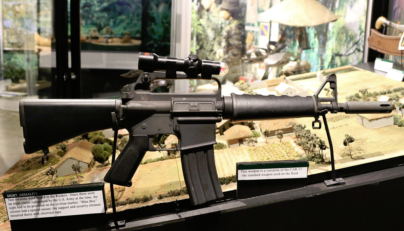

Best equipment part of the Son Tay pic is the Singlepoint OEG site IMO.
How 'bout this apparent Son Tay CAR-15/XM177-ish? Funnily, my own XM177-inspired rifle is almost identical except for the longer barrel and the fixed pre-A1 stock instead of the slider, and the lack of a vintage red-dot. I'd like one, though.
That’s a Colt 607 Commando, predecessor to the XM177, XM177E2, GAU-5/A, and GAU-5A/A.
Most of the 607s you see nowadays are Retro builds and not the real deal. Here’s an old photo from a Small Arms Review article on Colt M16 models:

Son Tay Raiders used GAU-5A/As and M16A1s. There has never been a Son Tay Raid photo showing anyone with 607s that I’m aware of. Colt used both 602 and 603 uppers on the 607 Commando:
