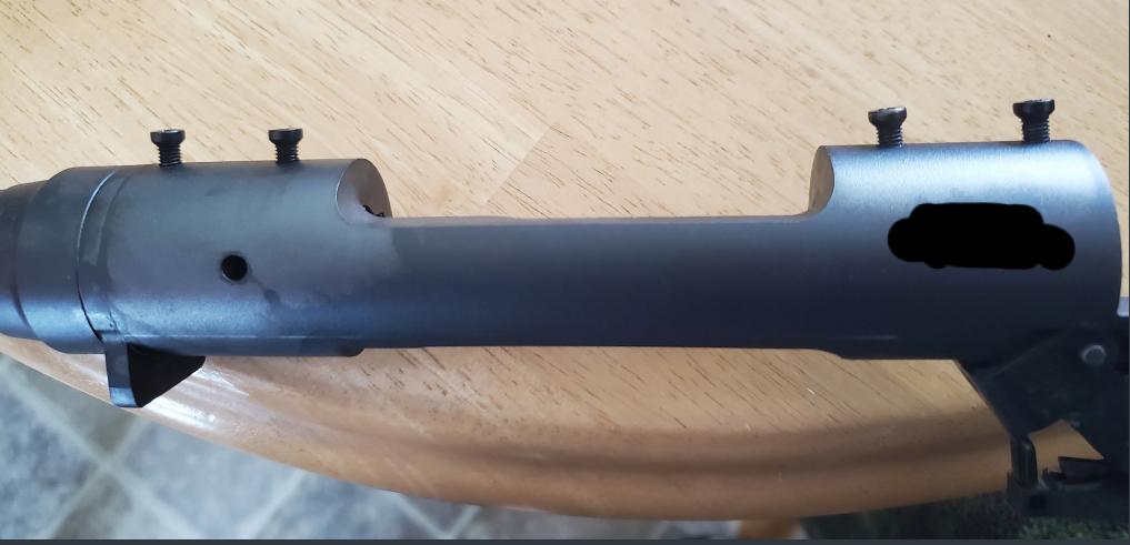

see, i've heard of using JB weld. Have you personally used it to do so. Thinking of pinning and bedding the Murphy precision rail to my action when i get it. Might even drill, chamfer, and tap for 4 extra bolts being as its a closed top reciever. Thing is i do not plan to ever remove the rail once installed. Plan on leaving enough clearance on the receiver to rebarrel without removal of the rail. So ive been looking in to ways to pretty much permanently attach a steel rail for absolute "zero" retention. Just one less thing to ever worry about. Like you can see in this photo. To get proper eye relief there is not going to be a need for that much rail near the barrel nut. Never had one come loose, just dont ever want to deal with that issue.
Before anyone says it, i know i should have went with something other than savage. Next build will have a custom action with the rail as part of the action. Live and learn, but i want the most out of this rifle. It will be the only savage i ever put this much effort into.
rail in the photo is still the oem one. The murphy precision rail lays on the receiver the entire length. no gap.
see, i've heard of using JB weld. Have you personally used it to do so. Thinking of pinning and bedding the Murphy precision rail to my action when i get it. Might even drill, chamfer, and tap for 4 extra bolts being as its a closed top reciever. Thing is i do not plan to ever remove the rail once installed. Plan on leaving enough clearance on the receiver to rebarrel without removal of the rail. So ive been looking in to ways to pretty much permanently attach a steel rail for absolute zero retention. Just one less thing to ever worry about. Like you can see in this photo. To get proper eye relief there is not going to be a need for that much rail near the barrel nut. Never had one come loose, just dont ever want to deal with that issue.
Yes I have. 30 Moa Farrell rail on a single shot target action. The two did not mate perfectly flat thus bedding was necessary. Worked perfectly, still does 10 yrs down the road. Shoots as tight at 1K as a designated bench gun, off bipod, till the wind gets up. Factory bbl looks so bad via bore scope that I suggest you never do that, just shoot the piss out of it.
I have too. There are a number of videos on it - search for something along the order of bedding rail jb weld shoe polish. Pretty straight forward to do, but you need to watch the time on the curing with a couple steps, so it's not like you can set it up and forget about it for a day.
