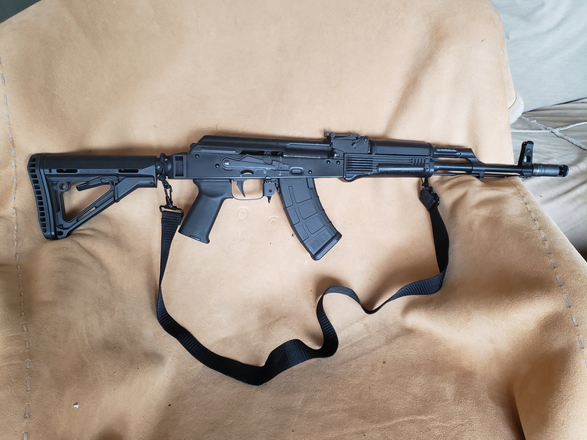

The Tapco AK74 muzzle brake on my AKM is loose, not sloppy loose enough to cause bullet strikes, but loose.
I've shaved it so it bottoms out at the exact point where the spring loaded locking pin on the barrel pops in it's notch but when I shoot it, it's loose again.
Does this inevitable harmonic vibration at the muzzle effect accuracy? If so, would Teflon tape be the answer? I don't want to J-B Weld it on in case I need to remove it and not sure it would hold up anyway. Would some type of crush washer cure it?

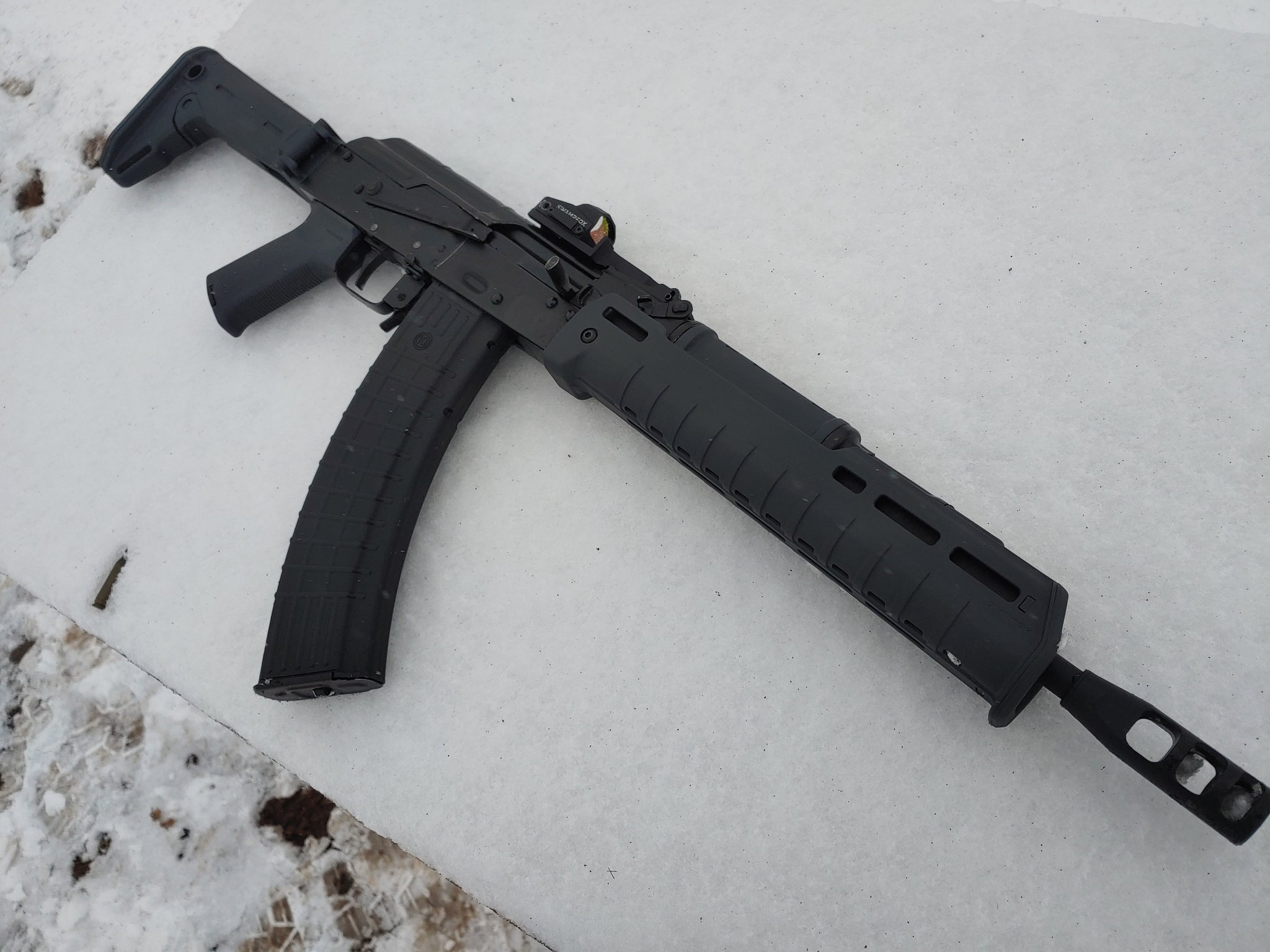

The AK74 brake that you have and I used to have sucks because it really only has one baffle, and it's quite a ways from the muzzle and after an expansion chamber so the gases have lost some steam by the time they get there. And mine had a fairly large bore that lets gas escape and cuts down on baffle surface.
I cut mine to 14" and pinned on a JP 3 port brake. Its not the best brake ever but it's got a lot more baffle surface and more importantly it's roomy enough to allow access to the muzzle and easy cleaning on the occasion I use corrosive ammo.
You can see in this video that it shoots flat enough to easily keep all three pairs on the three different targets and also regularly shoots .15 or better splits.
I cut mine to 14" and pinned on a JP 3 port brake. Its not the best brake ever but it's got a lot more baffle surface and more importantly it's roomy enough to allow access to the muzzle and easy cleaning on the occasion I use corrosive ammo.View attachment 7516004

Its the Attero Arms mount. It's pretty darn solid, I'm happy with it.
I ended up cutting and threading it myself using the Carolina Shooters Supply kits because my regular gunsmith isn't an AK guy and had no desire to start. That seems to be the case with anyone that's not heavily invested into AK work already. The threading went great though despite it making me feel like a bubba with a hacksaw ruining a gun.
