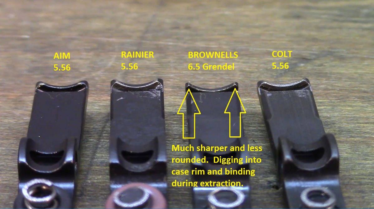

I will third the ejector check... sounds weak, broke or at the very least.. suspect.
Next while the bolt is out... check the claw of the extractor... both "ends" of the claw should allow the spent case to freely roll out of the claw... if the edges are to "pointy" those pointy edges might be holding on to the case rim.
From the internet...
!!!!!!!!!!!!!!!!!!!!!!!!!!!!!!!!!!__________________________________________SuWHaxU-912480.jpg
