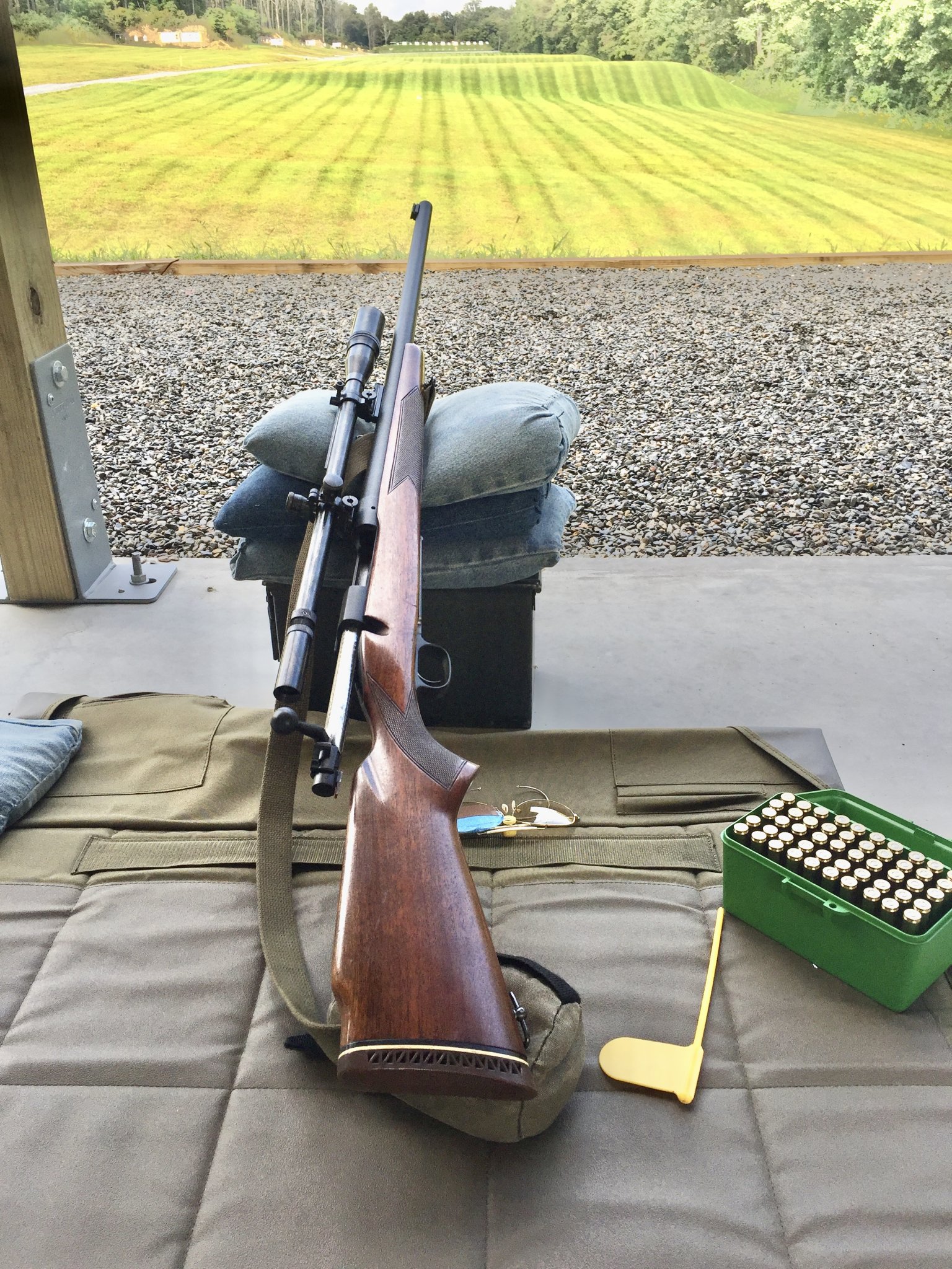

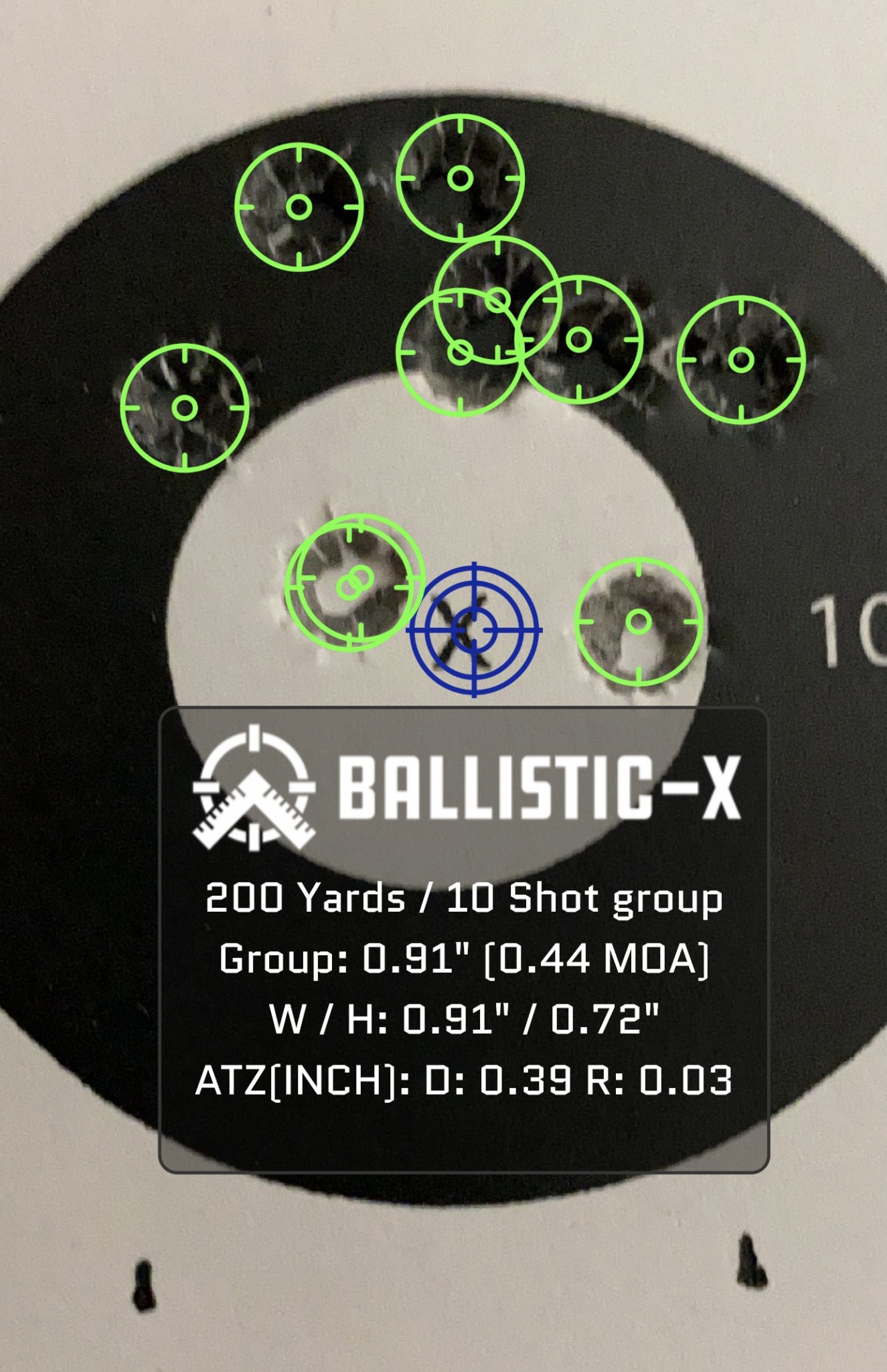

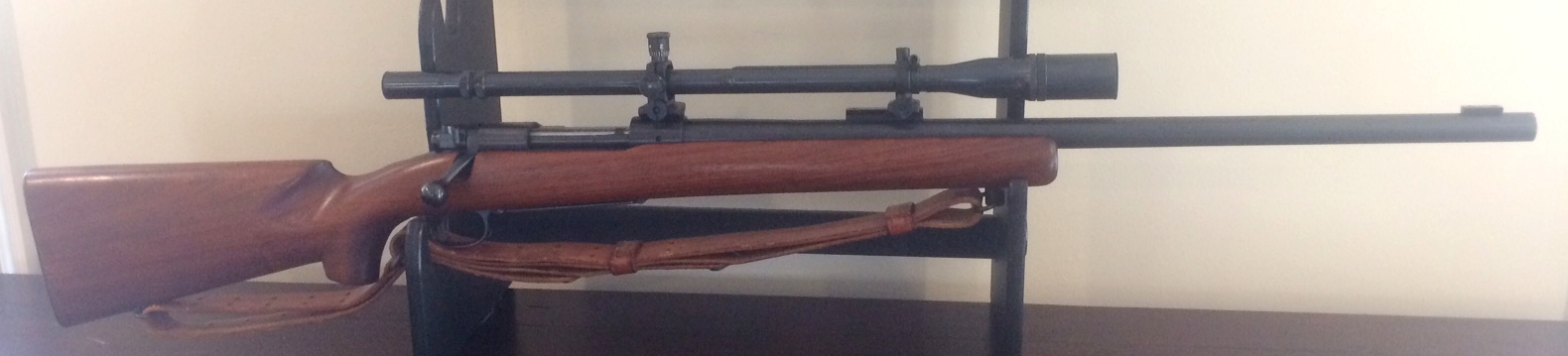

Ive got a .30-06 1943 M70 headed my way, built as a sniper repro with a Douglas medium-heavy barrel. I know a few of y’all have similar rifles and am looking for some reloading recipes

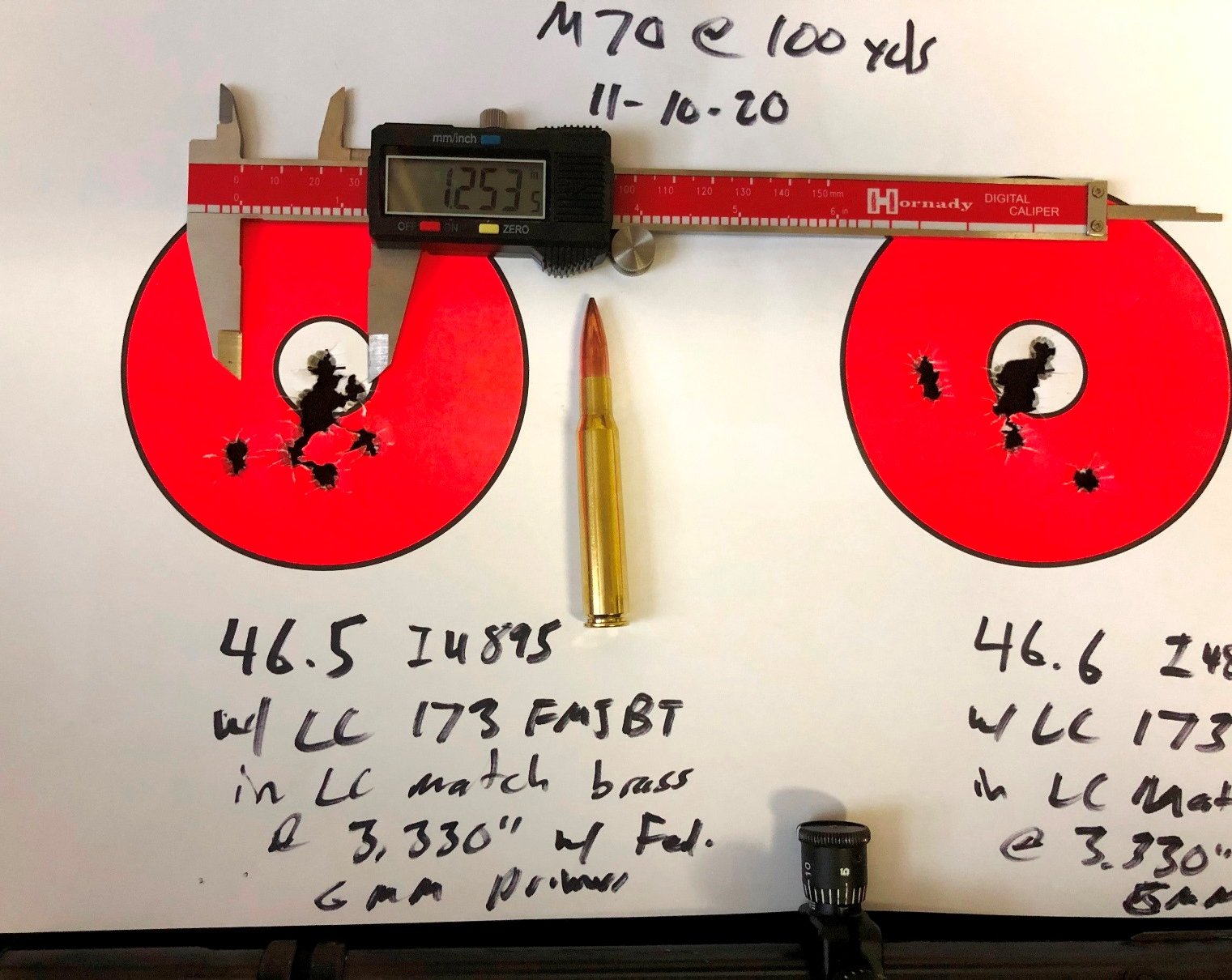

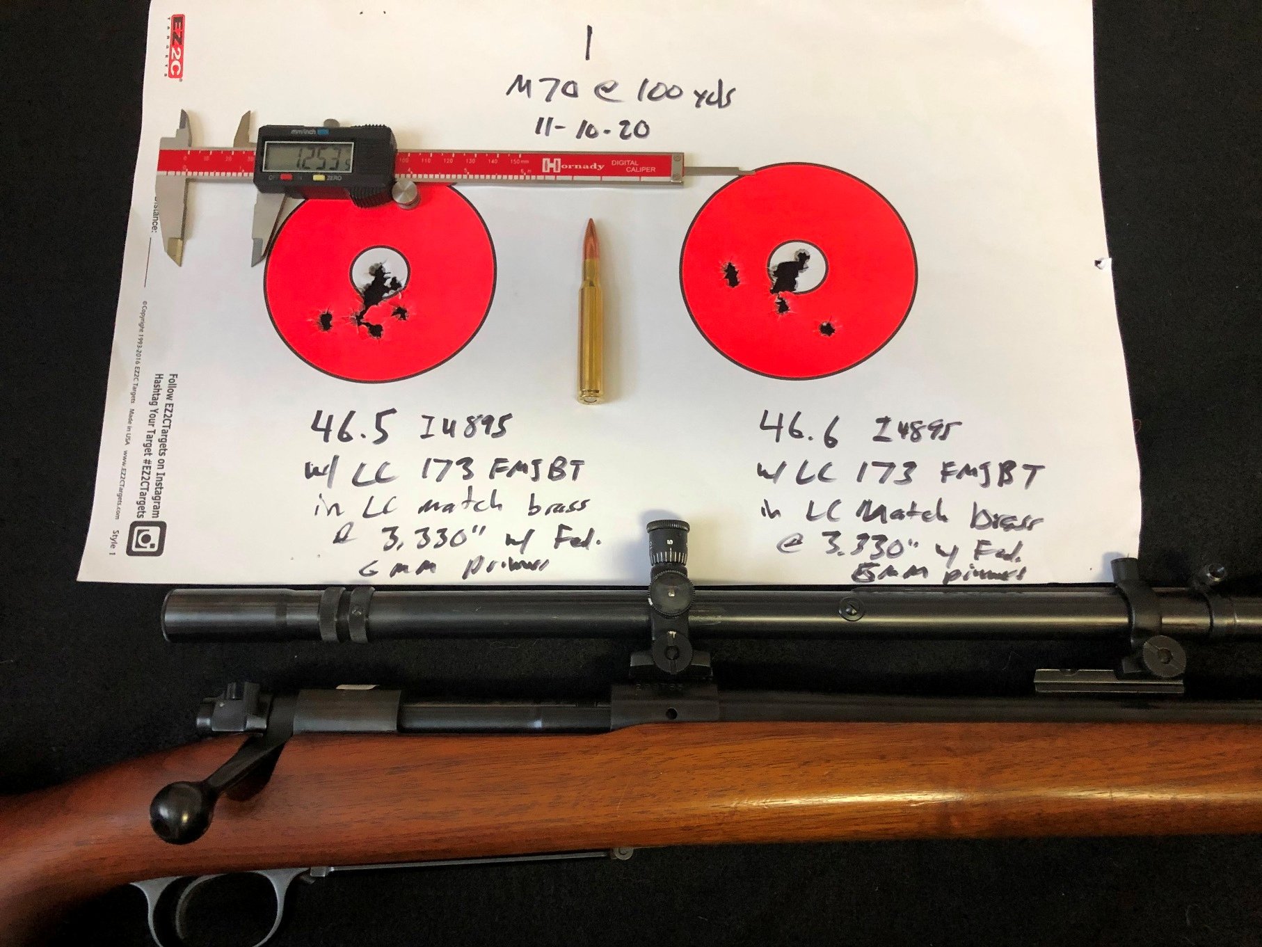

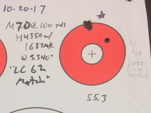

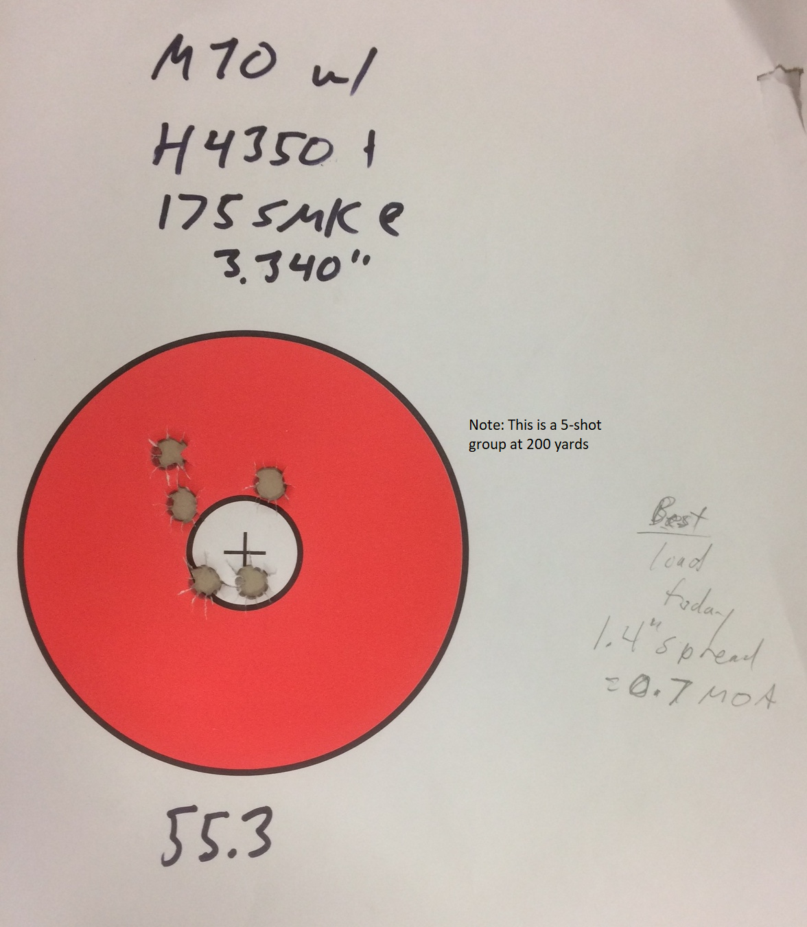

I have same set-up. Good loads with 175 SMK or 173gr LC FMJBT thus far include: 168 Sierra TMK or 175gr SMK bullet with 55.3gr of H4350 in LC Match brass with Fed GMM primer at 3.340". (That load is not suitable for an M1). Also recently tried some of the old LC 173gr FMJBT bullets with 46.5grs of I-4895 in LC match brass with Fed GMM primers at 3.330", which showed some promise during a recent trip where I tested 10-rd groups. My 2cts.

I have same set-up. Good loads with 175 SMK or 173gr LC FMJBT thus far include: 168 Sierra TMK or 175gr SMK bullet with 53.5gr of H4350 in LC Match brass with Fed GMM primer at 3.340". (That load is not suitable for an M1). Also recently tried some of the old LC 173gr FMJBT bullets with 46.5grs of I-4895 in LC match brass with Fed GMM primers at 3.330", which showed some promise during a recent trip where I tested 10-rd groups. My 2cts.

I had a typo re the 175 grain load, its 55.3 of H4350 (not 53.5, which is pretty light). As for a duplicate of M72 w/ 173/174 LC FMJBT, I think somewhere b/t 46.5 to 47.0 of I-4895 with a match primer in LC brass will get you to a sweet spot. (I'd try 46.5, 46.7 and 47.0 and see what your barrel likes).
