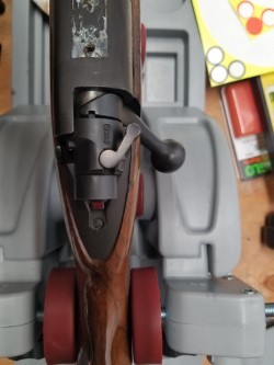

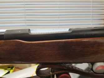

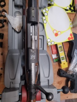

Again, before running any tool through anything, you also need to identify exactly what vintage the rifle is. A pre-'64 is a control round feed and the post-'63 is a push round feed. There is a difference in length and the height of the rear ring of the action. Is it round, flat or does it have a cut with little ribs running lengthwise of the action. Knowing that will determine what the correct bases are for it.
To see the difference in a control vs. push feed, you only need look at the bolt. A control feed has a blade alongside the bolt. A push feed has nothing on the side of the bolt. There is a small "sharkfin" button at the top left rear of the action. Depress that and work the bolt. It should come right out of the rifle. Then you can see the bolt by itself.

sandwarrior- It is push feed. Here are some pics. Let me know if you need more detailed ones.

Here is a good base for most anything you want to do:
Again clean it up first, get some blue (soft -red is hard) Loctite to hold screws in once torqued.

Picatinny is like weaver except they are spaced at given intervals. Even though these are Redfield, the patent is Weaver. There is no set spacing to them so either way you put the bases on (tall one on the rear reciever ring) you would have to change the scope ring spacing to move it to a picatinny. So, for the few extra bucks, I'd go the Picatinny.
