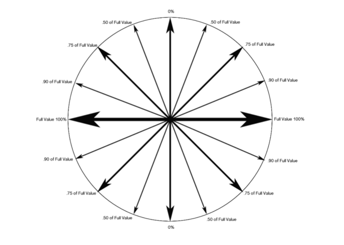

What value do you give the wind on the angles?
  • Half Value
    Votes: 13 12.3%
  • 3/4 Value
    Votes: 11 10.4%
  • More refined, like 3/4, 1/2, 1/4...
    Votes: 72 67.9%

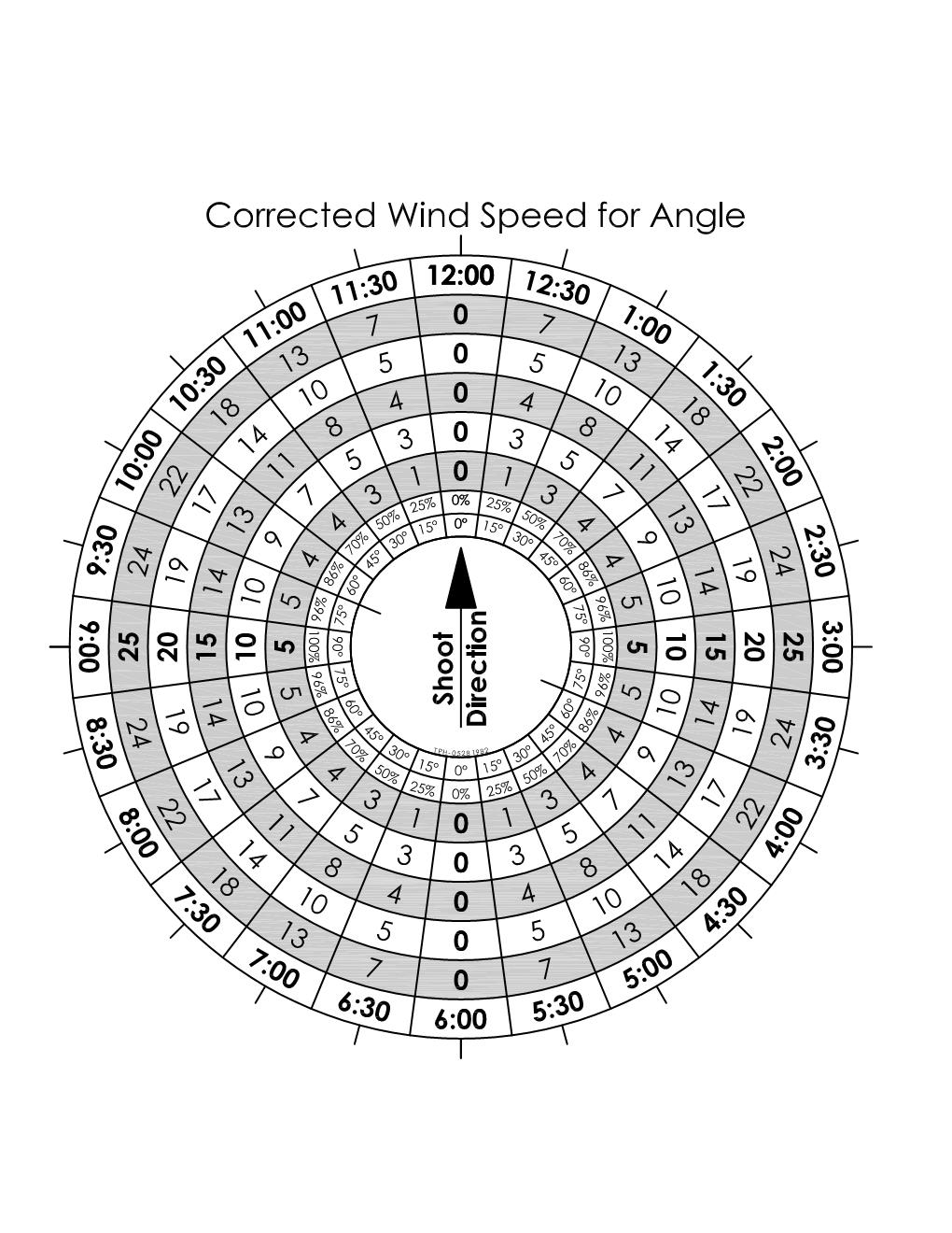

I'm trying to get better at calculating my wind holds
I've recently update my wind rose. See below. This wind rose turns my wind into the 90 degree true value wind for me. I've used this at a match and it worked really well. Couple this wind rose with the MPH gun method and you have a quick wind hold. Using this rose does require time and distance as it might be slower than head math, but its more accurate as well.
So can you explain to me how this works? I think I get it. I kinda like it but I want to be sure.

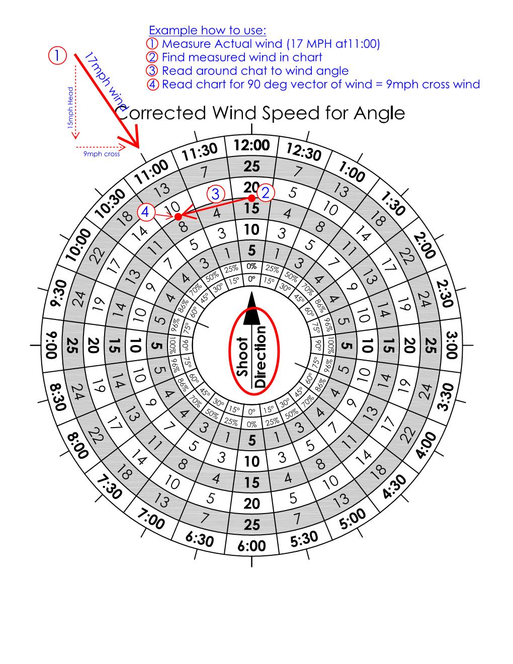

I used autoCAD to make this.
Reactions: Nygaard
This is a wind rose that completes the sin of the wind angle for you.
Example.
True wing is 15mph at 2 o'clock.
From chart- 90 degree full value wind is 13 mph.
Target at 600yds with 6mph gun.
Hold is 1.2 mils right. (.6 x 2)
So, for example, a 25mph wind from 1230 would be the equivalent to a 7mph full value wind, if I’m reading it correctly?
Not to criticize, but it looks as annotated, that winds from 12:00 and 6:00 are full value when they should be 0 mph.
We all know what you are going for, but those 2 columns don't fit the established pattern.
Yes. I agree. They are zero. The only reason I put the true wind speed there was to make the chart faster/easier to use. I could change them to zero I'd you'd like to see the difference.

Wind becomes less “effective” the farther you move from perpendicular.
I really appreciate people that put forth this kind of effort.
Don't change it on my suggestion unless you really think it would be a helpful clarification.
You have a typo. 60°, not 90° is 13 mph.
The intention was to say a 15 mph wind at 2 o'clock [60 deg] has a 90 deg wind correction [cross vector of wind angle] of 13 mph.
I think I said it correct above, we might just be reading it a bit different. As long as you've got the concept is the important part. Respectfuly, If you still think it's a typeo, show me how you would have written it. This is sometimes hard to convey and maybe it can help me going forward to describe this a way people easily understand. Thanks.
Edit. I've read it 2 more times. I can see how you may have thought it was a typeo. No worries.

Am I reading the rose wrong? 15mph appears between the 3rd and 4th speed ring, which would put the 90 equivalent around 17.5mph.
6mph at 600 being a .6 x 3 = 1.8 for the full value hold on a 13mph wind at 2pm. ?
Edited to add, not nit picking just checking my own understanding. Would be good to shrink this and print it as a waterproof sticker for the Kestrel impeller cover.
Yes. I think you are reading it wrong. 15mph is the actual speed of the wind, the speed from your wind meter if you have one. Then reading the number in the cart at the angle of the wind in the 15mph ring gives you the 90 degree vector of the wind (13 mph at 2 o'clock) which your wind hold is based on.
Note. At 12 o'clock and 6 o'clock the wind is actually zero but I put the 5, 10, 15 and 20 in those blocks to make the chart easier to read.
Guess that makes sense, the meter measures full value wind since you aim the back directly into it.
So if you start with that as full value, change the value with the rose based on the angle... that's what you base the hold on?
Think I'm tracking now. ?
You are correct, I made a mistake in reading it. Sorry if I confused anyone.

Can someone check the 25 mph outer ring
I think I read the thread.
Does it take a 25 at 3;00 (full
Value)
And that converts to a 33 mph at 2:00?
David Tubb has a theory that a 230 and 330 affect bullet flight more so than 3:00.
Not really relevant to this thread, but it’s an interesting theory.
So, I've update this wind rose again.
1 - Corrected the 25mph at 2, 4, 8 and 10 to 22mph
2 - 2nd file has zeros for the head and tail wind. I like it better with the actual wind speed in this area to read it faster. Let me know what you like best.
@brianf
@Skookum
  • Wind Rose - Corrected wind speed for Angle.pdf
  • Wind Rose Wind Rose - Zeros.pdf
