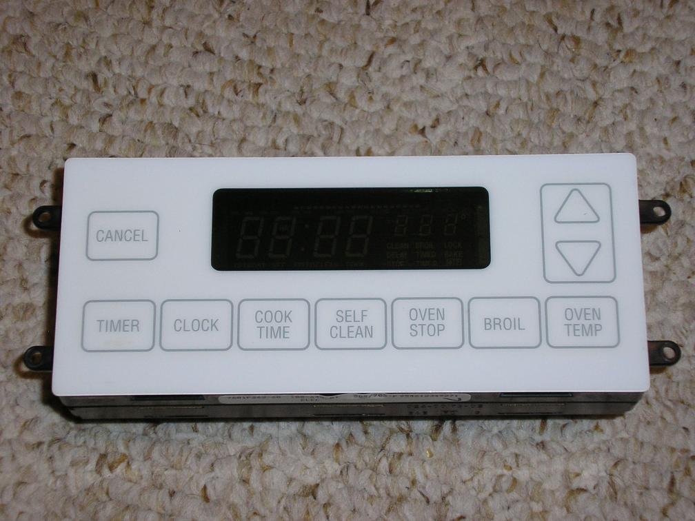

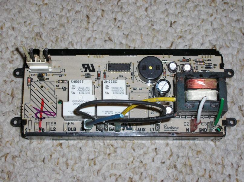

Am in the early process of building a larger paint curing oven using an old gun cabinet and came across the guts from an old electric range. I have the controller, 2 round burner elements, temp probe, power bar, and what appears to be a limit switch (looks like a button that sits inside the oven itself).
For the life of me I cannot figure out how to wire this thing. It's a bit embarassing since I've wired 4 complete shops from start to finish and countless other large projects dealing with 110 and 220 volt. This project, however, is kicking my butt.
Anyone have any ideas how they might wire this controller to burn 2 elements? I have no idea what is supposed to go where and there is no wiring diagram for the old stove. This is a 220 v system but damned if I know where the 2 lines would feed from the wiring bar into the control . . . or where power goes from there. Help?

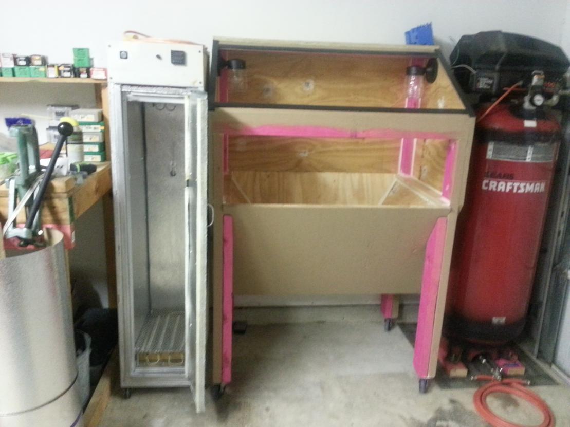

Agree with above. I switched to one of the PID designs a while back, got it from Ebay. With a few seals replaced on the oven, I can keep the temp within .5 degrees all day. Coupled with a good Solid State Relay and you should be set. I need to update my original oven thread on here to show the changes. It really did make a huge a difference in the oven's performance and my confidence in what temp the parts were cooking at. Plus it looks cooler than an old knob sitting on top.
