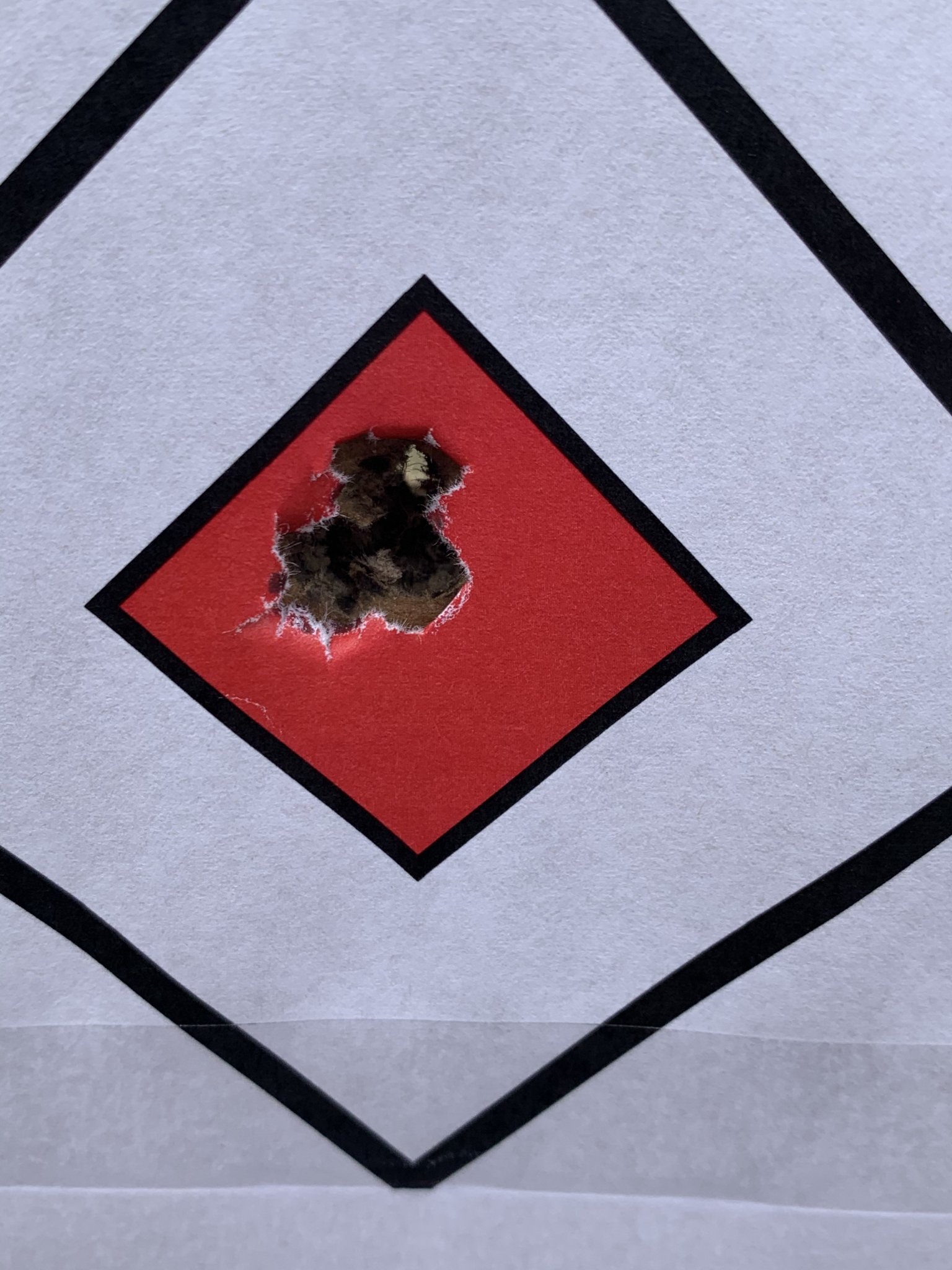

Got the rifle (TRG22 .308 20"), installed S&B P2 glass and have about 60 rounds down the barrel with a few .5moa groups at 300yds using Fed168 match and M118LR... The trigger is FANTASTIC!!!
Reactions: secm
