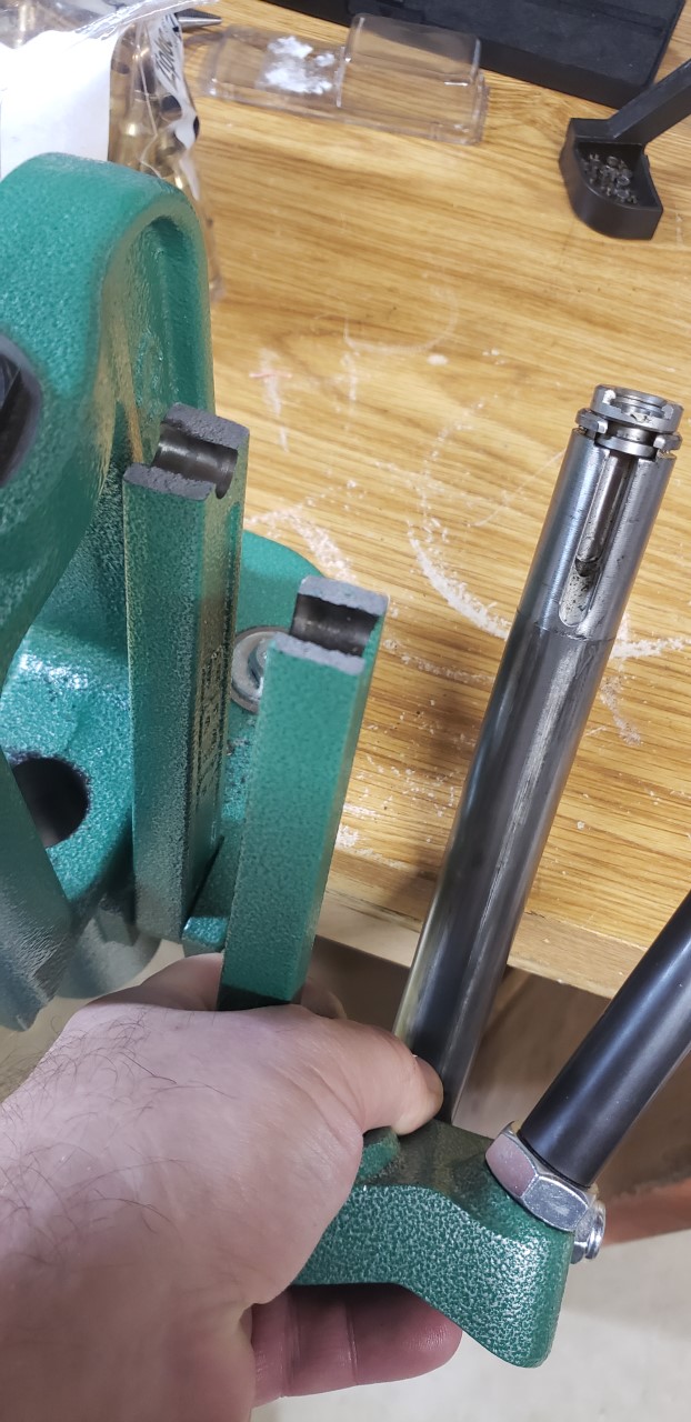

I was about to shoulder bump a bunch of 2F M118LR brass. I drop 1st case into holder. I start screwing down the Redding FL resizing die. I start to feel some tension finally in the lever so I give it about a quarter turn. I start to push the handle down expecting to measure some shoulder bump. At the bottom I cam it and BAMM!! Both arms on the chucker break at the bolt holes. Left arm at the top bolt hole and right arm at the bottom hole down by where the handle screws in.
This chucker is barely 6 mo. old. Case holder is fine, Redding die is fine, CASE is fine and ZERO shoulder bump took place. WTH just happened?

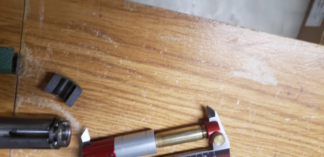

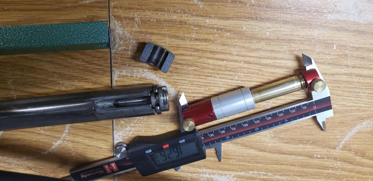

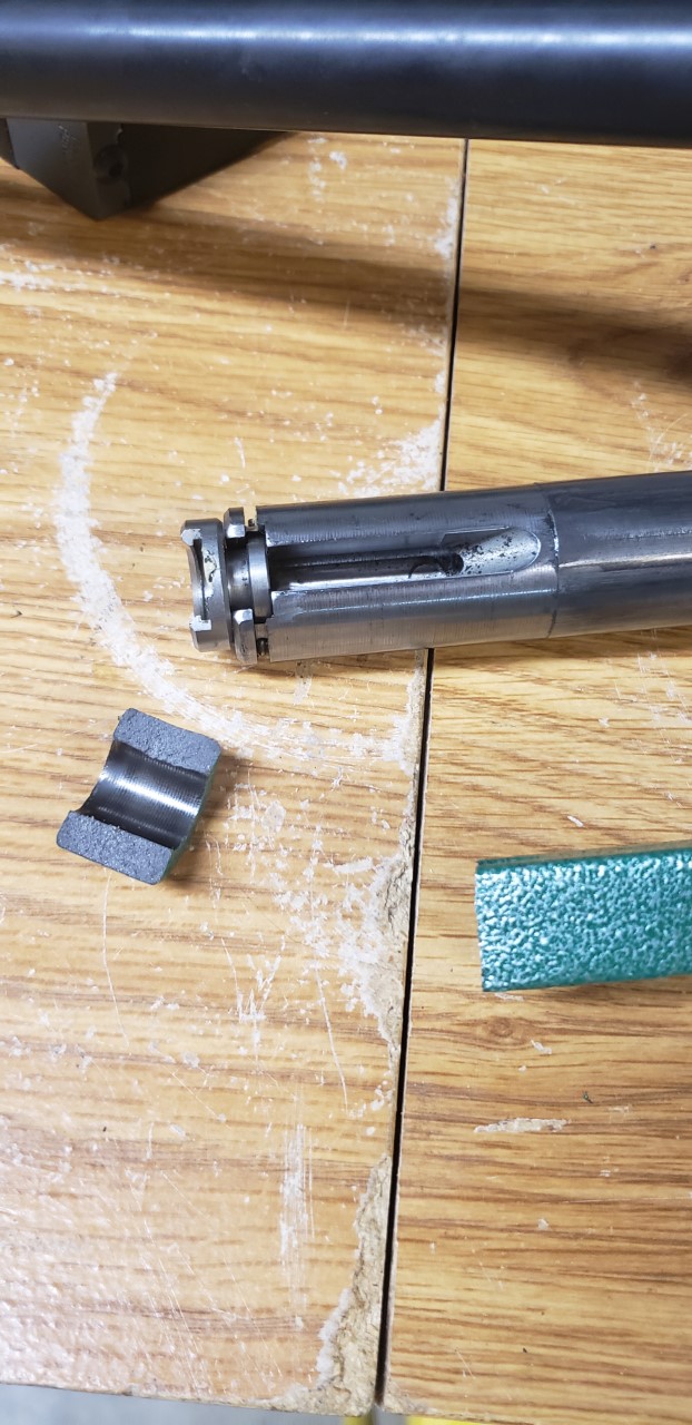

Gimme a sec., Pics inbound my friend. Last pick shows case length. That is the case that was in the chucker when it broke. Let me know if you need any other angles.

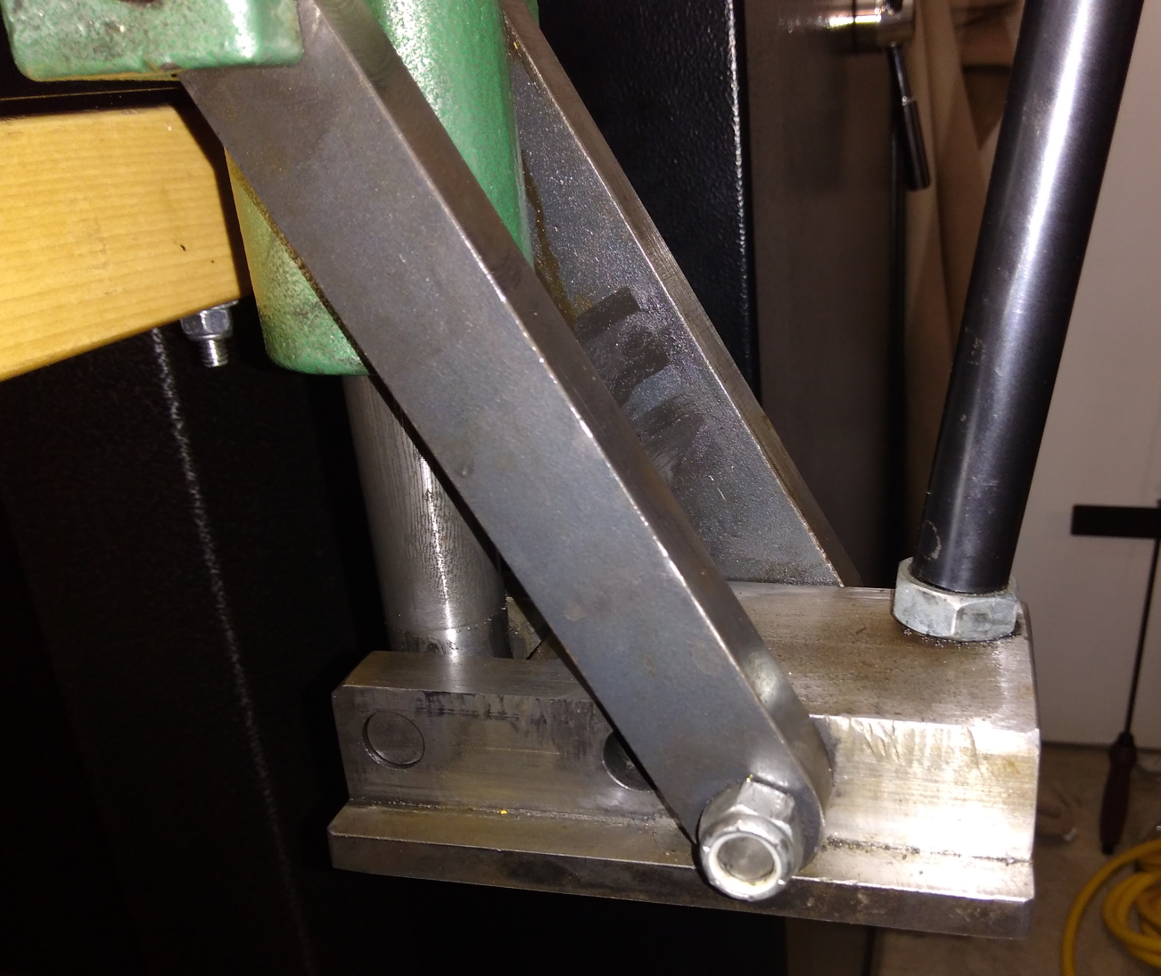

Years ago I did the the same...except I also broke the bottom plate. The BS in RCBS stands for Bullet Swage...and I was swaging some 40cal bullets using 9mm brass and a 124gr 9mm lead bullet with a BTSniper die....and broke it because the lead I was using was a little too hard. RCBS will send you a new one rather quickly...but I made my own for bullet swaging...it has two lower connecting points....one for reloading...another for swaging...depends on how much leverage I need and the length of the dies.
I repaired a friends Lee press in a very similar way. Nothing like some cold rolled flat milled to fit.
