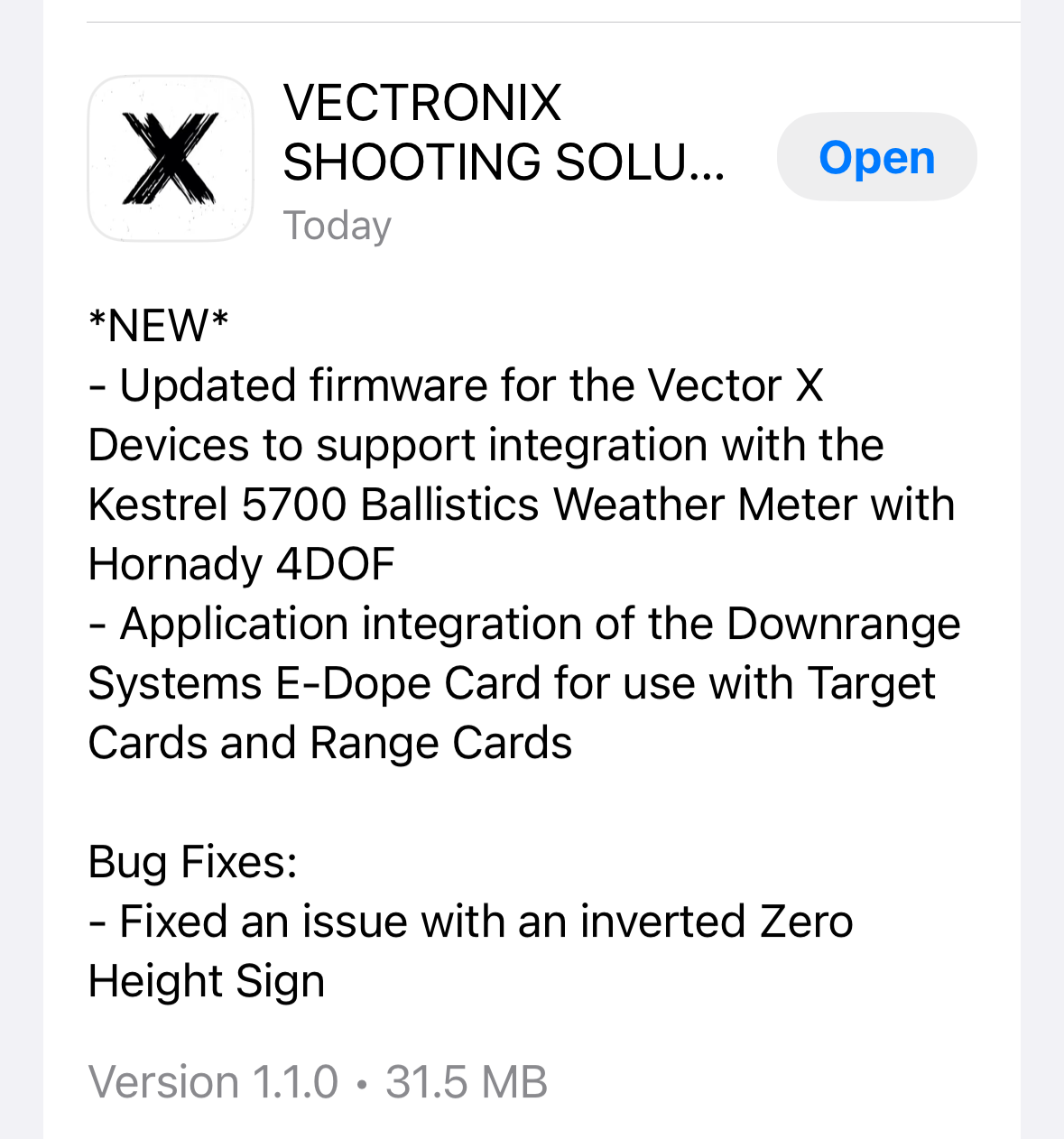

Can anyone speak to the difference using the Kestrel 5700 vs 5700 Elite when used in conjunction with the Vector X? Given the binoculars come with AB Elite licensing, is there any loss in functionality?
I have not been able to get my 5700 Ballistics to work with the Vector X. It will connect via bluetooth, but when ranging "Unusable Target Data Received" is displayed on the Kestrel.
A friend has the 5700 Elite and it works as expected with Vector X. The range is sent to Kestrel and the Kestrel displays a solution. The solution is also displayed in the Vector X HUD.
I figured out what why I got the "Unusable Target Data Received" message on the Kestrel 5700 Ballistics, you have to range something that is at least 30 yards away.
When a Kestrel is connected, the ballistics solution is calculated by the Kestrel for the selected gun profile and sent to the Vector X. The Kestrel gun profile and solution is used, not the gun profile that you may have selected in the Vector X prior to pairing.
I had hoped that I could set the Kestrel to "Weather" mode and use the Kestrel for environmental data and stream the wind speed/direction, while using the AB software/solution from the Vector X. But even in Weather mode the Kestrel ballistics and selected gun profile is used by the Vector X.
It appears that if you connect to a Kestrel 5700 you won't be able to use the AB Elite features built into the Vector X. This is because when a Kestrel is connected, the Vector X uses the Kestrel for the ballistic solution, not the built in solver.

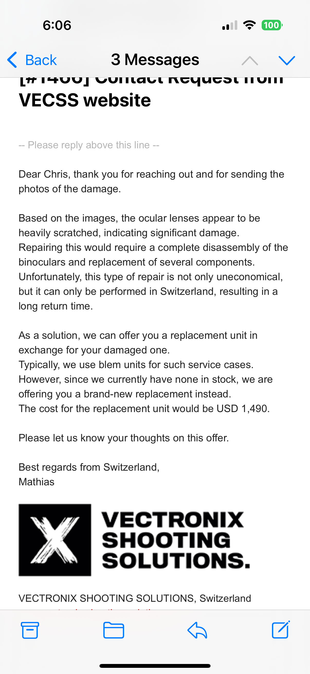

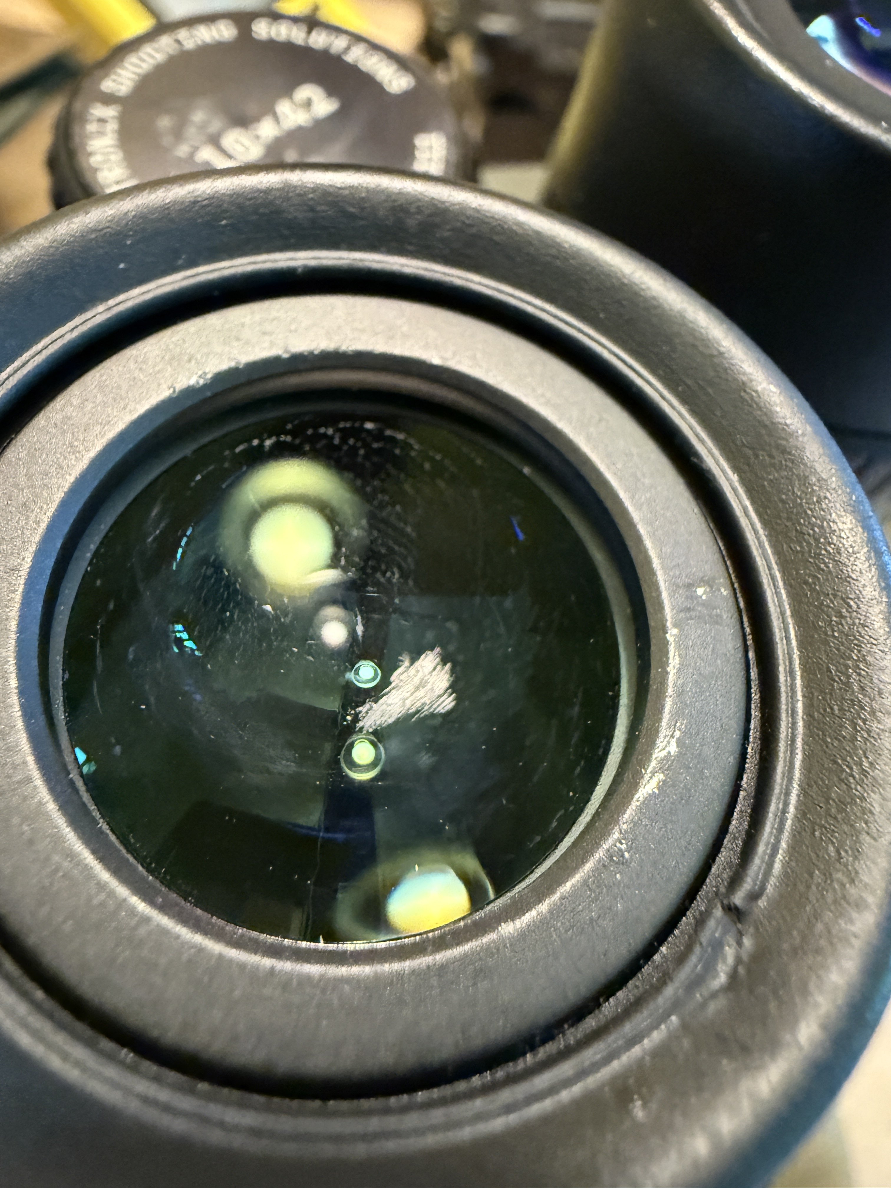

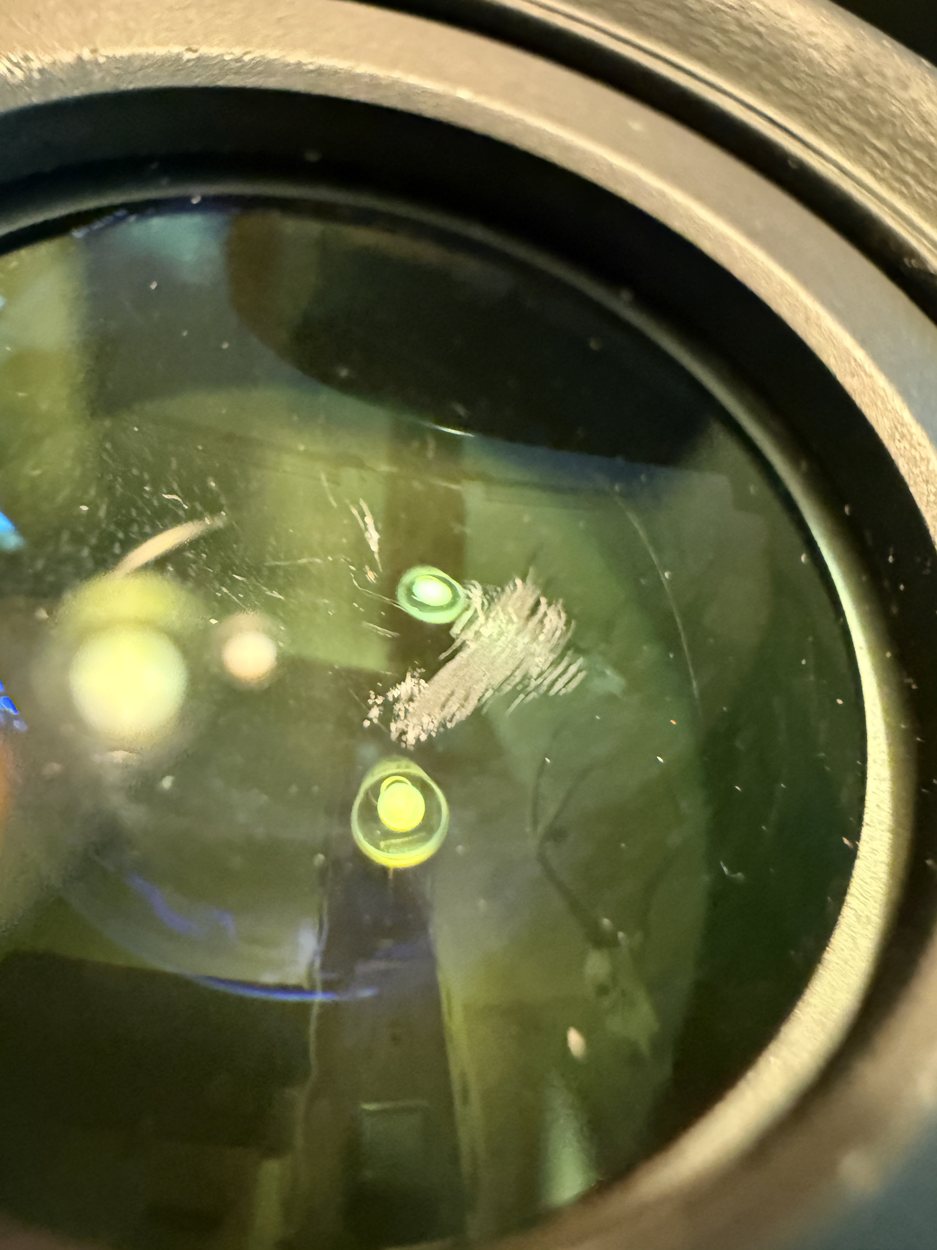

Who has experience with vectronix customer service for repairs? At a match this weekend, the wind blew over my tripod and landed right on the left ocular leaving a big scratch/scuff. They are useable but i think i’d like to have them repaired. Just curious what the turn around time would be and potential the cost.
