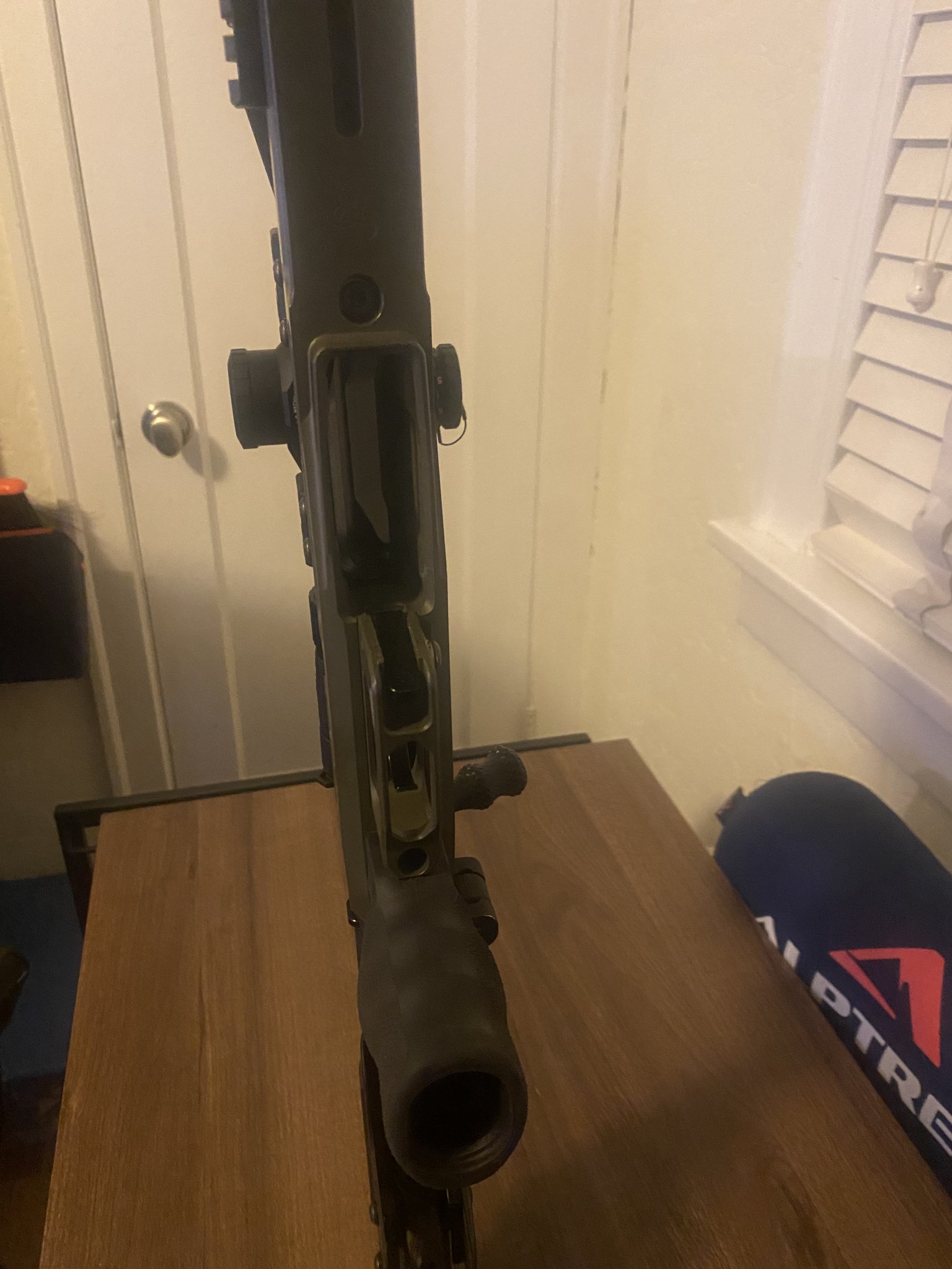

Hi all...I recently assembled a rifle with these parts 1) XLR chassis 2) TL3 action 3) PVA barrell.
The rifle shoots a quarter MOA. The chassis was bolted on to the action with two screws (one in handgrip and second underneath the action). This is the second time, after a match that I have noticed one of the nuts become loose.
What is the solution for this issue? Should I use some thread locker compound or explore bedding the action or just keep tightening after every match or something else...
Will appreciate advice from experienced folks.

65 inch pounds. It’s possible/likely you aren’t torquing them appropriately. Definitely get/borrow a torque wrench and try that before you use loc-tite. Usually proper torque is a better bet than glue. If that fails, a bit of blue loctite won’t hurt or you could reach out to XLR and see what they say. They have great customer support.
@XLR
@XLR
This ^
My response was assuming you torqued to recommended setting and it won’t hold. Properly torque and try that first
