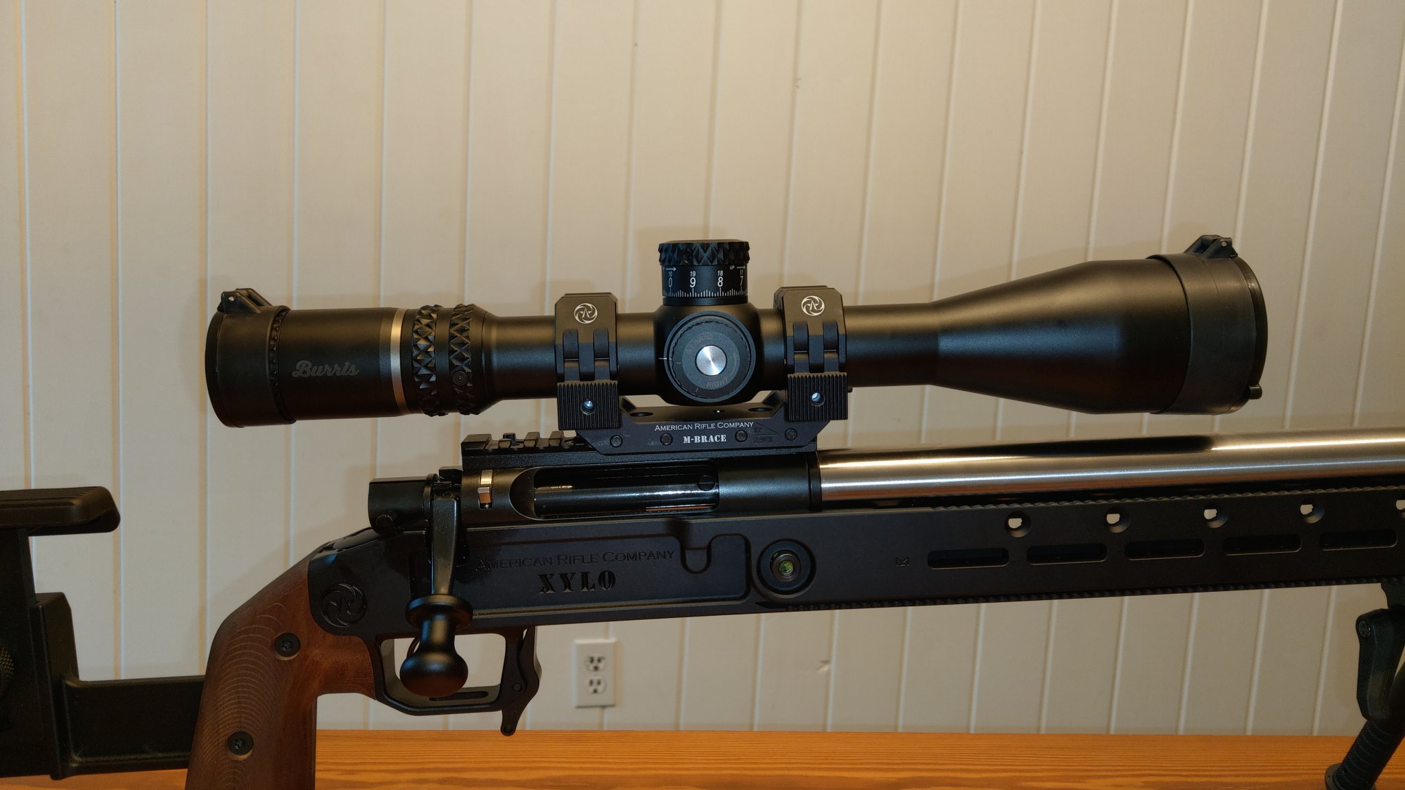

XTR III Illuminated in my hands

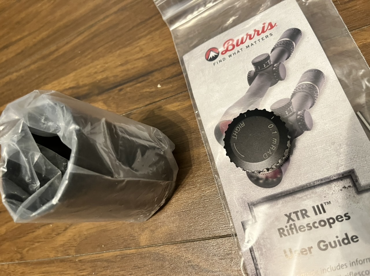

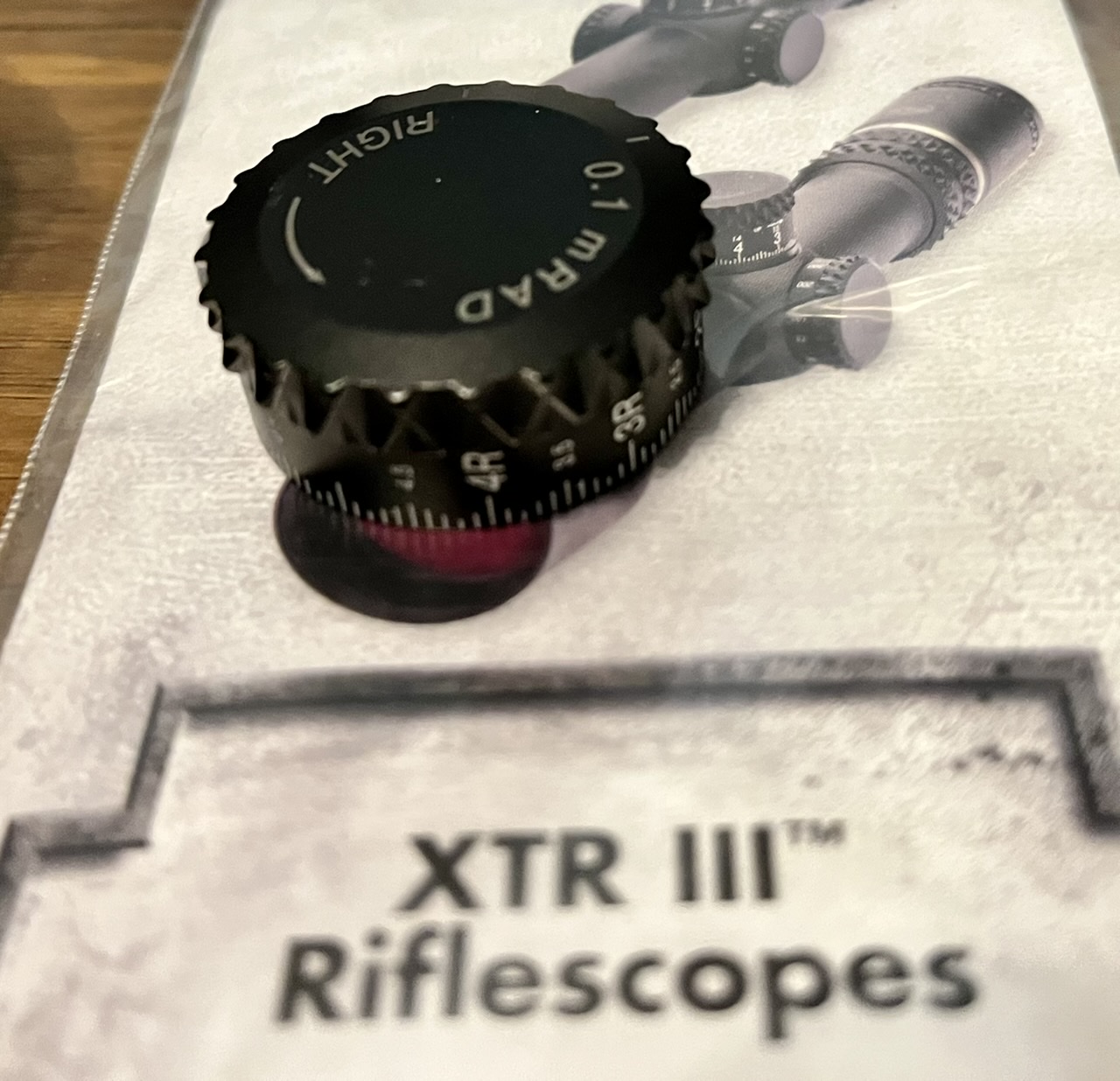

Not sure if this has come up before but the throw lever I ordered back in February when I backordered my XTR3i didn’t fit. I had contacted Burris and they quickly put a new one in the mail to me. As you can see from the pics below, the tabs wouldn’t fit between the knurling on the magnification ring. The new one Burris sent out has had the tabs machined off. Fits nicely, even though it moves very easily without it.
Curious, did they just send you a new one or did you return your original for proper milling?
Very happy to report my quest for the external windage turret has been successful thanks to the generosity of another member.... RFutch was kind enough to send me his turret and my XTR 3i is now suiting my years of training with external knobs. I'm still working with the holds in the SCR2 and they are growing on me but old habits are hard to break! Thanks to The Hide for the platform and a special call out to RFutch!

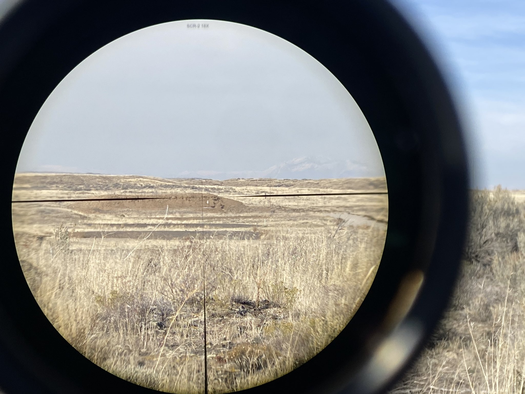

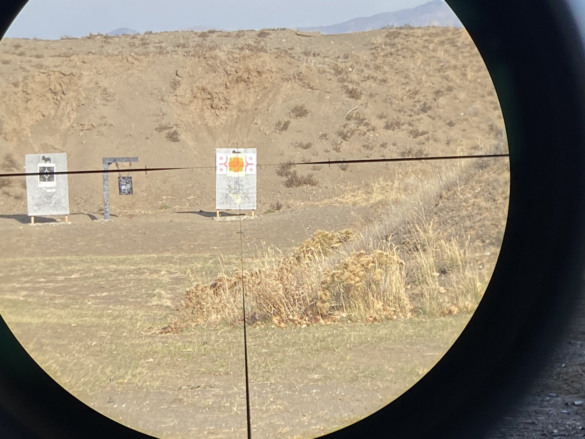

This is my very first XTRIII 5.5-30 that I got 3 years ago, and my XTRIII illuminated 5.5-30 that I got in April.
Non-illuminated at 5.5x
Illuminated at 5.5x
Non-illuminated at 16x
Illuminated at 16x
Non-illuminated at 30x
Illuminated at 30x
My apologies for the crappy cell phone pics, it's all I have. With the naked eye the difference is pretty obvious, and these reticles are far more defined. At 5.5x the reticle in the Illuminated model is perfectly usable. Ideally it's more around 8x for the non-illuminated.

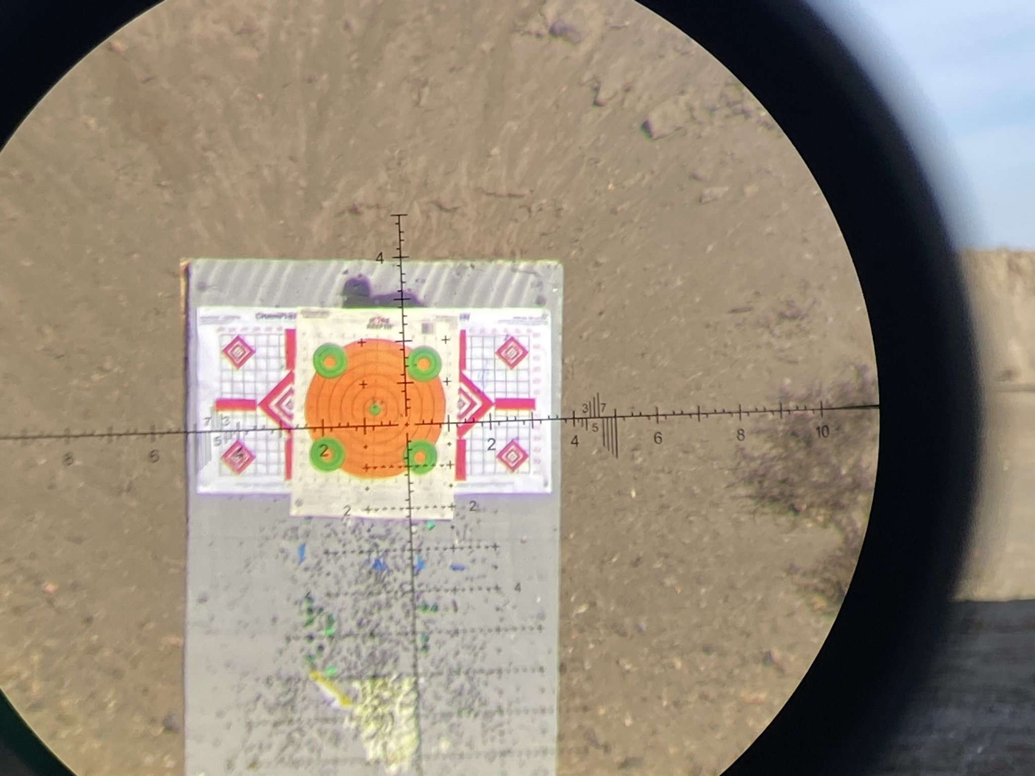

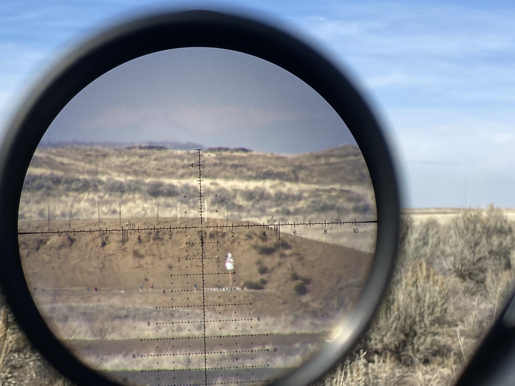

I finally got my XTR3i 3.3-18 this weekend. Initial lead time was end of July and that got pushed several times until it just showed up at my door yesterday. Mounted it onto my 6.5 creed PRS rifle and took it out to the range. Illumination is definitely only good for dimly lit conditions. I had to cover my objective to confirm it was on when I had it on 11 looking at stuff in broad daylight. To my eyes, the reticle would still be useable on 3.3 power. I compared the FOV to my SWFA 3-15 just looking at the fence about 25 yards away in my backyard and I could fit 2 more fence slats in the FOV at 3.3x vs the 3x on the SWFA. I took the Burris out to 1000 yards today and tracking seemed to be true as it lined up exactly with my data. I was able to see trace most of the way to the target and impact location (grey dot) on steel at 700 yards. At 1000 yards I could only tell where I hit based on the targets reaction. I did accidentally have the Kestrel set to my 300 win mag for my first couple shots at 1000 yards, so I missed quite low. I did not see the impacts in the berm for 2-3 shots. I feel like I can usually see misses like that with my Gen 2 razor at the same range. Although, the higher magnification of the razor probably helps with that. I am not the greatest judge of glass, but the XTR3 is certainly significantly better optically than my SWFA. I got the XTR3 to replace the SWFA on my 300 win mag, but it arrived after both my deer seasons and in the middle of my elk season. It’ll be on the 300 for bear in the spring to get some in field testing.
3.3 zoom at 100 yards and illumination on 11:
18x at 100 yards and illumination at 11
3.3x at 700 yards looking at a 2/3 IPSC (white object to right of center crosshair)
18x at 700 yards. 2/3 IPSC
