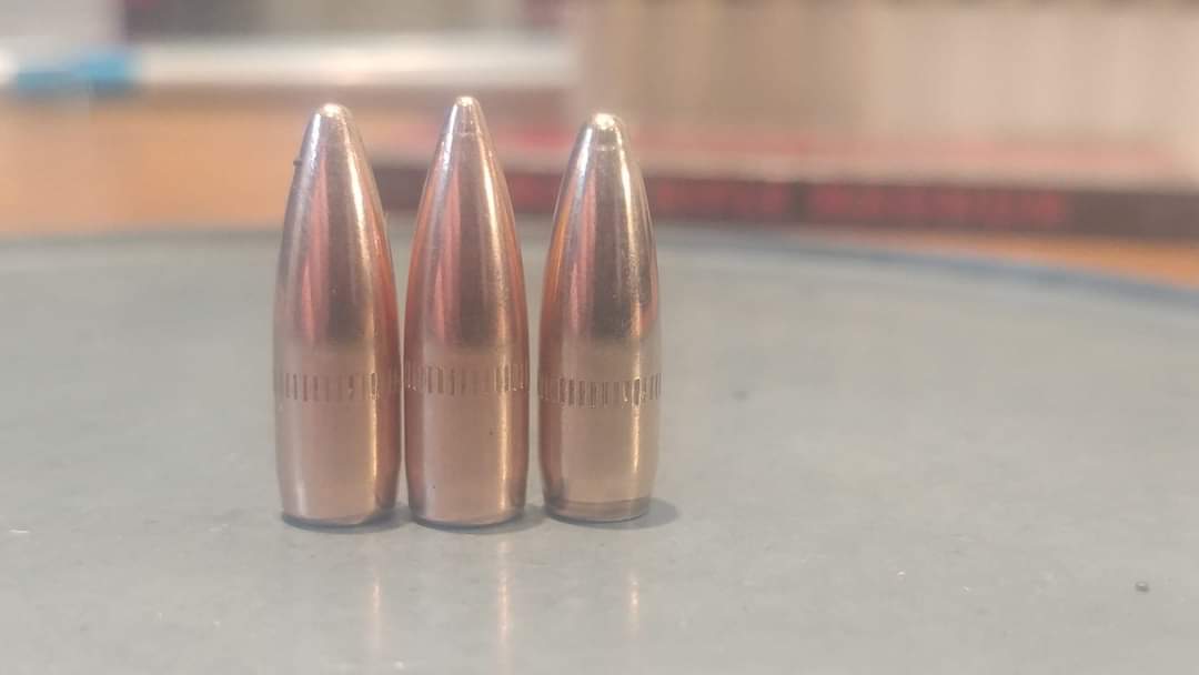

Screw Bob's Bullets. Out of a random 10 bullets. The whole 3k count order was like this. They wouldn't respond to any emails or messages.
I found 8 distinctly different bullet profiles in that order.

Color me skeptical, but I have never seen a 55 FMJ from any company, including Lapua, consistently shoot under an inch.

I've seen small length and weight variations with Hornady. I've never seen missing boat tails, different shape boat tails, missing cannelures, cannelures in completely different locations, varying ogive shapes, different meplat shapes, wildly varying length and weight with Hornady.
Disliking Hornady is one thing. Pretending that straight garbage bullets from Bob's aren't a problem is another.

I have been using Bob's for 3 + years and not once saw any bullets that looked like that.
A few got dinged up in transit with the bulk packages but acceptable at the price point.
Did you try them out before ordering 3k worth?
Seriously those look like floor sweeping.
Yeah I'd been buying for about two years at that point. At least 10k of good bullets before that order. The junk bullets were in 2020 I think, right around the time they hiked the price up significantly.

If I had ever received any bullets from them that looked like the ones that @TonyTheTiger showed us I would not have wasted powder or primers on them.
