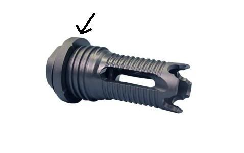

It is not the whole mount that is twisting, it is the ring where the teeth are, that connects to the tail of the suppressor, that will rotate.

It twists on both my 556 and 762 mounts, so if both twist, I am guessing it was made to do so. Like I stated in the review, it is not to my liking, but has not shown any obvious affects on accuracy.

On both the 556 and the 762 mount on mine it falls between the detents on the collar so to get it to fully lock you have to nudge the collar as you twist the can, Not a big deal to me as I know no better! As far as accuracy, With mine (762) it turn's a reasonably accurate hunting load into a 1/2MOA or better group without fail. Out in the open its definantly hearing safe but in somewhat of an enclosed area(Shooting house, under the shed at the range) It has a little bite to it.

I have both the 5.56 and 7.62 QD's. Both have flats on the flash suppressor body and as you can see from the pic, the engagement washer is machined so as to fit with the flats so it will not rotate.
You can take yours apart, just simply take the spring clip off that holds the spring-tension-wave washer and the engagement washer will slide off the flash suppressor. This is my 7.62 QD, the 5.56 one is mounted already.

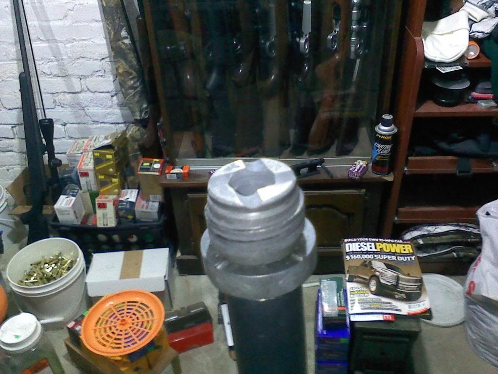

I love my phantom. I mostly shoot it on a heavy 300wsm. I never reall shoot it without the can so I never have a shift
I actually knocked off everything in front of the qd threads because my rifle wouldn't fit in my case with it on, no affect on accuracy or alignment.

I got the YHM can to not rotate, I had to put a little elbow grease into it but no wobble. The "locking plate" needed to be held tight while the can was torqued down.
