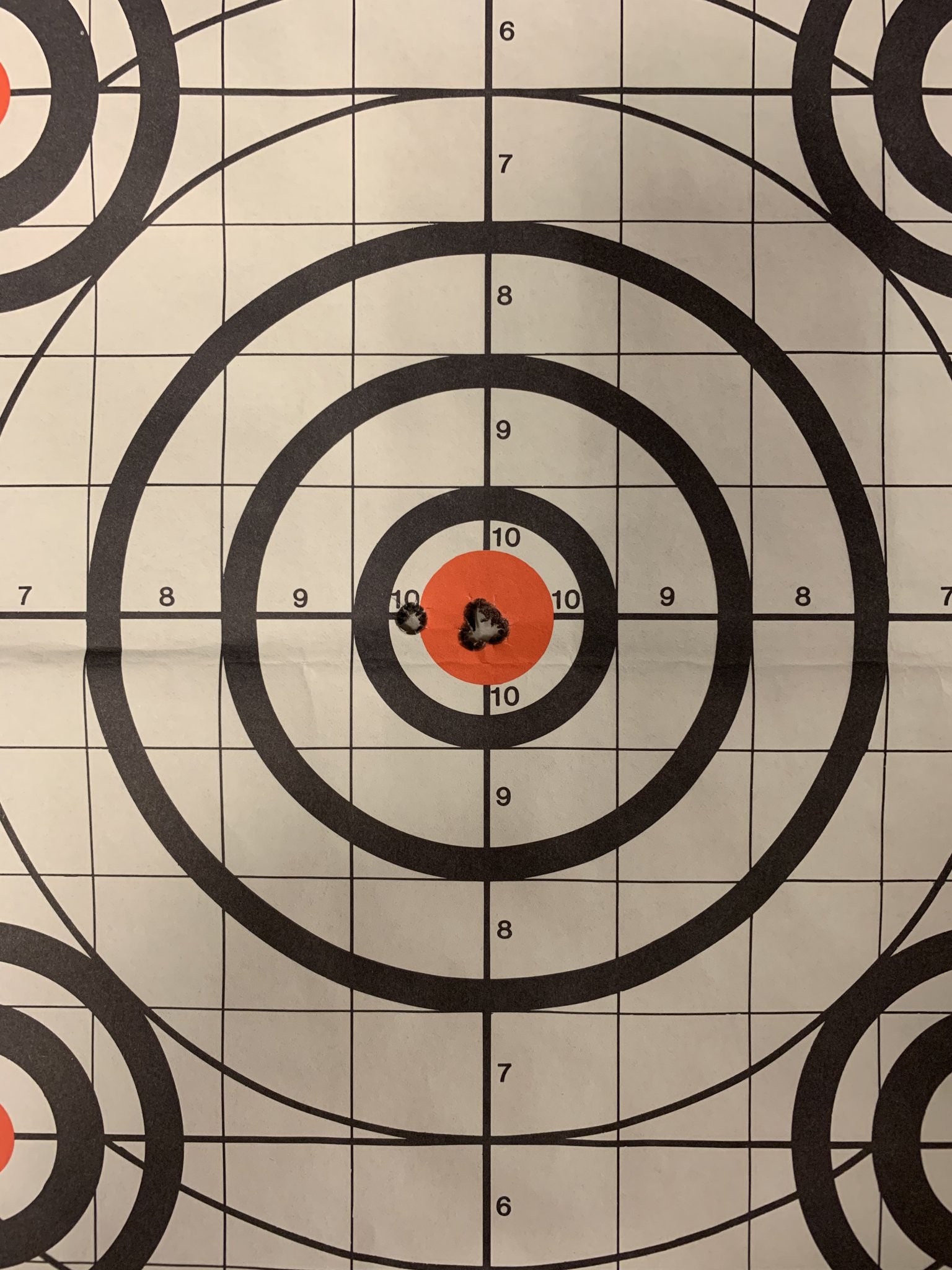

Hornady 140 ELD-M
First shot 100 yards cold bore with no adjustment for wind at 9:00, next 4 compensating for the wind.
