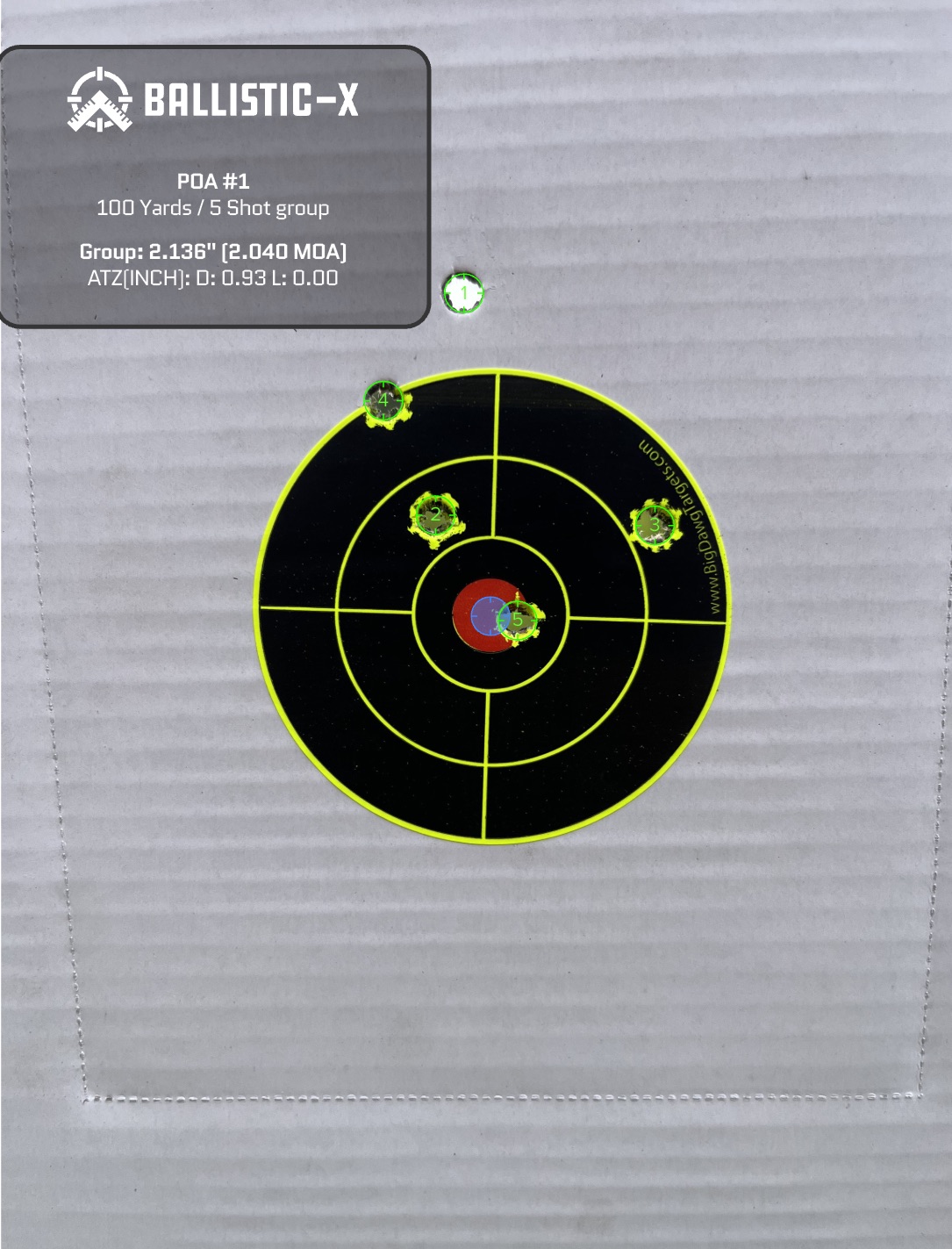

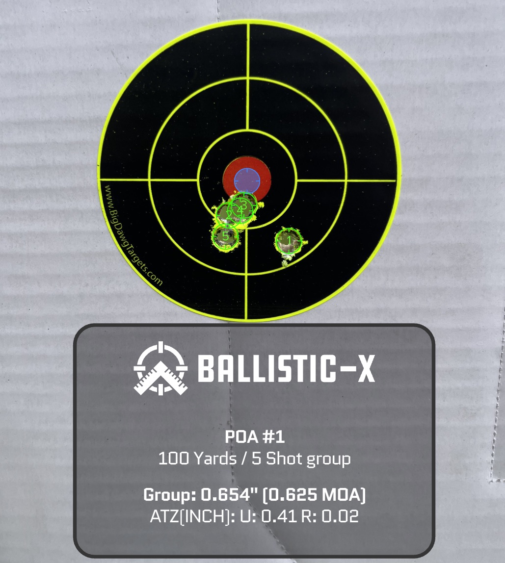

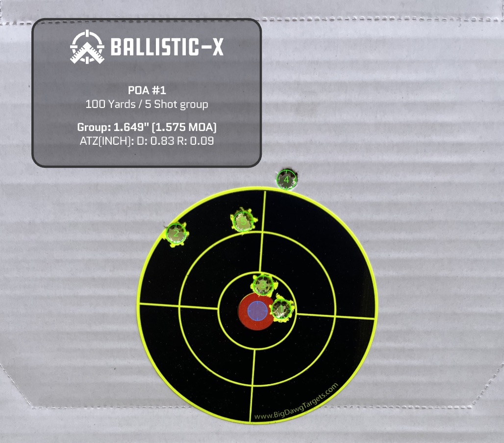

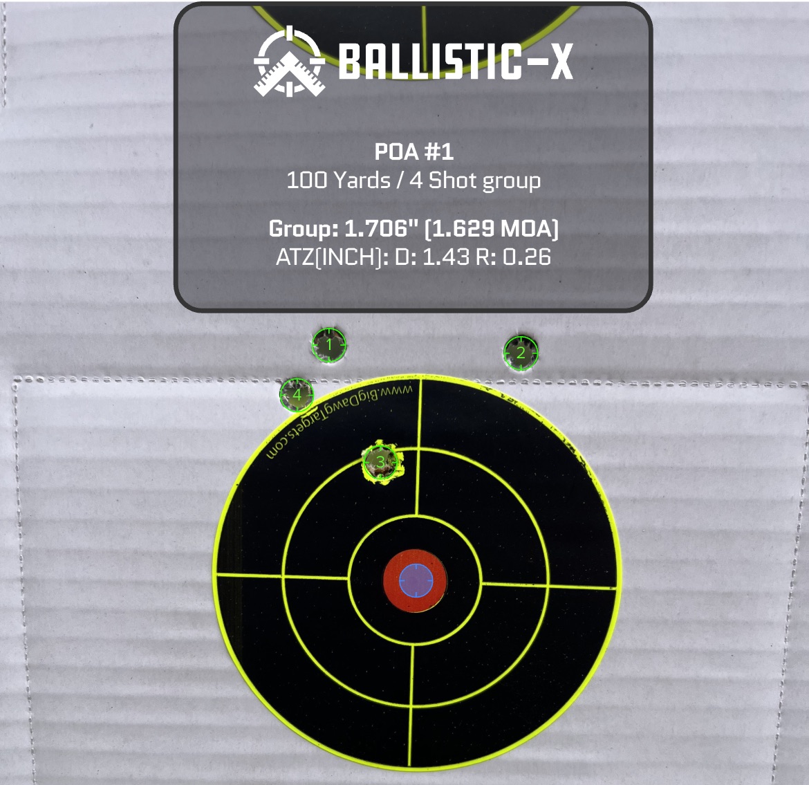

Was hoping to come here and tell yall how great my 18” carbon osprey in 25 creed shoots, but that doesn’t seem to be the case, at least not so far. Finally got a chance to go to the range today as my atx just got back from the smith’s. Got set up at the range and shot about a 1.5 moa 5 shot group @ 100 yards. Thought no big deal it’ll settle in after about 10 rounds. Let the rifle cool, and repeated with same results. Did this 5 times with the same results with the factory 134 elm’s. Thought maybe I had missed a step installing the barrel so broke it loose and retorted everything, even removed anything I thought might be contacting it. Shot a 2 moa group after that with factory 128 Eldx. By this point I’m pretty bummed and wondering if it’s just an off day for me so I grabbed my Geissele GFR and shot a .6 moa 5 shot group.
Not sure what to do at this point, going to check torque on the rifle chassis and see if something is off and if so I’ll shoot it again to confirm accuracy. If it won’t shoot I’ll ship it back to pva and see what they say. Really sucks as I sent them a box of factory Eldm and Eldx for them to measure when they were chambering the barrel. I guess the factory AI barrels have spoiled me a bit with factory ammo. Will update with my findings/results as I dig into this issue.
There's a lot of potential things that can happen here. Based on reading through the thread it sounds like there's more than just the barrel to be suspect about. Before we write off the barrel and replace it there's some testing that needs to happen and we'll be happy to walk you through it.
ETA: Ben just mentioned to me that he's replied to you, so we'll take the support offline rather than clog up a thread.

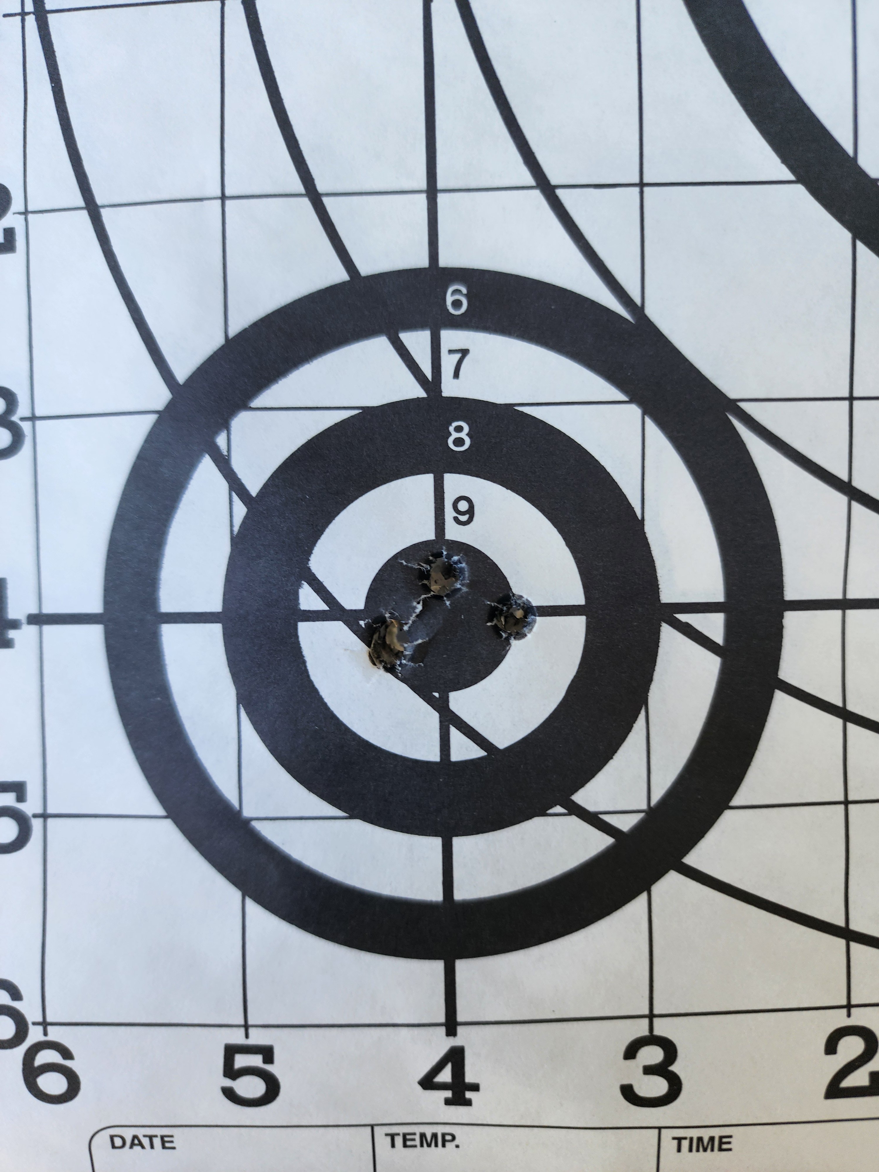

Finally got a break from work to drag out my 7prc pva/cdg, 1125yds with 184gr berger/h1000@3050fps. This thing hammers and vertical is unreal.

:oops: Damn, dude.... want a work-study job testing rifles? :ROFLMAO:
Awesome shooting!

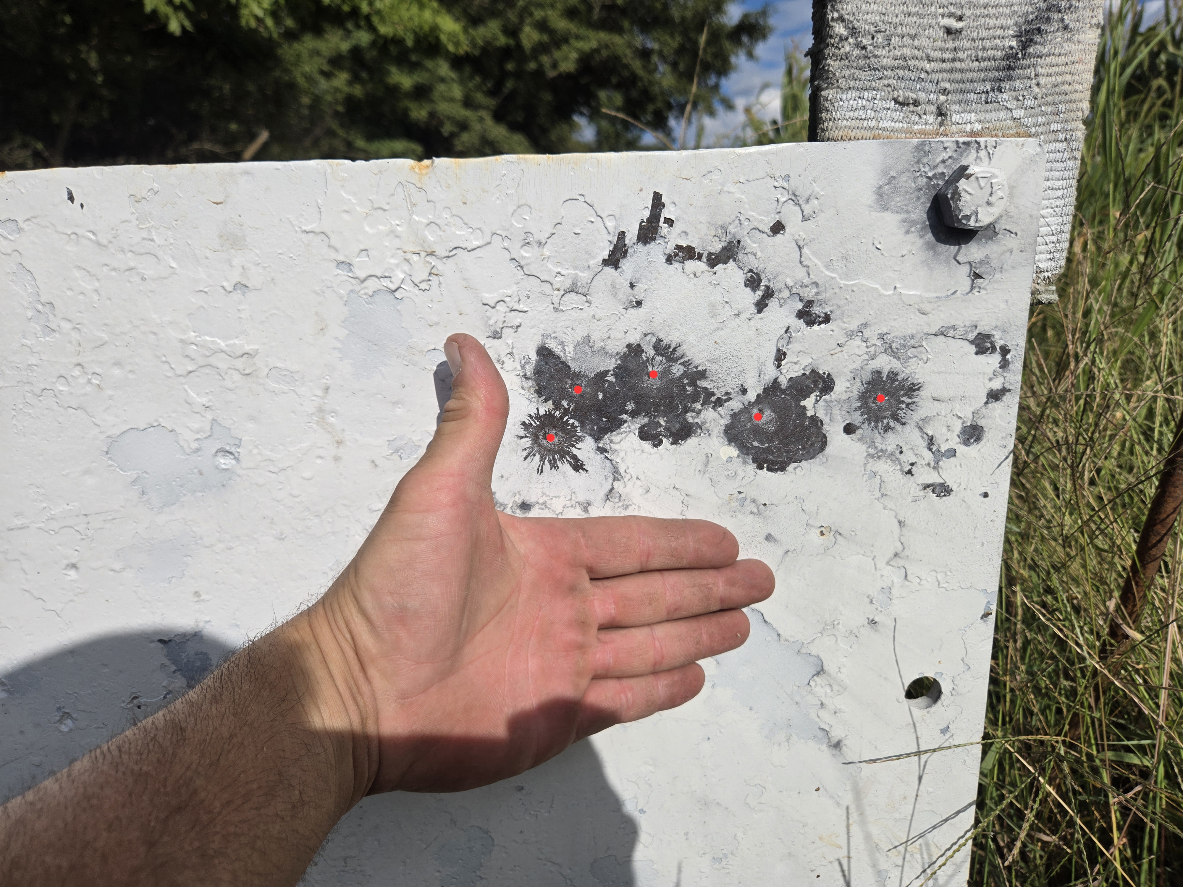

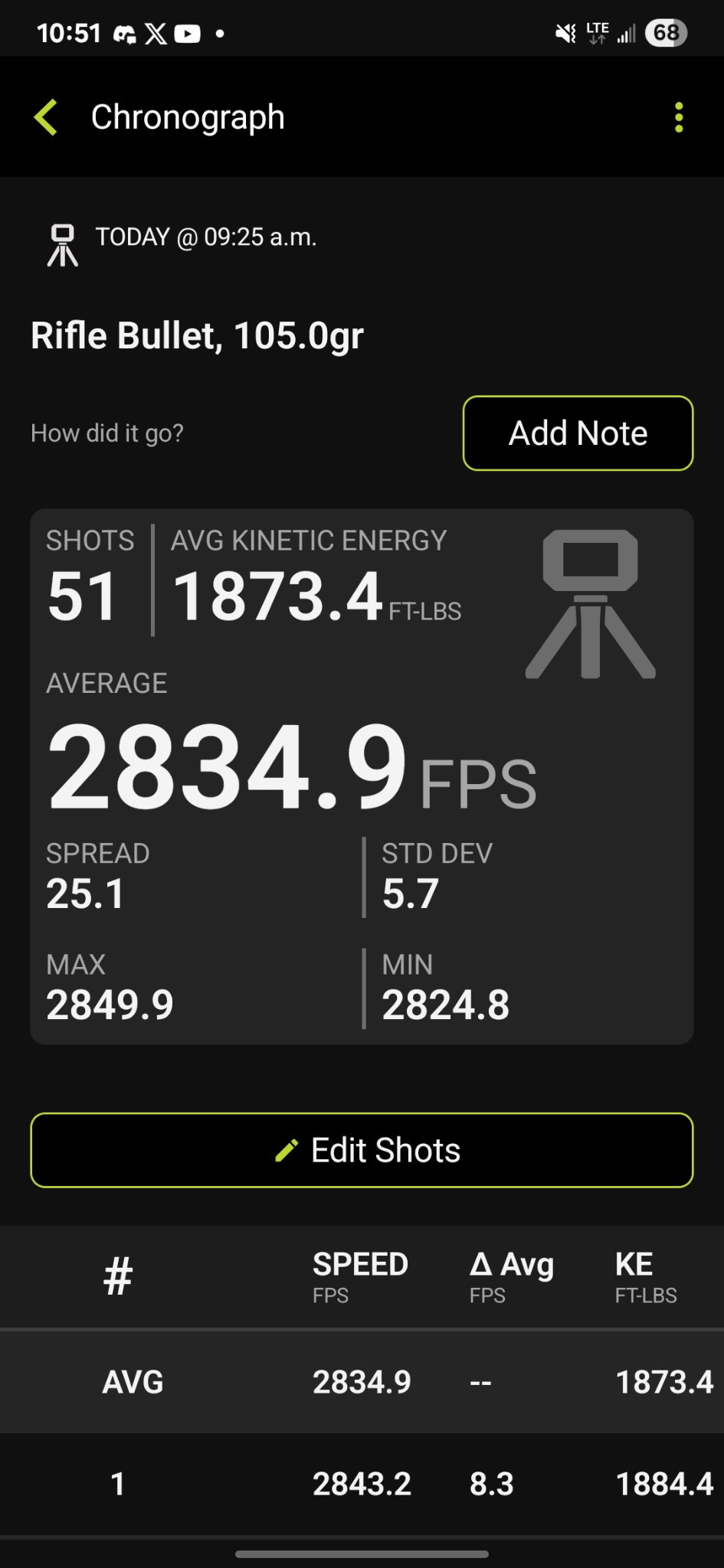

That reminds me of something we got from a guy in Canada recently. This is 51 shots with his Osprey 6 something, a Dasher maybe?... ES 25, SD is 5.7
I confirmed it with him, it was indeed a 51 shot string. I asked him about the speed and he said "I don't care how fast it is when it shoots like this"

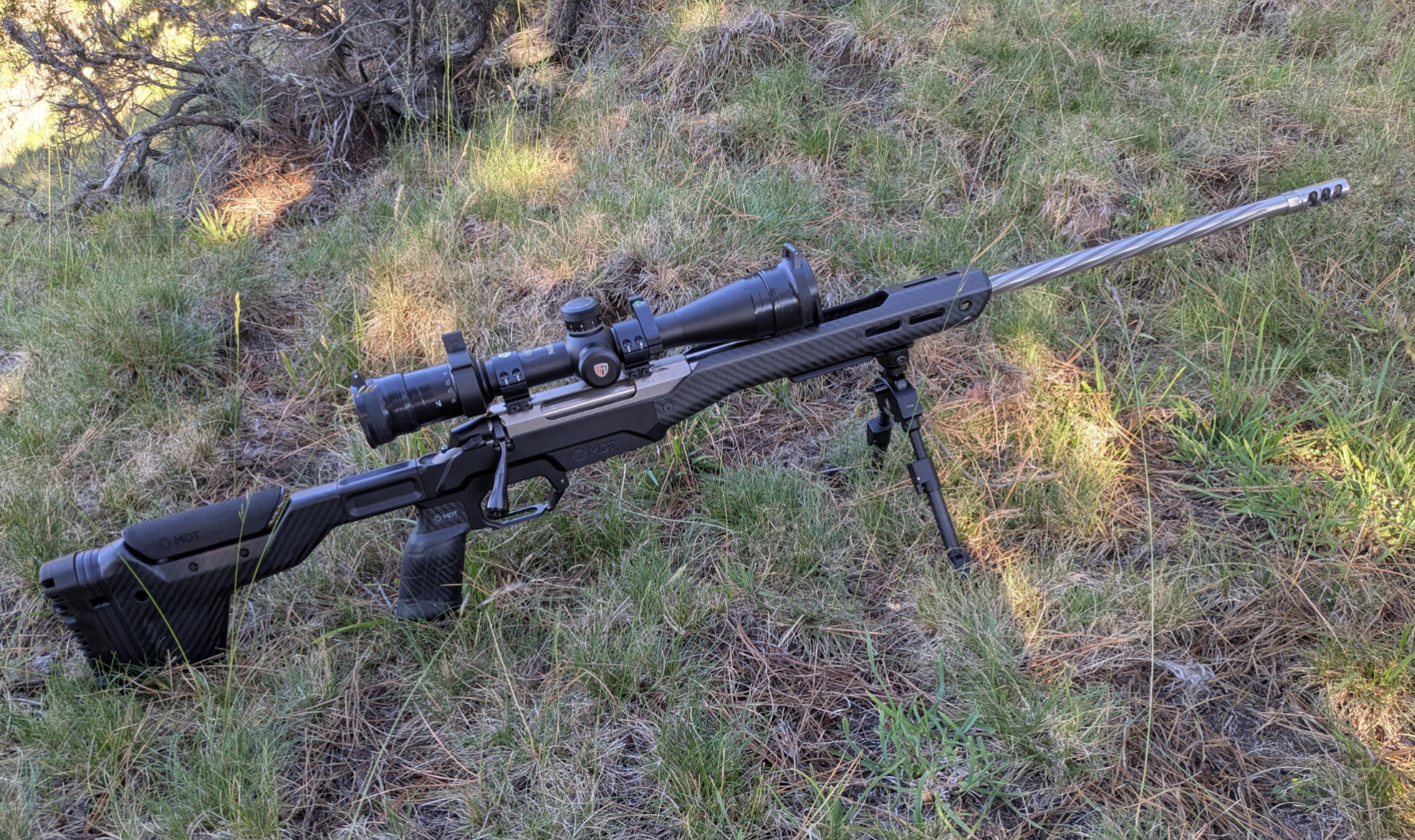

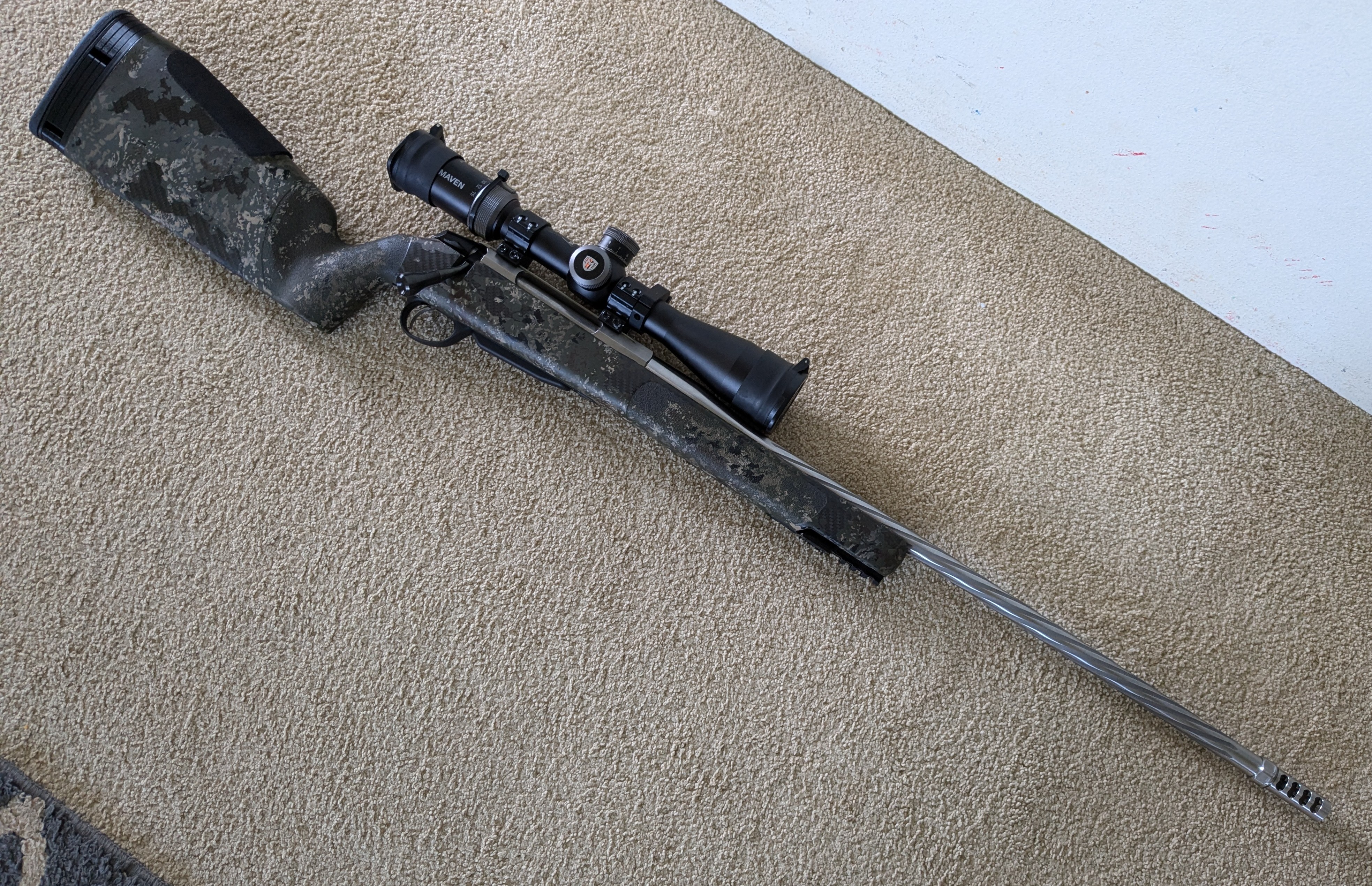

Do you have a pic of that rifle? I've been thinking of getting a taperless for a light weight yote rifle, for when the carbon proof dies.
This is how it currently sits. Barrel was 2 lb 9oz. rifle with 3rd flush mag (no bipod )is 8lbs 14oz (26oz scope)
Attached is a pic of it in a stock that shows the contour a little better

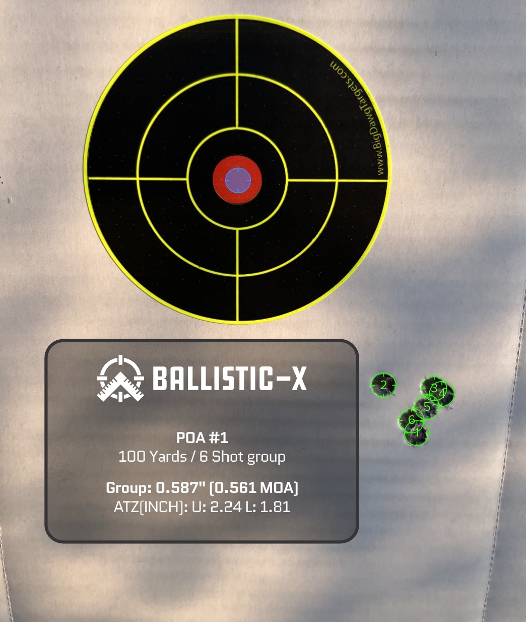

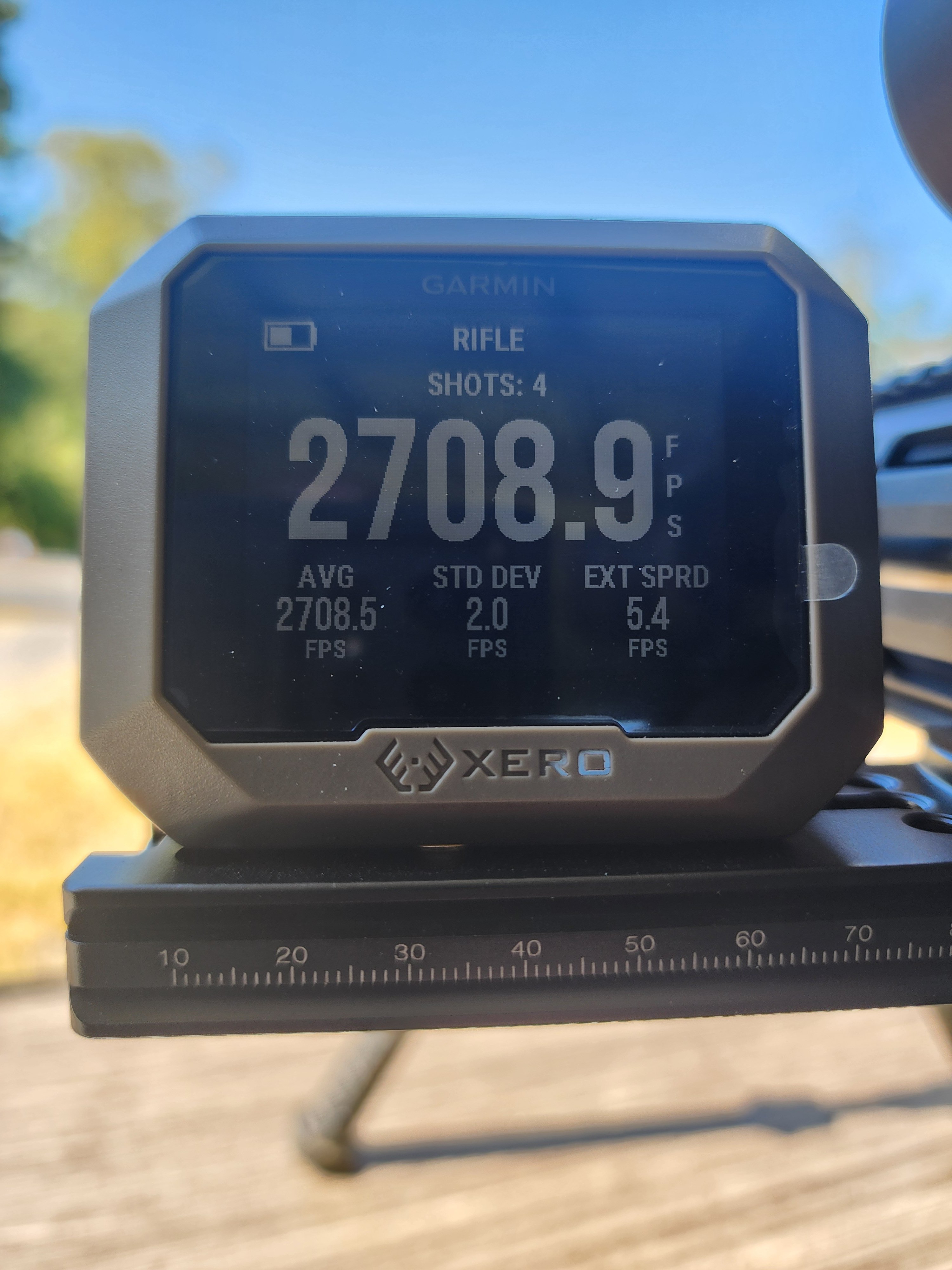

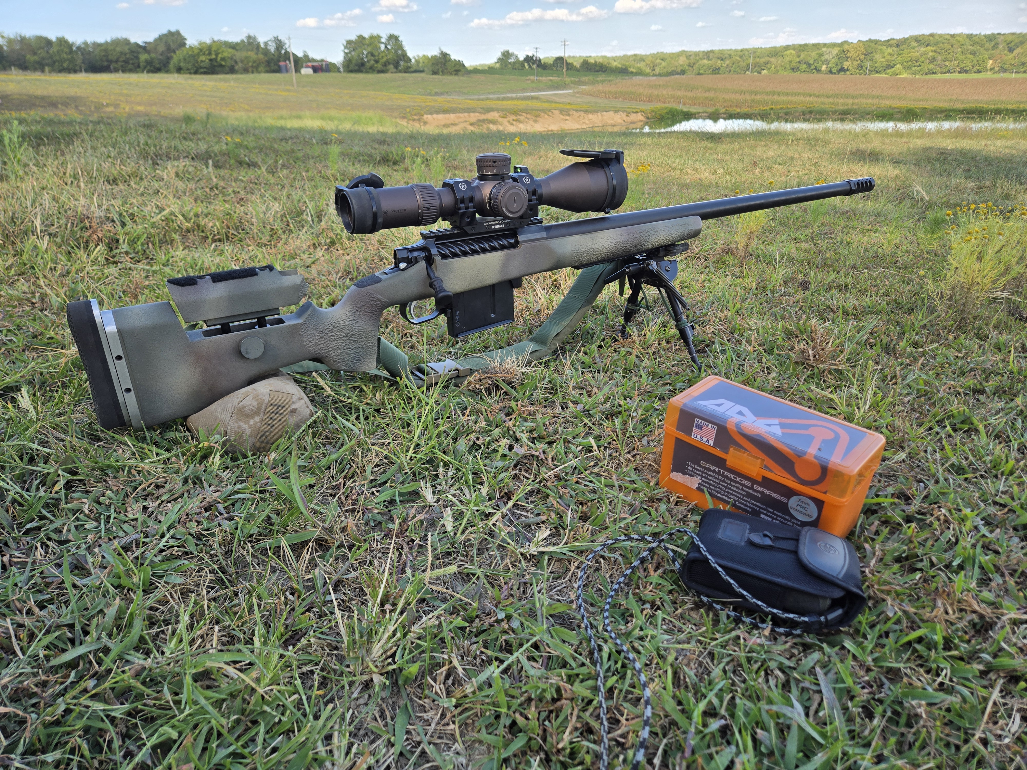

First off, I want to start this post off with an apology to @bohem and PVA. I’m sorry if I caused any negative impact on your business with my posts I made in this thread. I cleaned most all of them up and will move forward with this one.
TLDR: barrel shoots great with Eagle Eye ammo!
I ordered some Eagle Eye ammo last week in 25 creed since I’d been having accuracy issues with using factory Hornaghey. Turns out it was all Hornaghey’s fault after all. The Eagle Eye is pricy at almost $3/round, but I’m used to that having shot 300 Norma for a while. Group pic below. I shot all six rounds I took with me in this one group since after mounting my scope my boresight job was close enough. Pretty wild going from 1.5 moa with hornaghey to almost .5 moa with ammo using the same bullet.
Great news and it definitely shows how much dispersion a slight change in a few components can make (powder and brass) even with the same bullet/barrel. I'd def look into handloading if you haven't already. You can get started for about $600 and make that back in savings fairly quickly at $3/round for factory ammo. I have an equipment list I can share with you if you want

For what it’s worth I noticed almost immediately that the 25cm was not as easy to tune as the x47. Pretty much anything I throw at x47 with a Berger 135 is in the .3’s and lower. So .5 with eagle eye is great. They make good ammo, but at the end of the day it obviously isn’t tuned for that barrel. Is eagle eyes ammo loaded with a Berger or Hornady?
Also, what velocity are you at with it?
Reactions: WeR0206 and CStroud
They have both Berger and hornaghey and this was the 134 eldm because they were out of Bergers. I did not check velocity tonight just wanted to see if it would shoot. I’ll check velocity this weekend though.
I have heard the 134 is good, but the Berger is definitely better. Totally could be the polar opposite in your barrel tho. Curious where your at on speed. Mine likes around 2870 if I remember right but I’d have to look at notes.
Just looked back over the chrono numbers from the first time I shot this barrel with the hornady ammo and it was averaging 2632 over the first 20 shots with an SD of 12. I'll check the Eagle Eye ammo this weekend.
Also I'd like to reiterate what a great job of communication and brainstorming PVA did during this factory ammo crisis. Josh actually ordered bullets and a bushing and was going to load me some ammo to see if we could get it shooting. That's a level of customer service that I have not received in this industry... ever. It doesn't appear we have to go that route now, but it's great knowing that the support was there if I needed it.

An SD of 12 is actually pretty decent with factory ammo. Was also curious if you could put 10 rounds of eagle eye in a mag and put 10 rounds of Hornady in another. Grab a mag blindly and shoot it. Then shoot the other. With the velocity differences you should know which is which. Compare groups. I’d like to see them.
Switching ammo back to back is a recipe for the second group to be sub-par.

I guess ya I did not think while typing that. Since it’s not same everything except powder charge or seating depth. Nvm. Excuse my ignorance.
But I would be curious after say 100 rounds down the tube, what the Hornady stuff does.

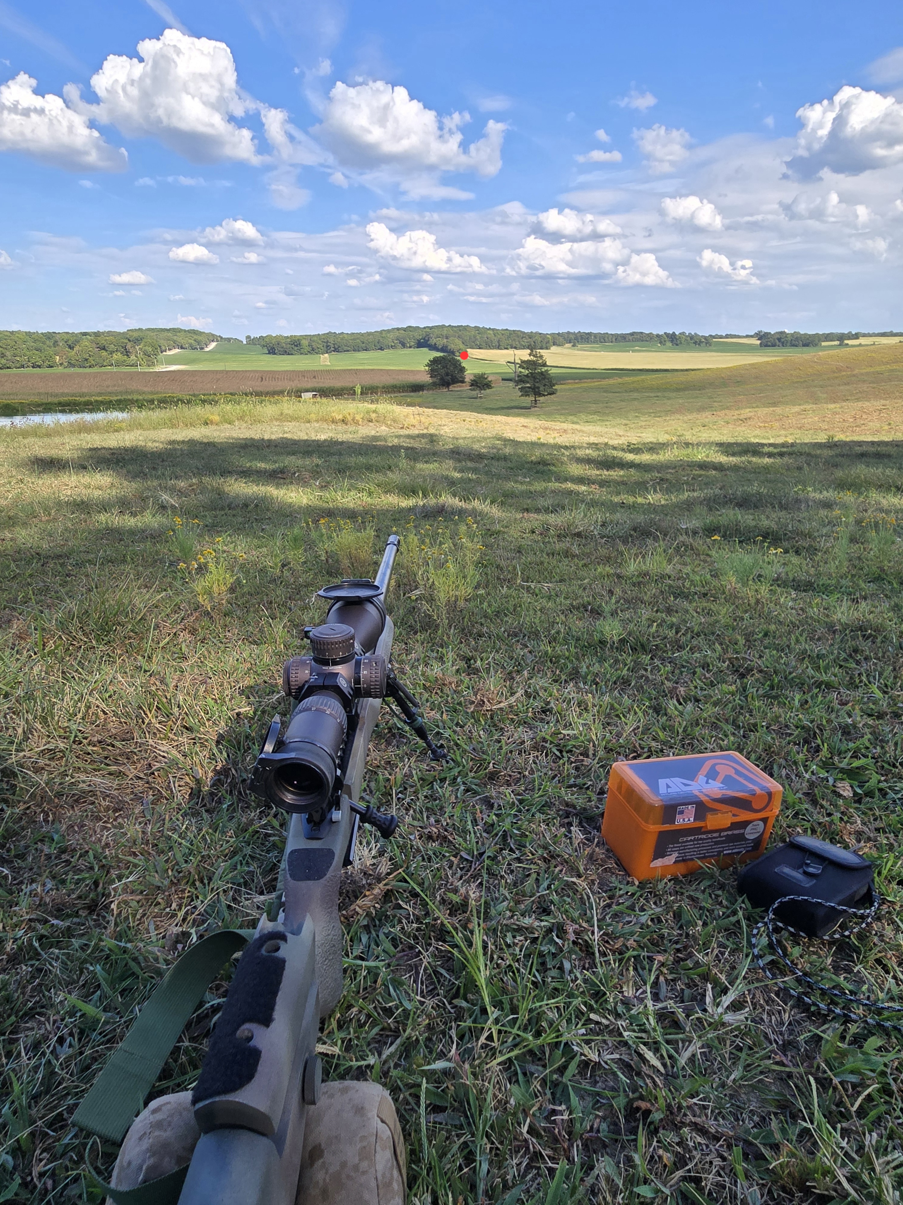

I got the barrel I ordered during the FFTC sale. Josh’s team removed the Tikka factory barrel, and installed a 24 inch 6.5 creedmoor barrel on my action. Took it to the range today, and it shot very well. Followed the recommended break-in procedure, got the scope zeroed, and shot several .6 inch groups at 100 yards. And this was using factory ammo - Fiocchi 143gr. SMK. Not bad at all for day 1 of a new barrel, using factory ammo. I’m pretty happy.
Now to stretch it out to some longer distances.
