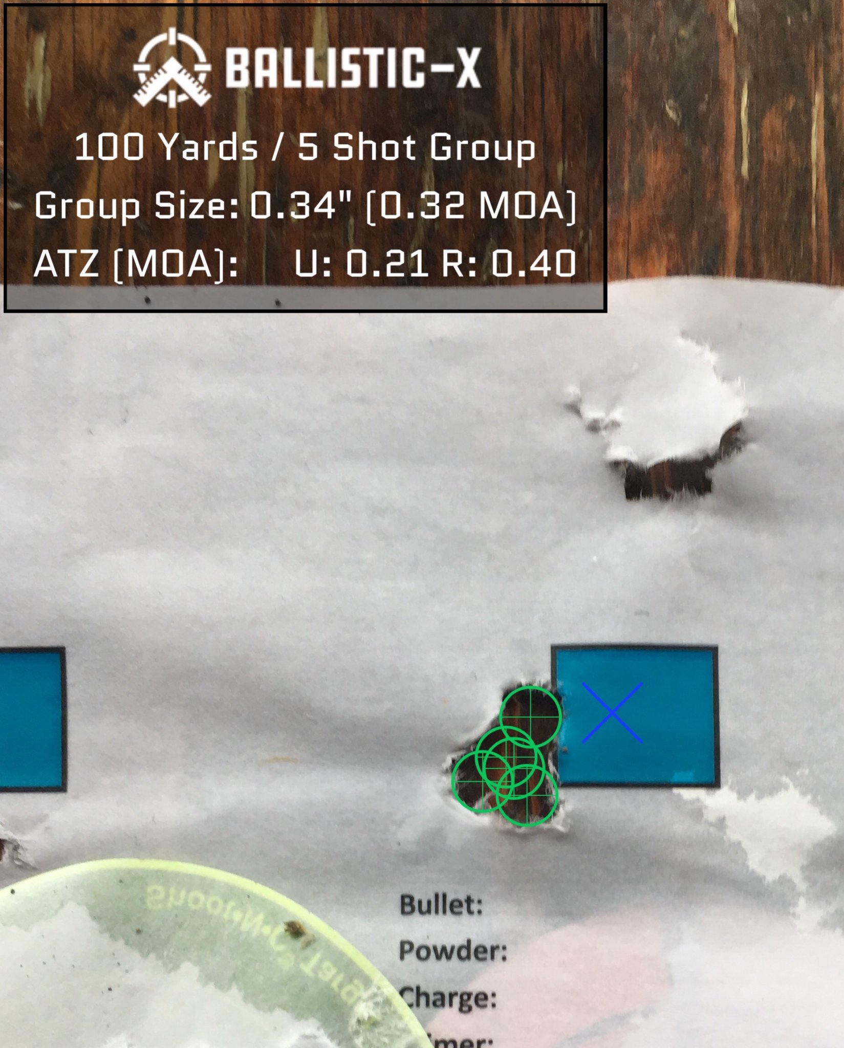

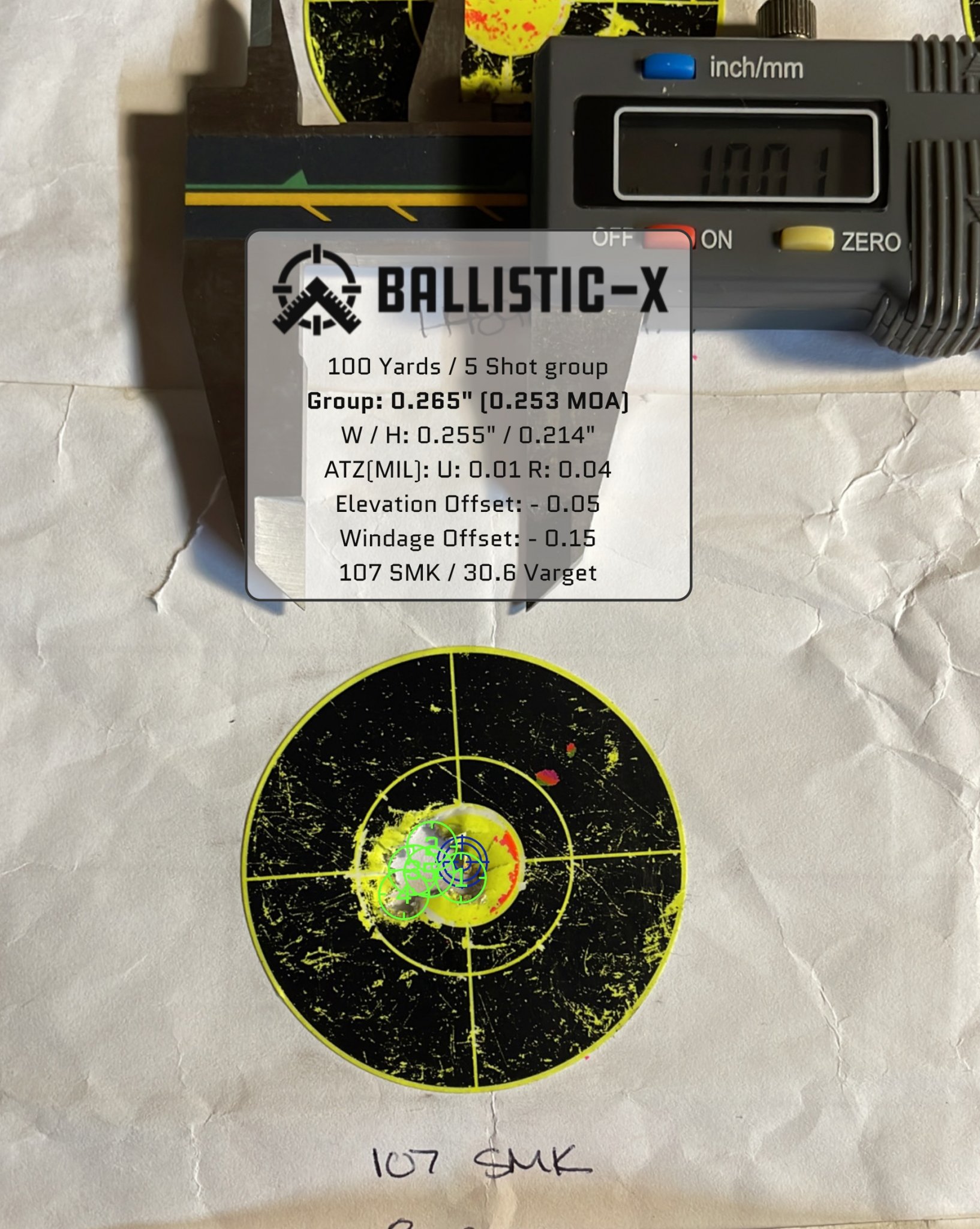

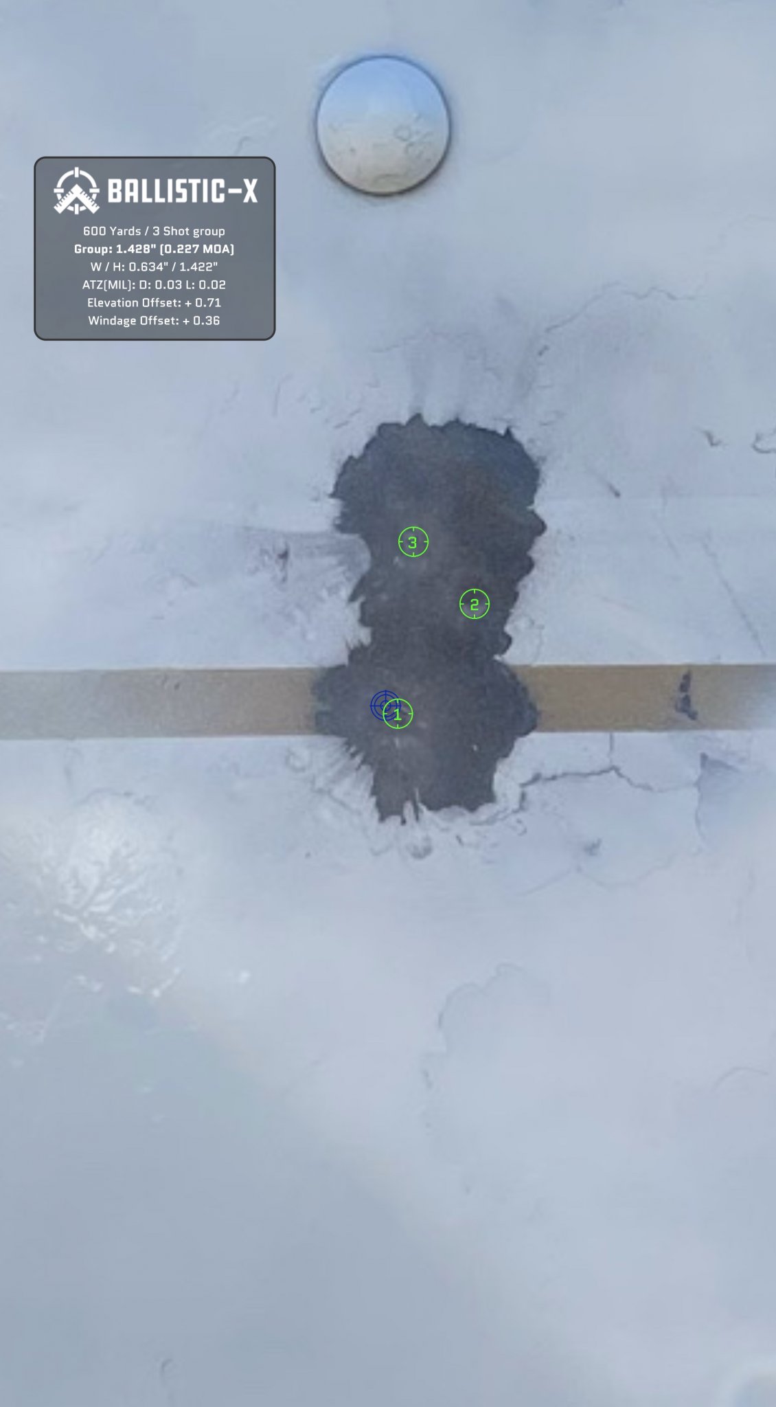

I'm on my second PVA prefit. I had a Rock Creek shouldered prefit for a Tikka in 6.5 CM and another Rock Creek shouldered prefit for a Lone Peak Fuzion in 6BRA. Both shot unbelievably well and can print in the .3s pretty regularly from prone. PVA prefits are good to go.
