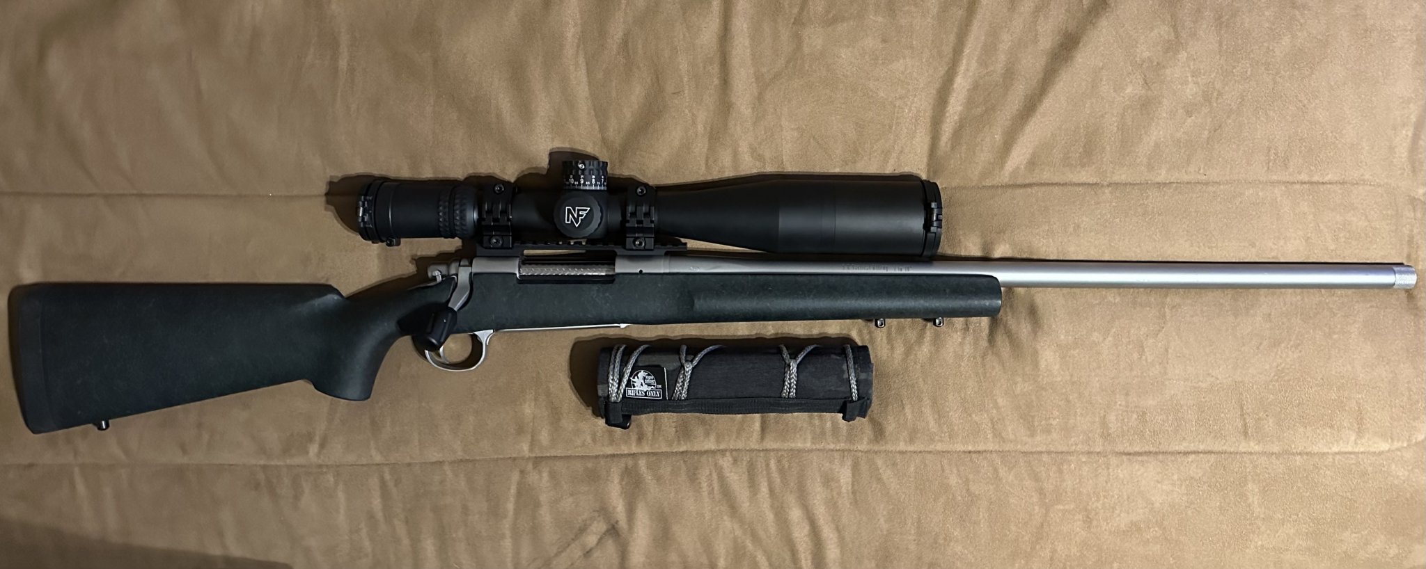

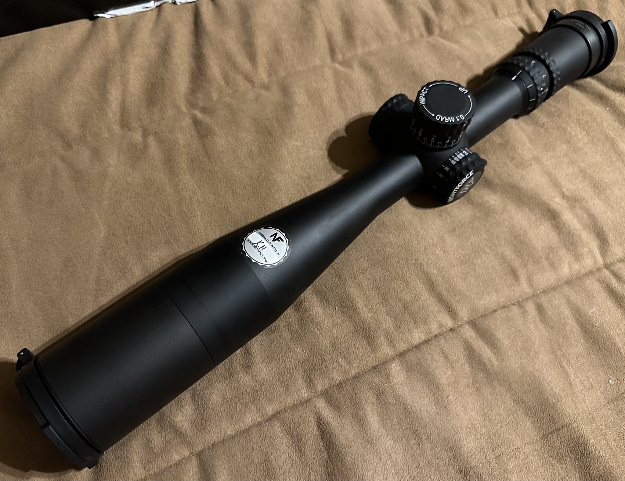

The Zeiss LRP S3 glass is considerably better than my 5-25 ATACR’s. The 7-35 may be a different story. The Ziess is brighter in day and low light.

Definitely better glass than my 5-25x ATACR F1, as well. Brightness doesn't even compare. The NF is very neutral...Which my eyes are not a huge fan of, unless I'm in direct sunlight enough to brighten up the image through the scope. This is one huge reason I don't like S&B scopes. Their glass is the same neutrality, but some of the PMII models have a vermillion-colored tinting and I don't like it, it messes with my eyes. It looks like you're looking through a periscope in a muddy river.

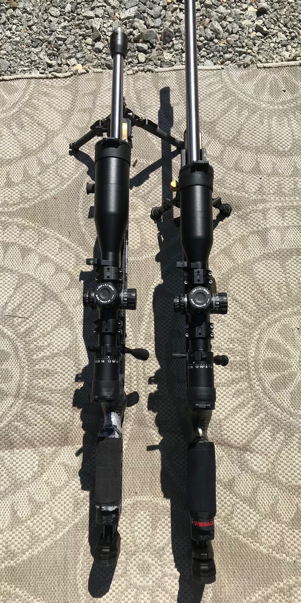

Yeah get the 6-36x as the 2x difference at the bottom won't make any difference as you don't by a 25x or 36x scope to use the lowest power a majority of the time or even any time except to maybe get a wider FOV to find a target. With the reticle design as mentioned you can see the reticle pretty good and with the illumination on it's like a red dot almost as you have a mil sized square box aiming point. Play with using the illumination as it does help at time when getting on target to take a quick shot.
I might have posted this before but in case you didn't see it it's a size comparison between the two. 6-36 on left and 4-25 on right. Both have sunshades on them.
