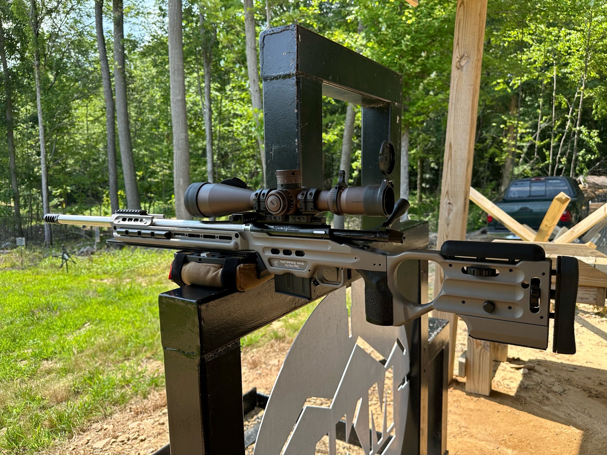

Last year I built a .223 PRS trainer rifle and went with the .223 Wylde chamber at 26 inch length. I would not recommend a carbon fiber barrel because balance of the rifle is really important in this game and you want more weight in the barrel. Ideally, you want the rifle to balance just in front of the mag well (see pic). I shot a one day regional match with it last month just for shits and grins. It performed well (I still need more practice), but I could definitely tell the 75 ELD-M was being pushed around more than the 107 SMK that I run in my 6 CM PRS rifle. That was expected, but it was a good exercise to require me to pay more attention to the wind with the .223.

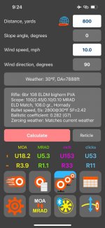

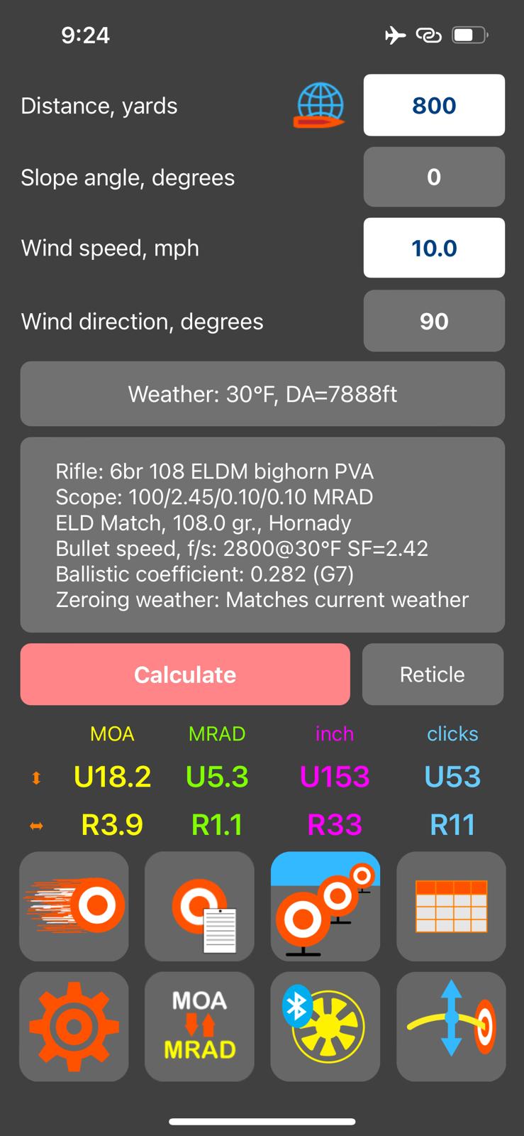

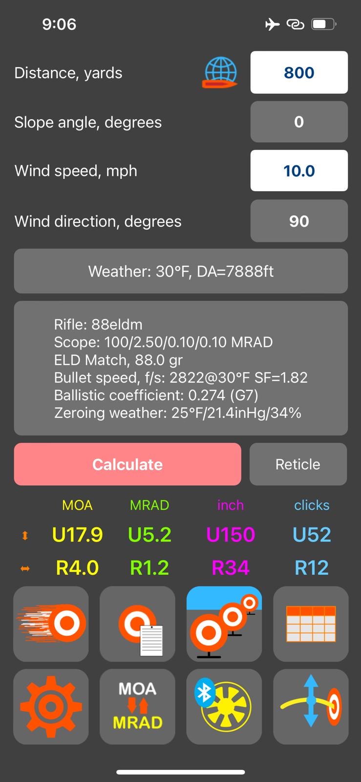

Also most points at least at the local matches I shoot are under 600-800 yards and at that distance the 223 is not holding you back. Below is my ballistics on my 223 26” Wilde chamber rifle shooting 88 eldms vs my 6br running 108 eldms. 800 yards 10pm cross wind.
My current dasher running 112 match burners is a step up in performance but I sold my BR, the 223 is really a great round that won’t hold most people back and likely will improve the average shooters scores.
