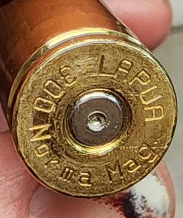

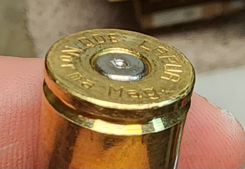

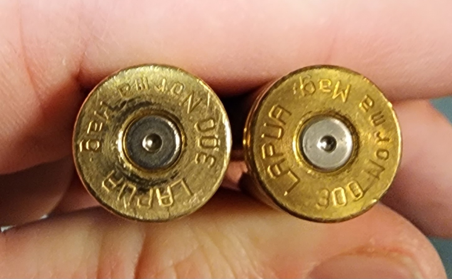

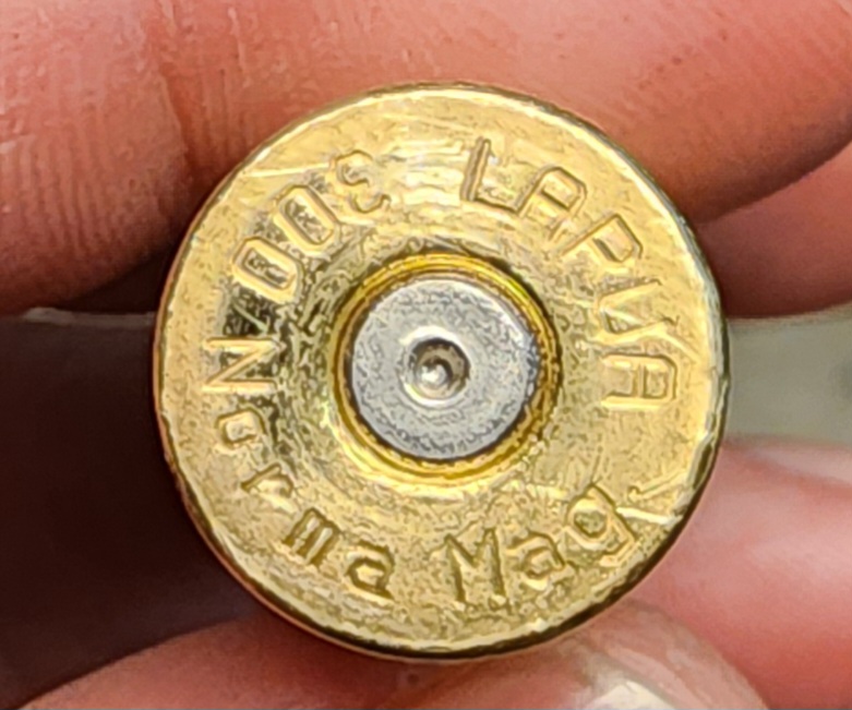

I'm having a difficult time doing load development and I'm also new to reloading so I'm not sure if these are pressure signs.
The load is 86.5 grains of n570, Lapua brass, 215m primers, and 215 Berger hybrids. I'm getting 3035 fps, and I've shot single shots over a magnetospeed up to 90.5 grains. I had a slightly hard bolt lift at 88 grains, but 88.5 and 89 weren't hard.

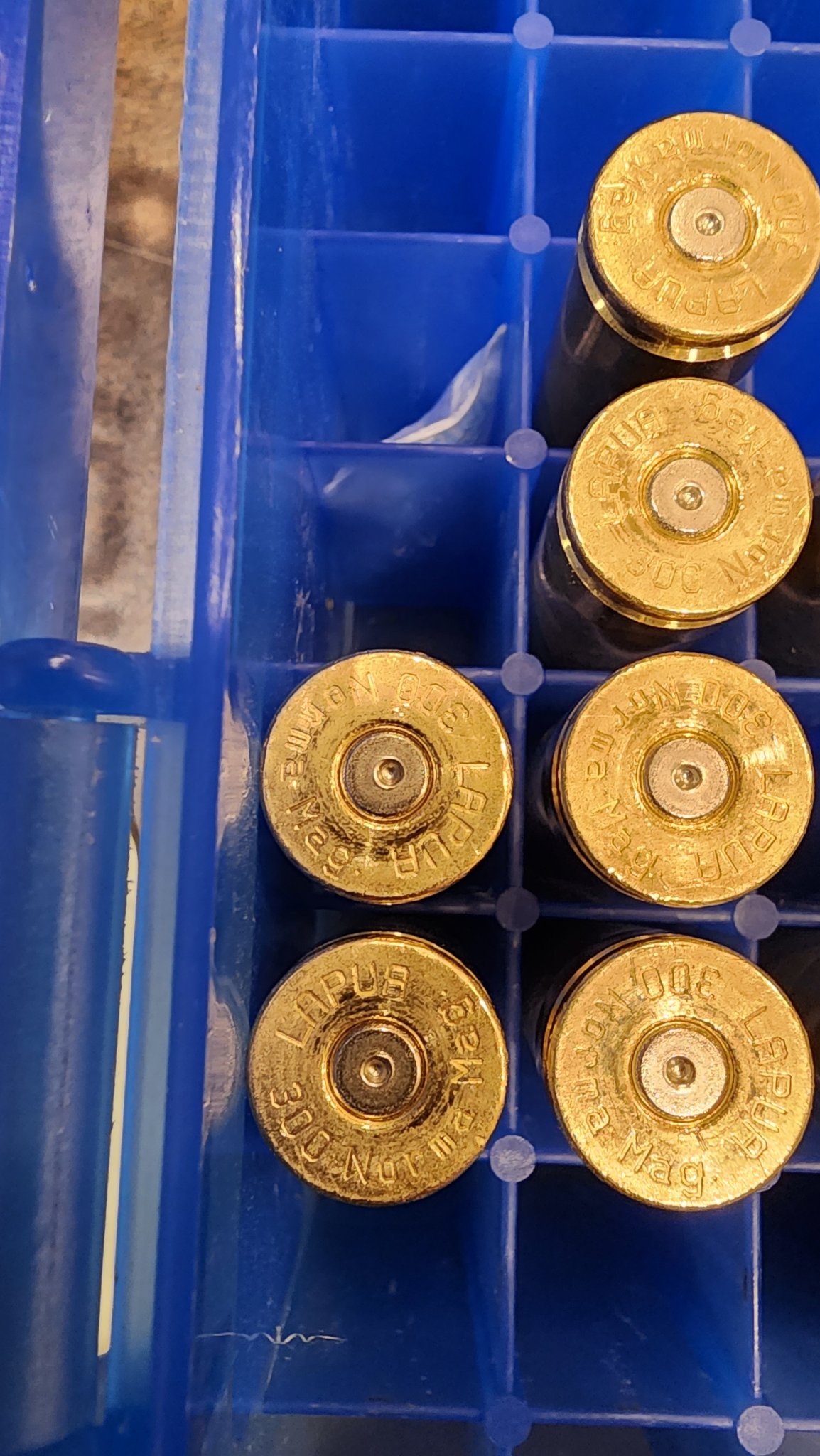

I loaded some up at 86.5, a velocity flat spot, and looking at the brass, I'm not sure if the powder on the back and slight cratering on the pirmers are a sign of pressure or not. I'm also getting a lot of residue on the necks.
I am also included a picture of once fired(not in my rifle, bought on the hide) unprepared brass next to twice fired. You can see a pretty significant difference between the two.
Looking for any feedback. The load data for n570 and 215s is all over the place and I just don't know.
Thank you!

That's a bit of a hot load for 300-Norma, at least from my experience. I'd do a "back-off" ladder and see where I lose the primer craters ... that's always been a tell-tale sign of over-pressure for me. Are you getting a "heavy bolt" after firing? My 300-Norma reference load is:

Pressure signs, in general, aren't deterministic. You're not going to get flattened primers followed by ejector marks and sticky bolt in that order. I've seen ejector marks with beautiful primers and vice versa, so you might not be hitting pressure unless maybe you're jamming into the lands and creating a pressure spike? Also, your primers aren't flattened. See the rounded edges? Yes, there is cratering at the point of impact, but that's not always a sign of pressure. In fact, I've often seen that with normal magnum-class loads.
Either way, the powder choice is not the issue.

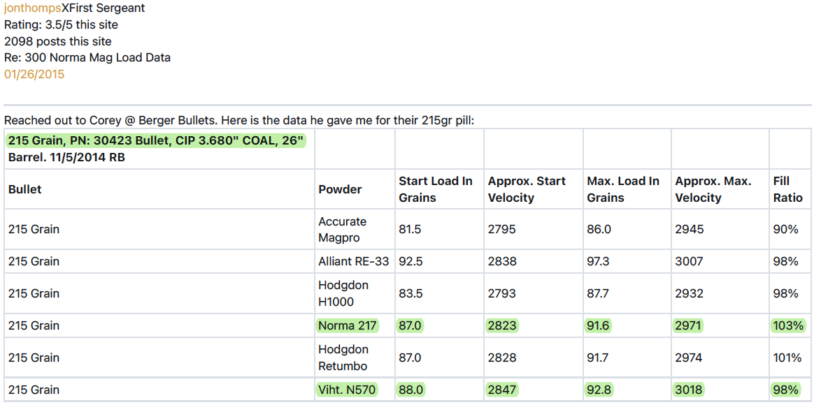

From a previous post on this site, giving credit to the original author, bellow:

I had weird over pressures. My issue was carbon ring above the neck at the chamber boundary. Cleaned the $hit out of it with barrel paste. Off to the range tomorrow.

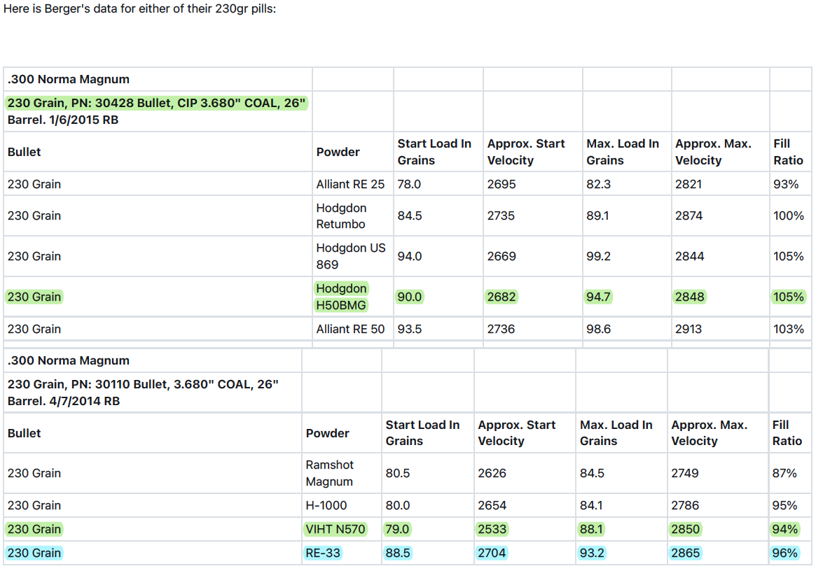

EOD Mickelson and Gorrilla here is some data which may help you guys, not the same bullet but it should be applicable to the 2015 Bergers. With the 300 Norma, I think there is a velocity node with a 26" barrel around 3030 fps-3065 fps (depends on the bullet and powder). I have rifles chambered in 300 Norma and they both shoot really, really well around those velocity nodes. The Temp. I shot at was at 107 degrees not 104. Here is my most relevant data, hope this helps:

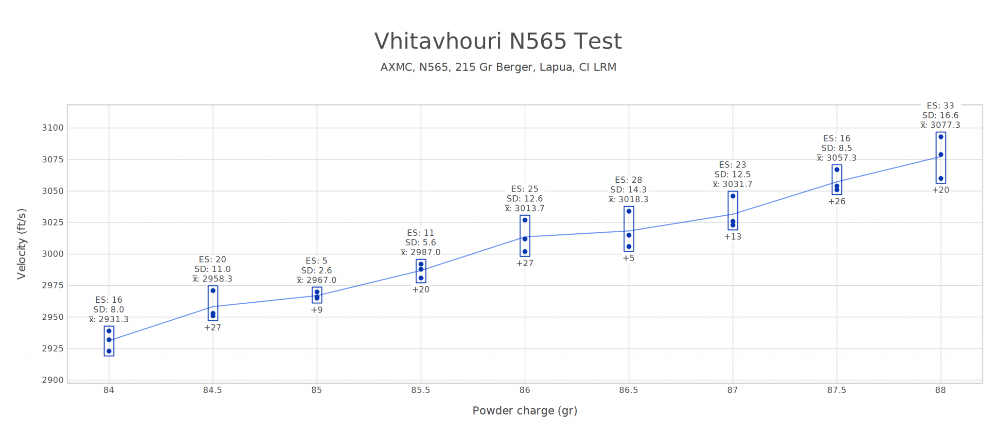

Also, thank you for the data. I'm running N565 with my 215s and top out around 3k before I see pressure. I have some N570 and know I can push it to closer to 3100, but this load is for hunting and as long as it's consistent, 3k is fast enough for my needs. I will however, use N570 for shooting the 245s or maybe 250s at next years NF ELR steel challenge.
My biggest issues with N570 is how darn hot it burns, I completely believe it will eat the barrel up much faster than Retumbo, H1000 or N565/8, and it meters awfully in my matchmaster. After loading hundreds of rounds of N570, switching to 565 was such a relief.
