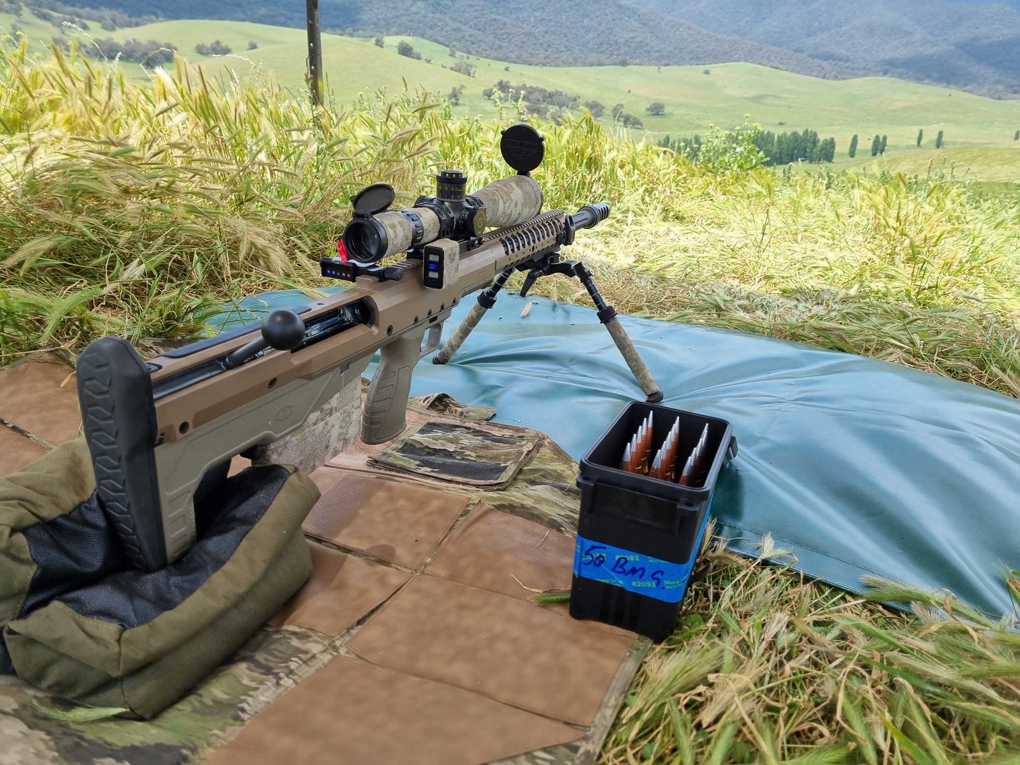

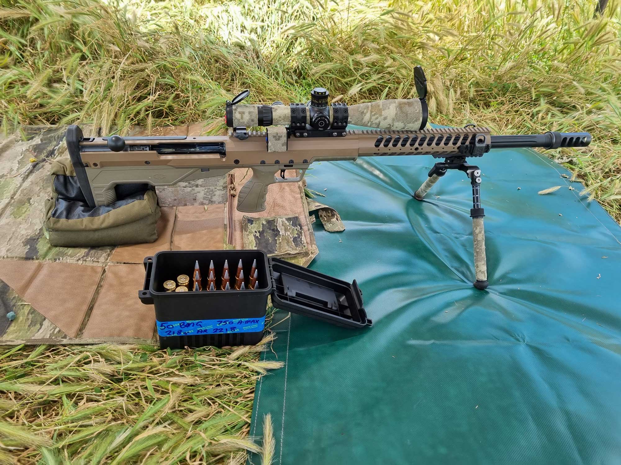

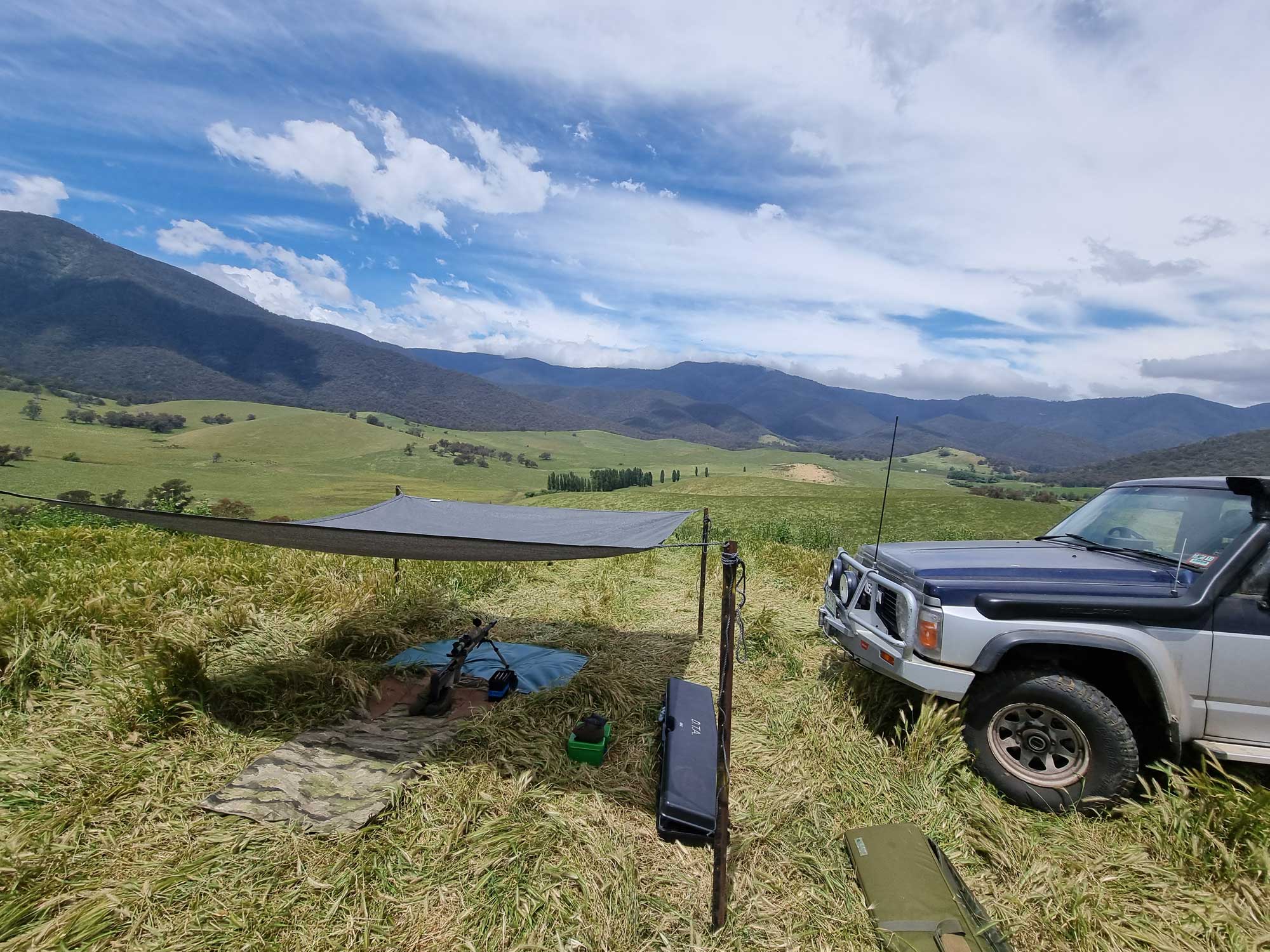

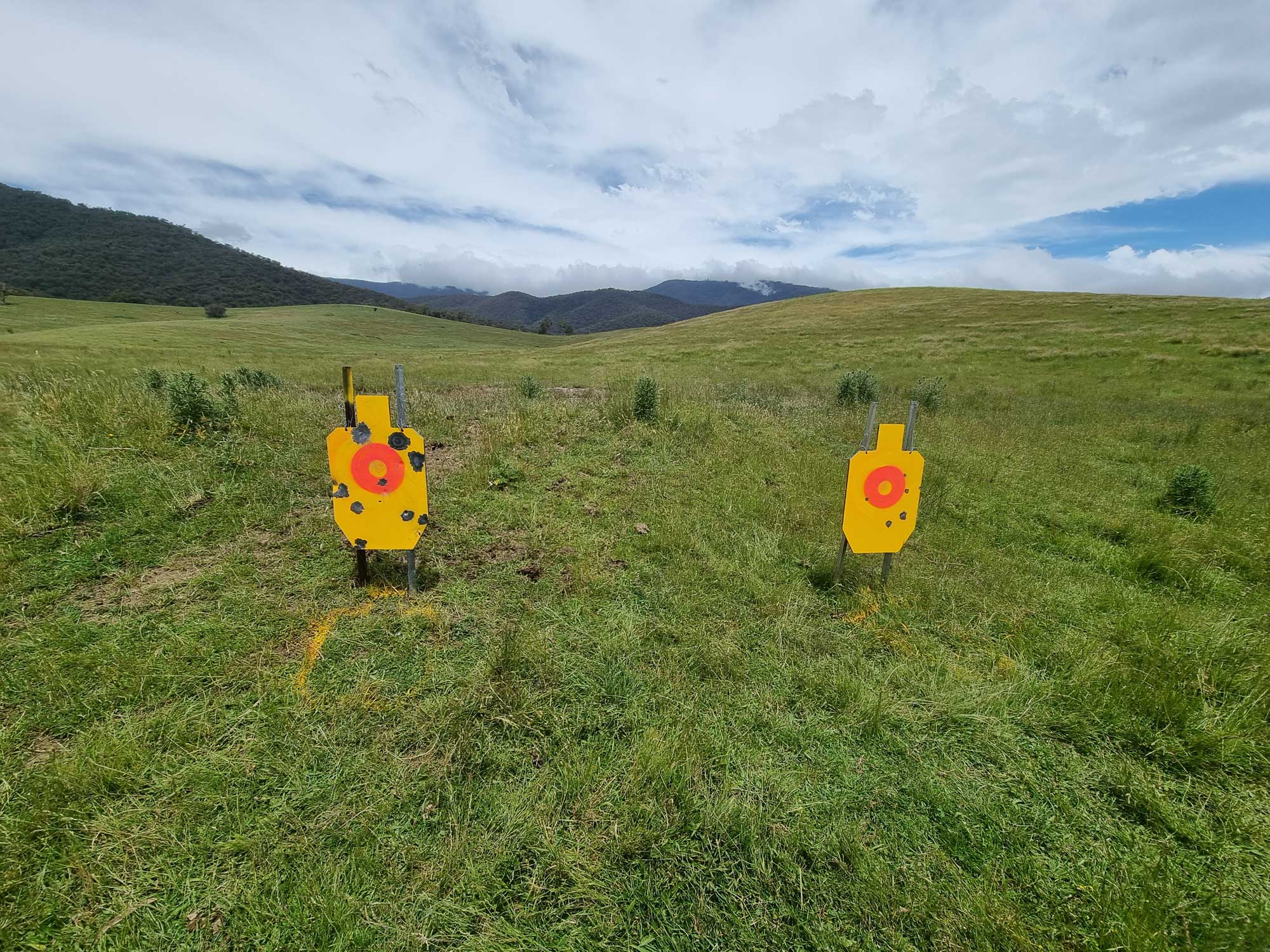

Yeah, i am actually VERY impressed with the accuracy of my 50bmg ( Desert Tech HTI). At 1000yds......it easily holds 1/2 moa. Its quite boring shooting at a 10" plate.
At 2000yds ......... it again performs VERY well..
The below ISPC target was at 2000yds the left target has "3" 50bmg hits in the upper area ( from 5 shots) the lower strikes are from the 375CT..
i am incredibly jealous of your range sir. absolutely beautiful country side there!
