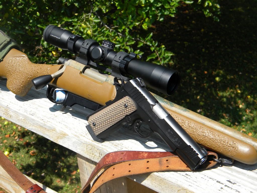

<div class="ubbcode-block"><div class="ubbcode-header">Originally Posted By: Niles Coyote</div><div class="ubbcode-body"><div class="ubbcode-block"><div class="ubbcode-header">Originally Posted By: redneckbmxer24</div><div class="ubbcode-body">Do the standard or tactical mounts have a recoil lug? </div></div>
I have the standard, <span style="color: #FF0000">no lug, pretty sure the tactical doesn’t either the only difference is an extra two screws on the ring tops.</span> </div></div>
That is correct. As you can see by my photo I'm using the tactical mount.
