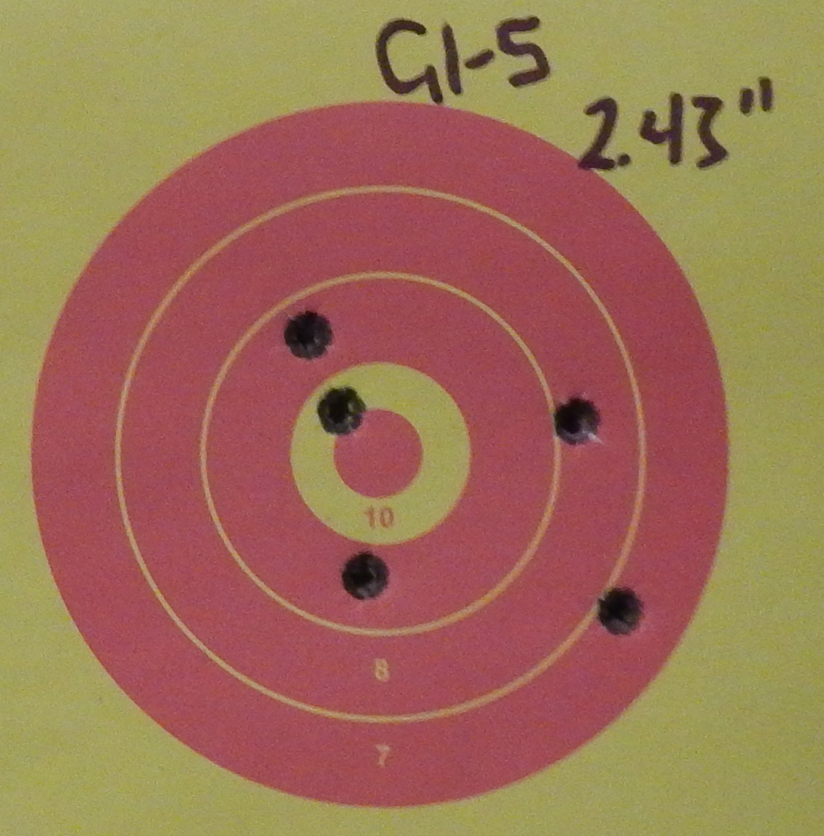

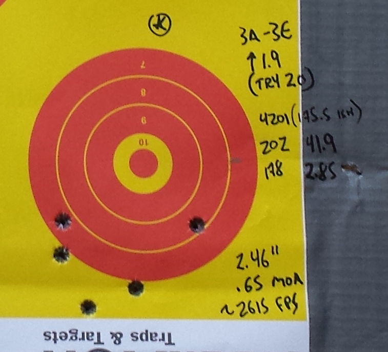

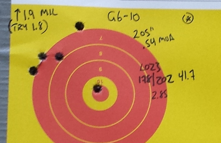

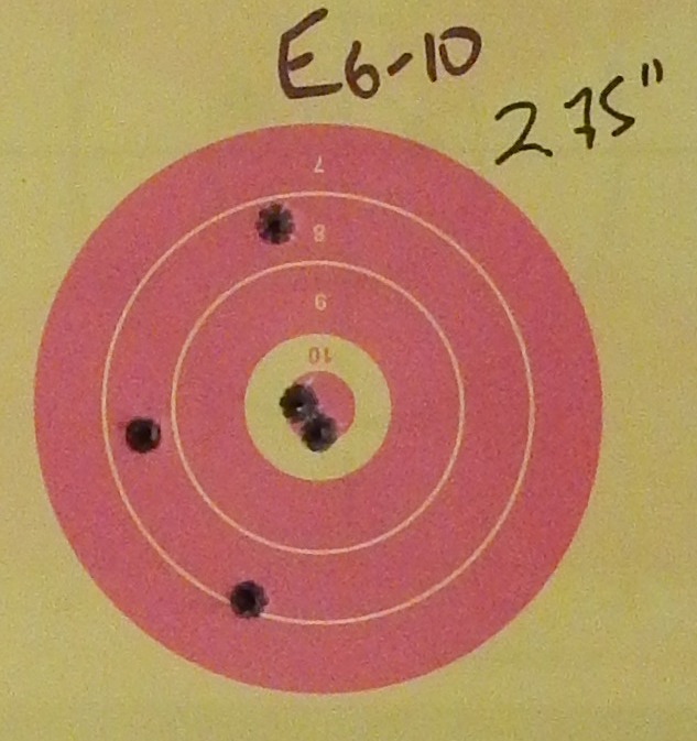

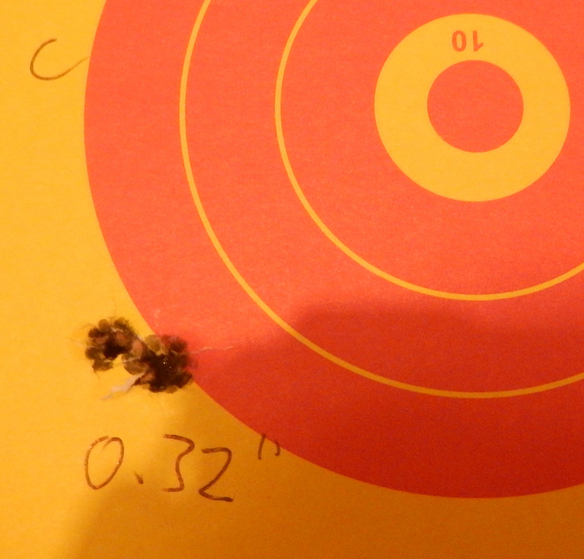

I was scrounging powder so I did a survey in my GAP-10 as well as my 700 SPS 26" 1-12, all with 178AMAX. Following recipes are for the bolt gun with 178s:
Fed GMM brass
Fed 210 primer
39.8gr 202
2.85 COAL
This is a slower load, only about 2500fps in my 26.
It stayed sub-moa as I went up in weight from 39.8 to 40.4.
40.3 was 0.3 MOA at 2515 fps, seated at 2.88
PLEASE VERIFY YOUR MAX LOAD, these numbers are for my rifle and could exceed safe pressures in your weapon.
I also had good results from 41.4 through 42.0, seated long (2.85-2.90 COAL). All groups at 380 yards:
41.6 in was .1-.5 MOA at 380 yards, MV 2600ish...picture "C" is 3 shots at 380yds. I've never been able to repeat that group! But G1-G5 is 5 shots of the same load a month later. *I shot a match at 1000 with 41.6 at 2.90 COAL and the bullets were stable (better than my 175s with 4064).
41.7 at 2.85 was .54MOA, MV 2600 (pic G6-10)
41.9 at 2.89 was .72MOA, MV 2600 (pic E6-10)
41.9 at 2.85 was .65MOA, MV 2620 (pic 3A-E)
back around June I moved on to other powders but looking at these numbers I'm thinking I had it pretty good with the 202!

Wow good info, thanks! I'm on my phone so I can't see the pics right now but those numbers make me feel better. I really appreciate the work, I haven't found that thread before either.
