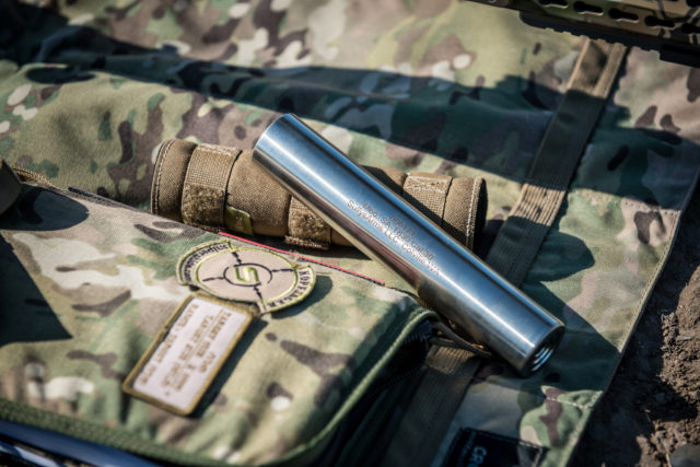

1. I am a fan of Titanium wrappers – light is right.

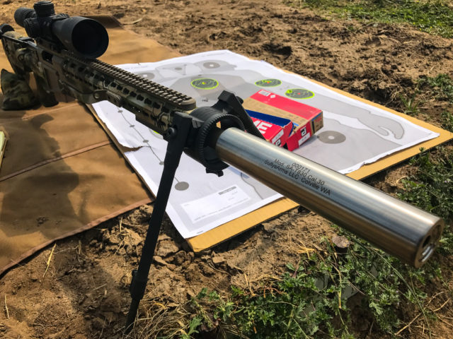

2. Quick Detach is not quick or particularly useful, consider a direct thread option for accuracy. Brakes tend to be the weak point in the application, just defaulting to a QD mount without doing your homework is ill-advised. When I have run into problems, it can usually be traced back to the brake.
3. You are hanging a weight off the barrel, the point of impact will shift so zero with the suppressor on or at least record the offset. The amount of shift is not always a reflection of quality. As long as the change is consistent, ignore it and move forward.
4. Sound suppression is secondary; a short suppressor can be very useful in mitigating noise and helps tame recoil. I am just as big a fan of a 5″ suppressor as I am a 7″+ one.
5. Embrace the wait! I understand it takes time for the ATF to clear your application. Don’t worry about the delay; once you have your first can, you will immediately see the benefit. Stand in line and get civilized.
6. Magnum Rating, it’s important to understand the pressure ratings when using a magnum caliber. Get suppressor that is rated to support the pressures. You can always step down. A 338 suppressor will work great on a 30 caliber precision rifle.
Switching a suppressor rated for one caliber and stepping it down to a different caliber is very common. You will not lose much in the way of sound suppression; in fact, it may increase when shifting to a smaller caliber. You can shoot a 308 suppressor on a 6.5 caliber rifle. You can shoot it on a 5.56 rifle. This is one of the benefits of a Quick Detach mount, the ability to move the can from rifle to rifle.
We can get very deep into the weeds with suppressors. From baffle design to welds, it’s all important. By choosing a quality product from a reputable company, you reduce the concerns. Don’t always focus on the sound numbers but the accuracy. If your rifle shoots 1/2 MOA groups and your suppressor opens that up to 3/4″ you are not doing yourself any favors. A quality suppressor should reduce the group’s size not increase it.
