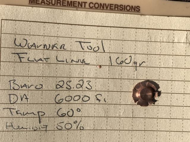

Conditions for the Day
Barometric Pressure (Absolute) 25.17
Temperature: 67 degrees
Humidity: 25%
Density Altitude: 6500ft
Wind 6MPH – 12MPH (over the course of the day)
