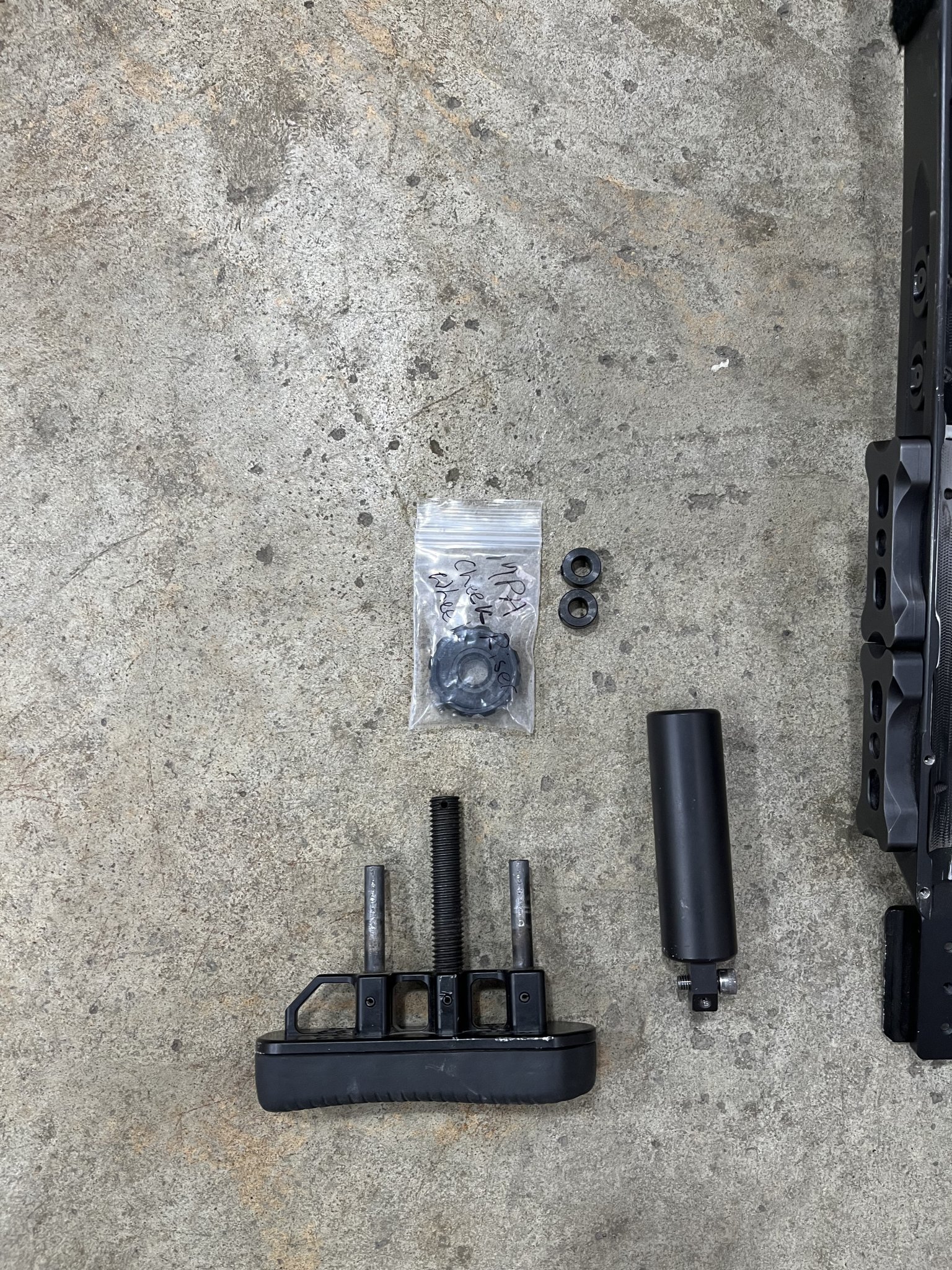

SOLD **Sold**MPA BA Comp Chassis with Weights and Extras.
MPA BA Comp for a 700 short action. Note, this chassis has not been a safe queen, has dings and scratches but still functions as it should.
I've cut the bag rider to fit the LOP recoil plate assy. to shorten my length of pull.
Everything in the pics are included.
