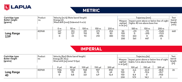

    Introducing: NEW .22LR rounds Lapua Long Range & Lapua Super Long Range
    Our Lapua quality has been around for 100 years, and today, we are proud to celebrate this milestone by presenting two new rimfire cartridges designed for ranges at 100 m/yds and beyond: The Lapua Long Range and Super Long Range, designed for those who are looking for the best of the best in extreme long distance shooting with .22 caliber ammunition.
    These rounds show excellent performance on targets at 100 m/yds and beyond, and are the perfect option for disciplines such as Long Range, PRS, rimfire benchrest and field target shooting. With a muzzle velocity of 337 m/s or 1106 fps, Lapua Long Range and Super Long Range come with a flat trajectory and improved wind performance. Both cartridges bring a competitive advantage to any top shooter, with the Super Long Range giving the very best group accuracy.

    Proof is in shooting the ammo, but if what Lapua is saying is correct, the Super Long Range will be very interesting. SKLR for my rig, the speed drops 83.5fps between muzzle to 50yd. Lapua is stating only a 74fps drop for their new ammo. That's quite a difference in speed when stretching out to a few hundred yards.

    Looking at Lapua website, same bullet weight and BC as Center-X and 33 fps faster. 0.1" less wind drift at 100 (for 9mph wind). Sounds like CenterX lot sorting and marketing, not a whole lot of improvement over CenterX.

    Someone help me understand the basis for claiming improved performance in the wind. While it seems logical to think slightly more velocity would produce slightly better performance in the wind, my ballistic calculators say that isn’t true of .22 projectile shaped objects (wonky things start happening at velocities approaching supersonic). For example, the same bullet/BC with MV of 1044 requires 0.89 mil of correction for a 9 mph wind coming 90 degrees from the right based on Hornady 4DOF application (my environmental stats obviously and RH twist). Keep all data the same, but increase MV to 1106 and you need 1.14 mils correction. Playing with the data, it looks like you would need to increase MV to 2600 fps to start improving the wind hold. I’m sure I’m missing something.

    The claim for improved performance in the wind is not easy to understand. Lapua says the ballistic coefficient is the same (0.172) as that for all other Lapua and SK .22LR ammo.
    According to Lapua's ballistic chart, in a 13 fps (8.86 mph) crosswind, wind drift at 100 yards is only 3 inches. (If the same figures are plugged into a ballistics calculator, the wind drift is greater at about 3.3".)
    Lapua notes that the 1106 fps was achieved in a 26" (660mm) barrel. Shooters should note that different barrels, even those of the same length, may have different MV's for the same lot of ammo. Bore characteristics may influence ammo MV as much as length. Some barrels will shoot this ammo faster, some slower, and some as expected. Unless the ammo is chronographed, it's MV can't be known.
    In addition, as temperatures rise, ammo MV will increase. For example, when temps rise 10 degrees F from 70 to 80, MV's can increase by 10 - 15 fps.
