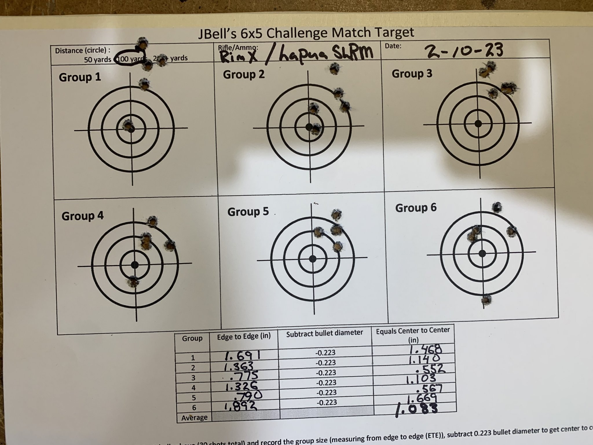

Shot it indoors this morning at 50yds and 100yds. Didn’t adjust my tuner from my setting that I use with my SK Longrange Match. Didn’t really impress me though you might be able to tighten it up some with the tuner.
RimX
Shilen Ratchet @ 24” with EC tuner
Nevius chamber
Razor Gen II
Indoors off bipod and rear bag.
Those don't look as encouraging as Kenny's video did. Especially for indoors.

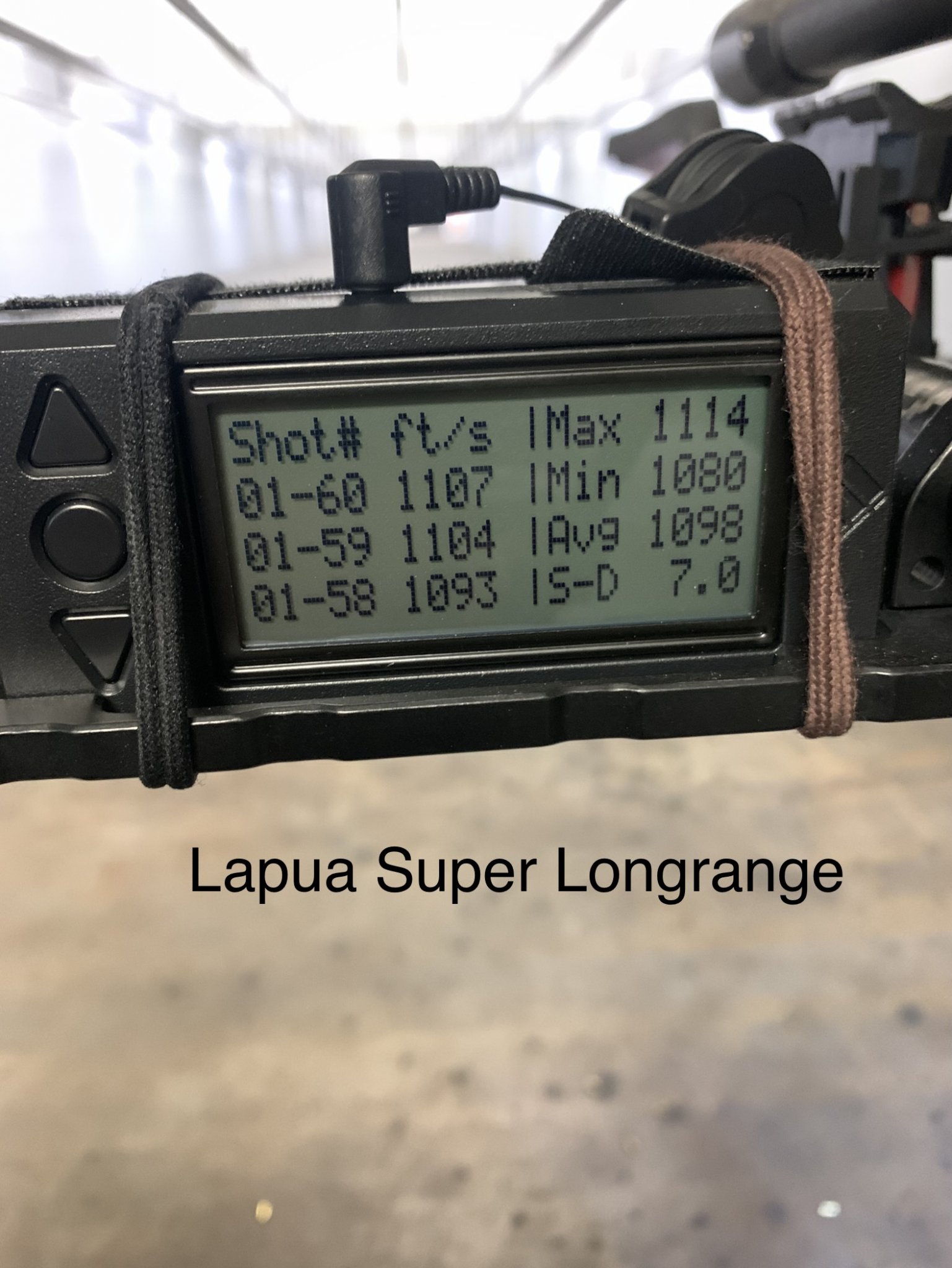

4 of the 6 groups threw a flyer that was always low of the main group and some of it could of been me, I’m a bit rusty but I took my time with every shot. This has a ES of 34fps . My SK Longrange Match has a ES of 26fps with 6x5 avg. Of .29 at 50 and .75 at 100yds and I think I can squeeze a bit more out with playing with the tuner but the SK Longrange Match is almost 1/2 the cost of the Lapua.
Thanks for posting this. The groups at 50m look pretty 'normal' (rather than extraordinary), as you mention. The SD is noteworthy at 7.0, however, and ES (at 95%) would be modeled at ± 28. The large sample size (n=60) here is possibly the explanation of the ES being a bit higher...at some stage...you are due those 5% fliers.
