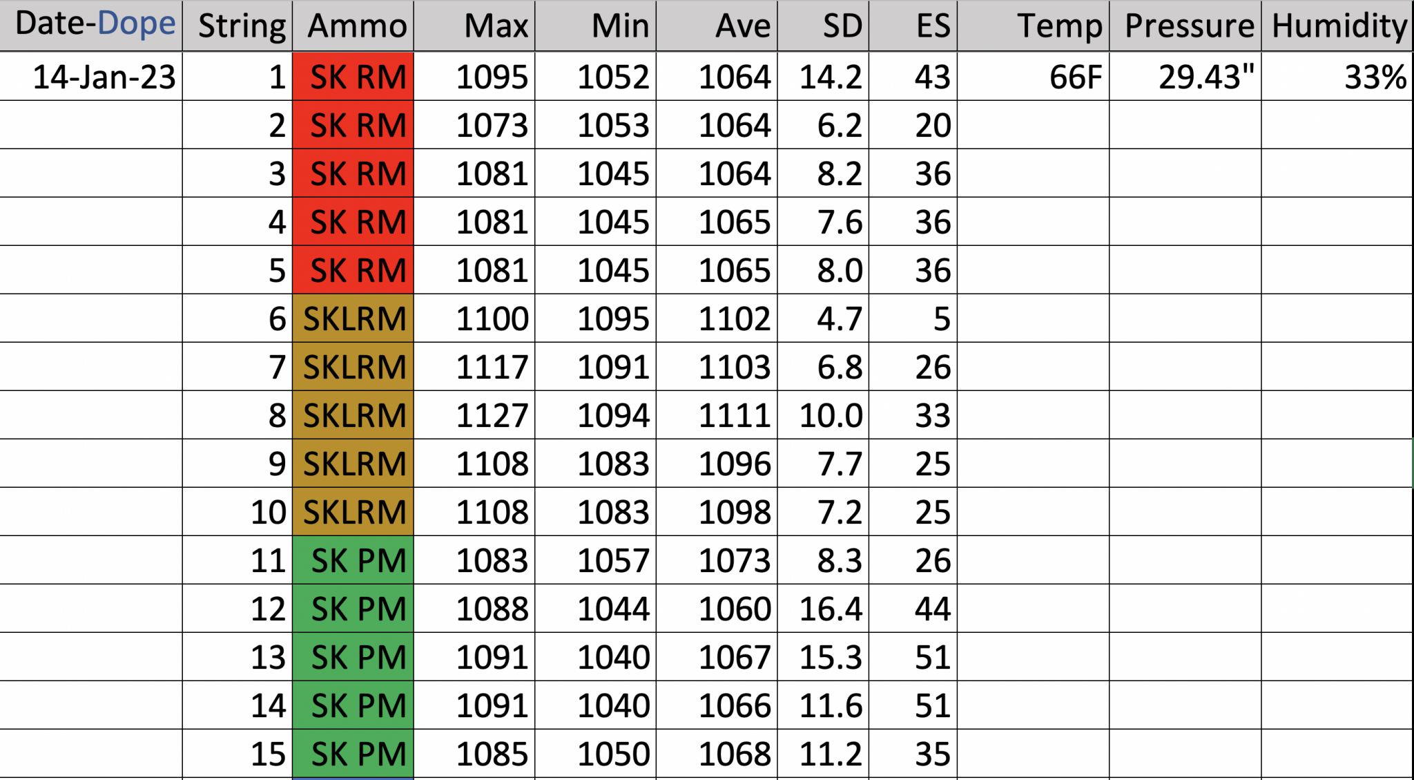

10 shot strings, Vudoo Three 60, 20" MTU 1:16. This lot of SKPM isn't quite as good as the last lot I had, but it's still ok, the lot of SKRM is much better than the last one I had...wish I had a whole case of this one, but I was only able to get three bricks, that's all the LGS had. I only got two boxes of SKLRM today, I thought he had several bricks in the back, but there were only 12 boxes and they were two different lots. That first string of SKLRM was MAGIC...then it went back to what I expected for SD/ES.
Reactions: BurtG
