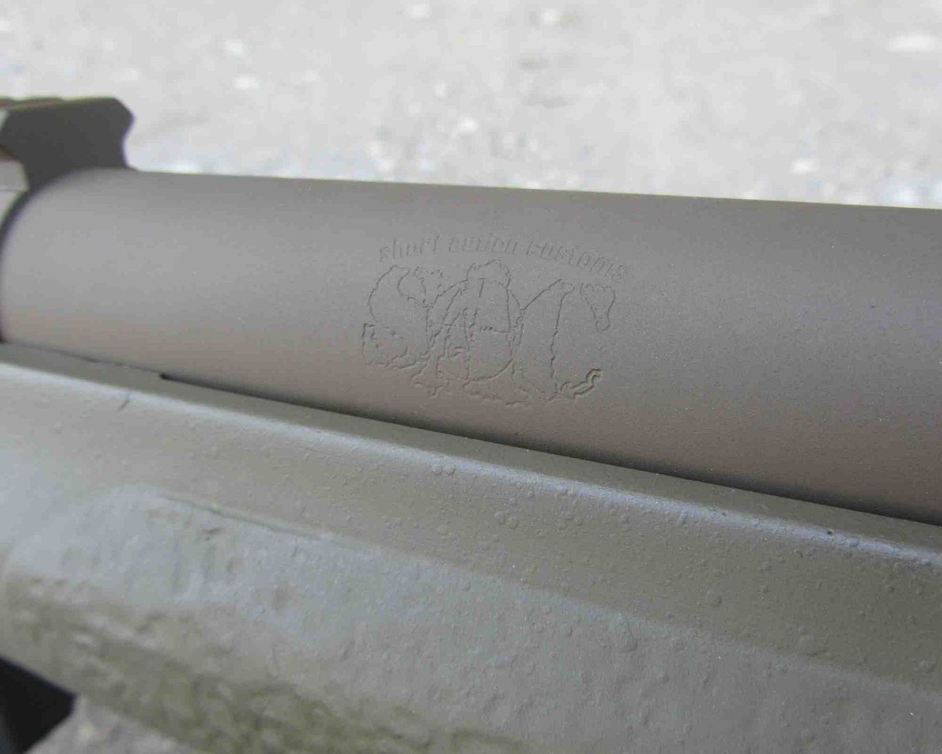

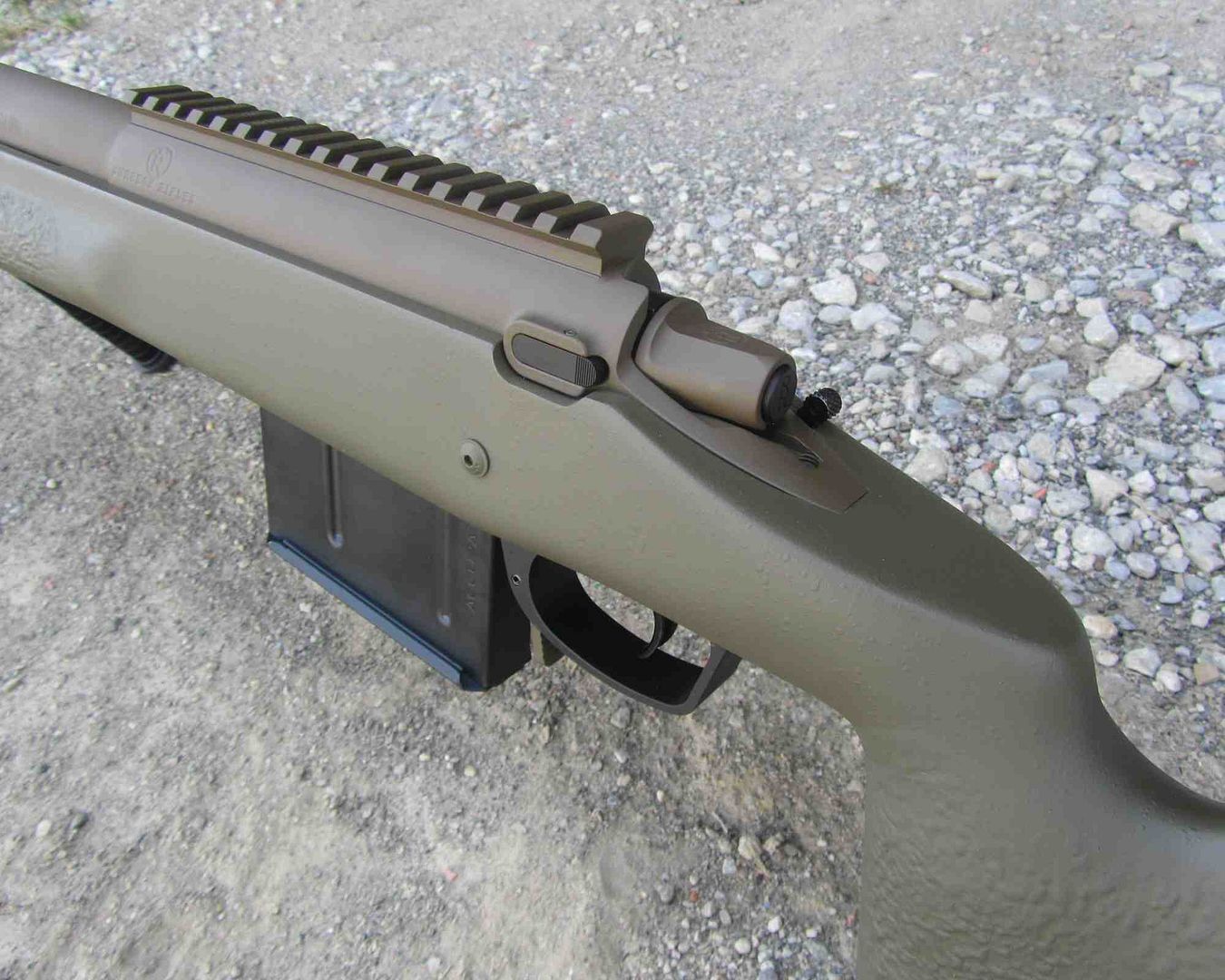

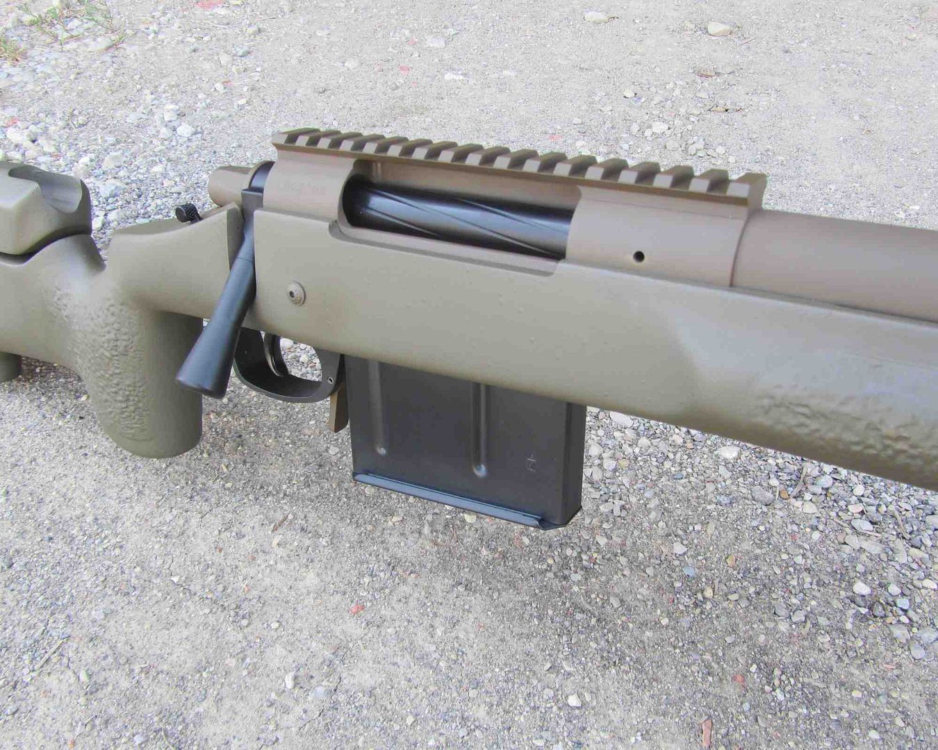

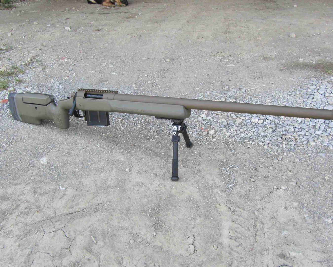

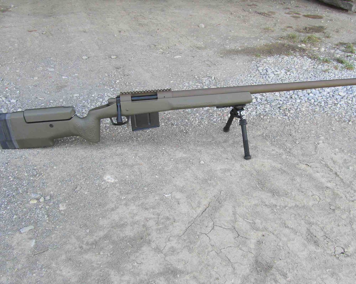

Shooters,

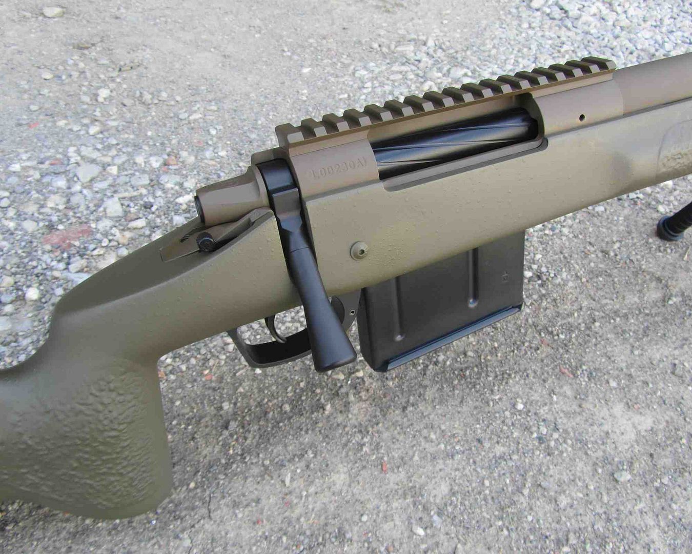

We just finished up another rifle this week. It was a customer supplied component build chambered in .284 Win. Everything turned out great on the rifle and we should be hearing shortly from the owner with a range report!
Here are the specs.
Surgeon 1086, standard bolt face
Krieger Heavy Varmint 1-8.7" finished at 26.5"
Manners MCS-T4A, Mini Chassis, Accurate Mag 300 Win Mag supplied.
SAC Standard .284 reamer
Skim Bedded
Stock blended/fitted
Patriot Brown metal with Black Accents.
Thanks for looking.

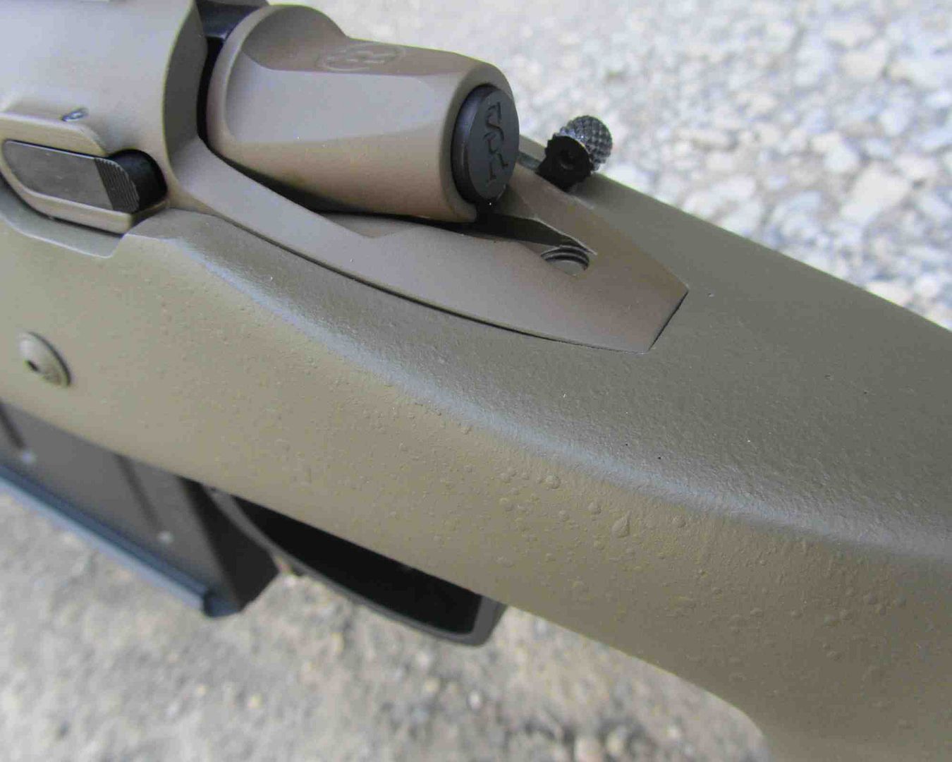

<div class="ubbcode-block"><div class="ubbcode-header">Originally Posted By: Brandon05_88</div><div class="ubbcode-body">Now the big question: do ya like it better than a Jewell?
</div></div>I can say that without firing it, I already like the
takeup and "feel" on the pad of my index finger better than the Jewell.

Thats a very well thought out build , the only mod to that I would do , is I would have used the folding version of Manners stock .
Very nice .
Later Chris
