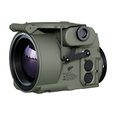

Well, it all starts with a picture... so here ya go! A video will follow shortly.
These are initial thoughts after playing with the Tig to learn it's capabilities and how it compares to what the US commercial customers have access too. They're not conclusive, but it's a damn good start!
Shuttered NUC: Some love it; some hate it. I’ve never had a product with this feature that I particularly liked for the fact that it always seemed to go off at the wrong time. Imagine tracking a sounder in Texas and having to pause while the getting is good before you engage your targets. Yeah, that was me. With the TigIR, it’s lightning fast and pretty dang quiet. It also gives you a short countdown so you know when it’s coming. Upon start-up the unit triggers itself multiple times which is my exact procedure with any of my manual NUC devices – this is a huge positive for me. Once the unit is good an warm after a few minutes, it does it less and less as you would expect. With four CR123s or two 16650s, you can last all night (remind you of the good ole days?).
Color Pallets: There are options upon options. With the FLIR I-Series 640 Boson core, you get all the options. I find myself using Black Hot these days, but it’s nice to have options for you particular types. You can enable and disable the color pallets you like within the menu which enables you to shorten your cycle times to find the option that best suits your conditions.
Collimation: This unit does not have a risley prism like most high end clip-on units. Not a problem. You can go through collimation procedures at every magnification level your heart desires (1x, 2x, 4x, 6x) with the exception of .8x, but that’s on Andres roadmap. .8x is less useful for me, but some may have a need. What are you giving up without a Risley Prism you ask? The ability to swap from host to host without going through a zero procedure. For those that have multiple firearms to use, rest assure, you can save up to 6 different profiles. The collimation procedure is simple with the four button layout and I found it very easy to manipulate. If you can read a manual, you can collimate this optic to your system.
Button Layout: It’s strange. There are four buttons on this unit, all of which serve great purpose and are easy to manipulate. The two buttons on the left (bottom button is #1, the one above it is #2), you can zoom, switch pallets, and increase display brightness. These are the primary buttons I find myself needing access to and they’re in a good spot for manipulation. The top button (#3) is hardly used, but useful during menu operations. The ocular side button (#4) is very handy in the event you break the objective lens cover on the thermal. It allows you to turn the unit on and off, or NUC. It’s also needed for saving menu items.
The Objective Lens: The device is engraved with 55mm F/1.0 which is very compact yet still able to do its job quite well. The objective cover when flapped down will cut the units power, and while in the up position it turns the unit on. No more finding small buttons with gloves in the pitch black to operate this unit.
The Ocular: You’re going to have a hard time looking through it as a monocular without a 3x rear end magnifier (we offer and stock them), but most won’t use this unit in this capacity. As a clip-on, you’re in the chips.
Mounts: This unit does not come standard with any pic rail mounts as per German export rules. This is resolved with a few additional parts included with every unit we offer, an EraTac mount and a plate bringing the overall optical center to 1.5” with a 38mm mount. Additional mounts can be had in several flavors: 36mm, 39mm, etc., as well as Bell Mounts in 50mm and 56mm as an example. We’re working with the manufacturer to bring additional options for the guys running NV capable red dots with magnifiers approaching the 2.25” optical center height. Other options may be available based on demand. Let us know what you need. Additionally, the display (see below) has the ability to shift within the viable pixels up to +/- 3mm. This means if you typically run a 1.5” optical center and a 38mm mount, you can get away other host systems that have a taller or shorter optical center. 34mm is the lowest mount made today, and that would net you a 31mm height at the lowest possible display setting. In order to achieve 50bmg recoil ratings, they cannot make a shorter mount with the existing pic rail option.
Power: This unit will run on four CR123 or two 16650 rechargeable. We have not yet tested if it will run on two CR123s or one 16650 rechargeable batteries. There is also an accessory cable which plugs in easily to the Tig which allows for external power.
Recording: Just like the external port that allows remote power banks, there is an accessory cable and DVR that allows you to record what the TigIR sees. It does not allow you to see any reticles internally (it doesn’t have them anyways) or externally with a day scope since it does not see through the day scope lens. If you’re looking to perform long range recon or record your guns from a tripod, this unit is ideally setup for that.
Fixed Focus: Yes, it’s fixed, albeit, at infinity. This means you will have usable images from 25 meters to beyond. If you find yourself needing this unit to be short range capable, it will of course work at ranges, of say, 15 meters, but the image will be a little fuzzy.
Display: This sucker has a large for core OLED display meaning you have more pixels to work with than the core is capable of pushing out. This offers you a cleaner image compared to comparable 640 cored 640 display units.
Weight: The naked unit weighs 1lb 2.9oz.
Size: It’s tiny. You only need a small amount of rail space to leverage this optic as a clip-on compared to other competitors which are significantly larger. Images of sizing will be posted shortly.
Packaging: The optic comes with all of its documents, batteries, and lens cloth, packaged inside of a nice plastic hard case with what appears to be water jet cut foam. It fits like a glove. There’s room inside to carry spare batteries too and mounts.
Negatives:
  • Regarding Warranty, Strictly Offensive Kit will help facilitate your unit getting shipped back to the manufacturer should you have issues. What we know thus far is these things were designed to be 50BMG rated, but we cannot say a SCAR17 won’t eat its lunch. I would advise against putting it on a SCAR as I have first-hand experience of what it can and will do to a thermal clip-on.
  • No Risley Prism. Having several clip-ons that have this technology, and now using the Tig without it, it doesn’t bother me much, but you will have to go through a collimation procedure which is quite simple.
  • Doesn’t come factory with a mount, only the 6M does. This is due to German law. We are still able to provide the exact same mounting solutions despite it not being packaged with one.
  • Shuttered Auto-NUC. Depending on your use case, maybe it’s a detractor, and maybe not. Regardless, it can be turned off in the menu. Its lightning fast and I tend to like the feature.
Positives:
  • It turns on when the objective cover is opened and it auto-NUCs itself as part of its startup regiment. This is a positive for me.
  • Weight and size. It crushes the competition. In fact, there is no other unit that is even close in class based on price, features and value. It was never a fair fight.
  • Rechargeable batts!
  • Loads of pallet options with the ability to turn desired pallets on or off so you don’t have to cycle through them if you know they aren’t your speed.
  • Minimal rail space required to mount.
  • Flexibility for different mount height options, or even bell mount options.
  • Half the price of a UTC-xii, 2/3rds the price of an LWTS-LR
With some closing thoughts, having used thermal clip-ons for years, and living by the Risley Prism is King mentality, this is the first unit that absolutely blows me away with its capability in light of not having it. Comparing it to my UTCxii, it’s about 90% of the image quality, less than half the cost, and has loads of features the UTCxii could only dream about. Not having to deal with NUC’ing a device is turning out to be an amazing feat, and being able to protect the objective by closing the flap and also preserving battery life (because it turns off) is game changer (ew, I said it). If you’re in the market for a device that’s a decade newer than its nearest rival, look no further.
In summary, we are very pleased with this unit’s capability and feel we are just scratching the service on its capabilities. There is still a lot to be learned and we’re leaving that opened ended until we have significant time behind these units.
We have spots available on our waitlist and are not charging in advance of receiving these units. ETA is end-of-June, but the sky is blue and we see a path of having them much sooner than that.
Link to Product:
For you social media types, we plan to release more content, video, photos of this sucker via Instagram: @strictlyoffensivekit. We'd appreciate your feedback.
Questions? Feel to ask here or contact us directly.
Cheers,
Preston
214-744-3589

Steps to rifle mount tig-IR 6z+ thermal clipon
1 - Afix mounting plate to bottom of clipon. 8 tiny screws, torque to 15 i/p. Used 36mm plate. Also have 38mm plate.
2 - Afix mount to mounting plate, 2 larger screws, torque to 20 i/p
(I made up the torqueage as I went along, but sent in questions to andres regarding torquage specs, will update based on data received)
3 - Mount clipon to rail in front of day scope.
All seems nice and tight.
Next, will wait for sun to go down, then will collimate clipon to day scope. Day scope is in sphur 34mm center mount.
Summary of last night's activities:
collimated Tig to L&S mk6 3-18x T3 on bolt gun per above pic.
Started at 11yds.
Target was 12x8" alum foil, shinny side out.
First rd was 8 inches low 4 inches left. POA was center of alum foil target
Went in and adjusted down (thinking it would move POI up) by 4 clicks, fired, enlarged hole. Adjusted down 4 more clicks, rd impacted below ragged hole.
Went up 16 clicks and right 8 clicks. Rd was low but centered on center of target (I could see the impact points, they were hot).
Went up 16 more clicks and was about 2 inches low.
Went to 25 yds, impact made ragged hole with prior shot.
Went to 50yds, impact now 1 inch low.
Went to 75yds, made ragged hole with prior shot.
Added 1x1" piece of electrical tape to center of target. First two rds at 100yds, both hit within .75 IPHY on the tape. I called it good. This was on 1x digital magnification in the Tig. Pressed "4" (the save button backing out a saving each step of the way.
Then did some looking around, could see cows out in pasture to the North 277yds and could see deer on hill to SW 164yds, etc.
Will go out again tonight and focus on side by side pics with Tig, UTC-320 and UTC-640 (aka UTC-x).
FYI, I talked to @Night_Assassin last night. He tried the no shooting method of collimating the Tig, maybe he can come in here and share his experiences with that. I'm "olde school" so I used the shooting method :D
I did a mixture, at first I saved after each adjustment, for the first 2-3 shots, then I said, "Hecque, I don't need to do that" and just kept it on the adjustment menu as I fired and shifted positions, etc. So probably last 5 or so shots no save until end.
So as Wig mentioned I was using and getting the Tig dialed in last night also. I’m a left handed Pollock so I do things differently.
My tactic was I set my rifle in my tripod and locked it in place on the target. Knowing my day scope is accurate I put it on the center of target.
Put the Tig on in front of scope and adjusted the image until it was centered on target.
I only saved my settings on 1X as that is where I’ll mostly use this and use magnification of day scope to allow (holds) to be accurate.
So far I’m very pleased with the Tig.
it can handle about 10X in my opinion, maybe 12.
Last night it was raining so I’ll be testing more tonight.
I will add how impressed I am on one other thing ..
So most of my rifles are in a 1.5” mount, that is what I zeroed the Tig on.
It was lined up perfect with the scope .
I decided to put it on my .22 that’s in a chassis and it is lower by a lot.
Say 3/8” lower .
I mounted it knowing it was high but let’s try it .
Using the same settings from my center fire on the Tig, dialed my dope for 200 yards on the rim fire , 7 Mils and impact on a 66% IPSC first try.
Very impressive.
Here is a pic of the offset

Other aspects of the unit that stood out, compared to my UTCs I was running side by side:
a - Tiny size of Tig, 4.5 inches long. The smallest clipon of any sort I've used so far.
b - Very fast start up. I didn't time it, but by the time you start a UTC wait for it to load and the do the first manual nuc, I'd guess its about 6 seconds. The Tig seems like sub-second. Very fast.
c - Uses 16650 batteries which I was using, and I ran it for about 8 hours before I got a "blinking" battery light, which I think means, we are loosing voltage. I plan to use it until it shuts down, to go thru the whole cycle.
d - The positions of the buttons are different from any other unit I've used, 2 on the left side, one on the top and 1 on the back.
Working on memorizing which buttons to what and best way to postion my hand for each. I'll just say I'm working thru the learning curve on the buttons !
e - The menu items are very intuitive and well documented. Even though the manual was translated from German, its short and helpful.
I will continue to test the unit at least for the rest of this week. If any questions, please ask.

Shortly after the above image of the cow, the Tig finally died. Got about 8.5 hrs of runtime off the two 16650s.

What is the FOV of the Tig unit? Also when power off does it convert back to default settings or does it stay on current settings (brightness/contrast settings, auto nuc on/off)?
8 degrees horizontal
Settings are retained from power off/on
This is the only thermal I've ever had where I haven't turned off the auto nuc. I HATE autonuc ... I probably sold the LWTS-LR primarily because it would NOT remember that I turned off the auto-nuc (you might even remember that :D ) ... but .. the autonuc on this one makes no sound and happens so fast you are only aware of it if you wait for it.
And you can still manually nuc anytime you want.

Some clarification on Tig....
Image size doable for viewing from rear end for dedicated spotter role? I.e not like UTC
Can this unit act as stand alone? If so reticle type....First focal? Mil based?
... Image size doable for viewing from rear end for dedicated spotter role? I.e not like UTC ...
Tig is a clipon, like the UTC, demaginified on the rear. BUT, there is an available 3.5x screw on magnifier that fits back there to enable use as a spotter.
... Can this unit act as stand alone? If so reticle type....First focal? Mil based? ..
Negatif, euros don't allow themselves to sell thermals with reticles commercially.
