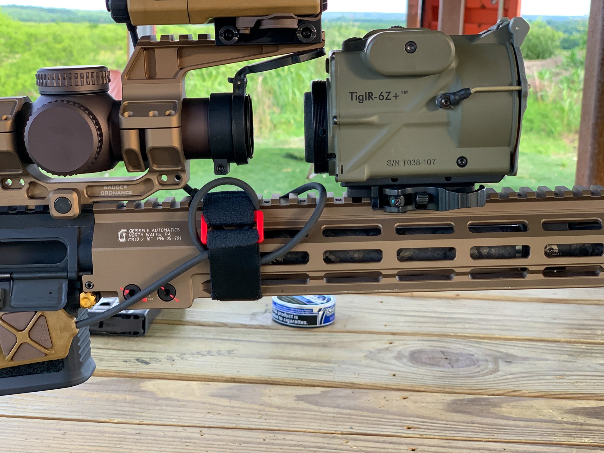

Last night had some issues and ran out of time recollimating. Don't like to zero/collimate after 10pm. A shot or three for critter control or outback for long distance is fine, but need to finish recollimating first.
Did talk to Jay today on the phone. What he does, as just an example. He collimates at 100yds on 1x. Then on 2x at 100yds, if his hold would be 1 mil at 300yds, then he collimates to where he's hitting 3.6 inches high at 100yds, etc. That's Jay's "trick".
So then in the field, if he shoot a yote a 100yds on 1x and the partner retreats to 300yds and stops to look back, he pushes the 2x button on the Tig and he's ready to shoot, he just dialed his DOPE for 300yds.

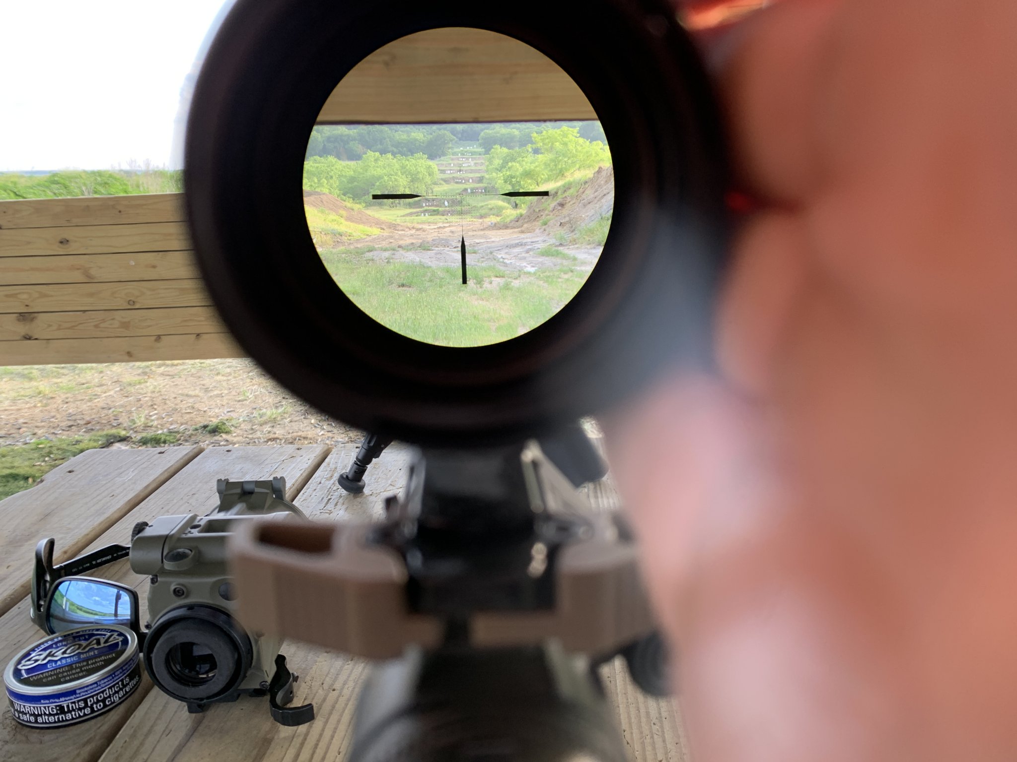

Ok, collimation issue I was having resolved last night - it was "operator error" :D
So, collimation procedure complete and ready to go try some longer distance shooting and observing tonight!

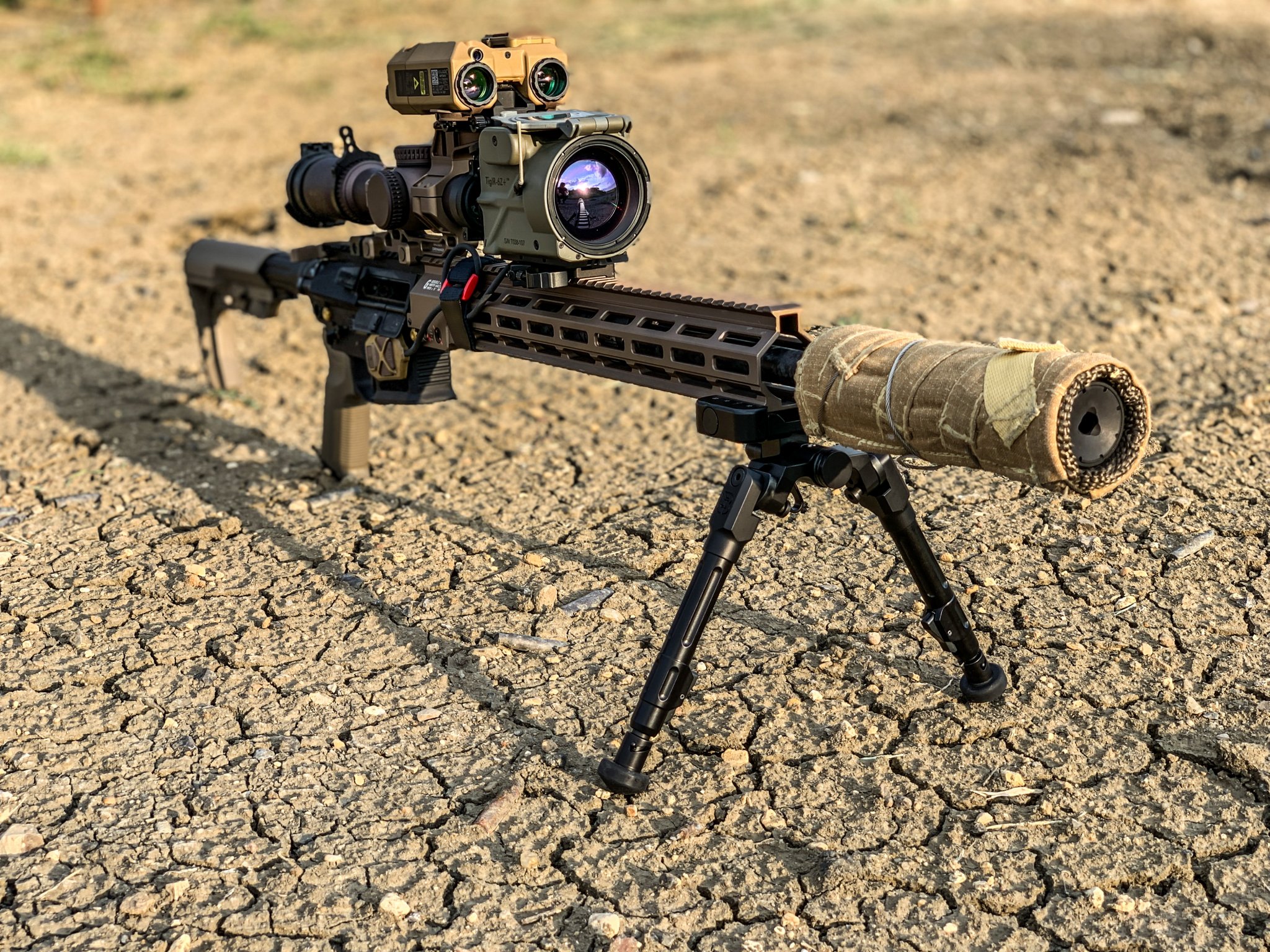

So, had 7.62(22) with L&S mk6 3-18x T3 and Tig. FGMM 175gr RRS, 4-wheeler, helmet with skeet and 14 and kestrel. Radius on the rifle. Propane torch.
Rolled out to target area and heated up a target. Then rolled to FFP at 300yds (308yds by the radius) and setup. Used the "hot" filter. Had the Tig on 1x digital and the day scope on 4.5x. Fired and got a "ping".

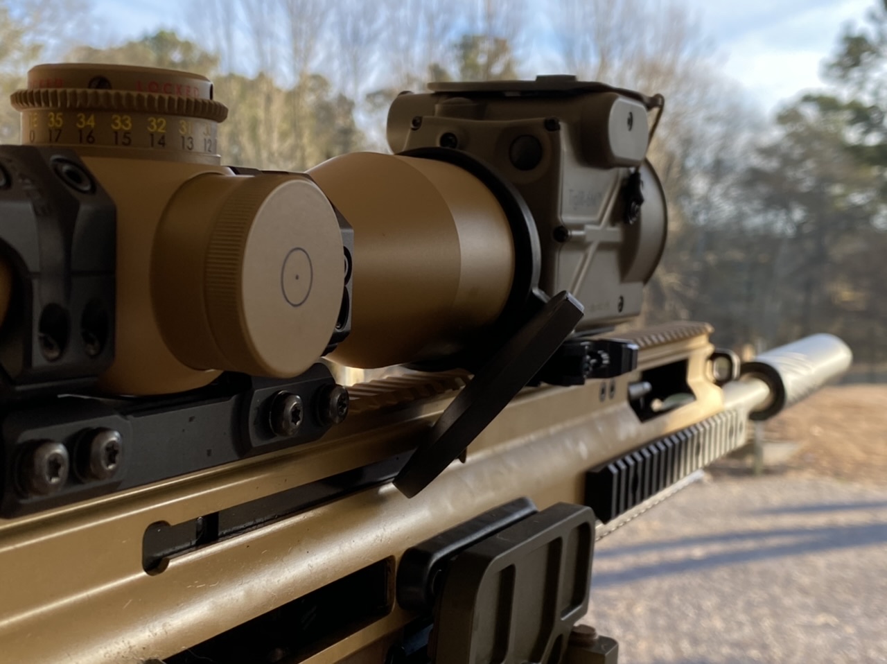

Got Tig collimated last night on the mk12 at 100m. Collimated the Tig on 4x. This mk12 has L&S mk4 2.5-8x TMR.
The L&S remained and will remain on 2.5x optical. I'll flip the Tig between 1x digital and 4x digital (collimated to shoot on 4x digital, i.e. net 10x magnification) out to 457 meters (500yds). These turrets are dual marked for BDC and MOA with 1/2 MOA per click, so 11 clicks up is indicated for 457 meters (I'm gradually switching myself over to meters. My brain was meters from the Army when I first started shooting scoped rifles 9 years ago, so got my brain switched over the yards during the past 9 years, now switching back to meters :D
Using IMI 77gr ammo, since I still have about 1500yrds left. When I confirmed MV I got 2698 (versus 2700 I already had in the BC) and SD = 13.5. The final group size with the Tig last night was 0.5 inches(8/16ths I measure group sizes in 16ths since that's what my tape measure is in) (from 100m) so with the combination of 4x digital and 2.5x optical, I'm able to get decent precision off the tripod, so that bodes well for possibility of going beyond 457m tonight.

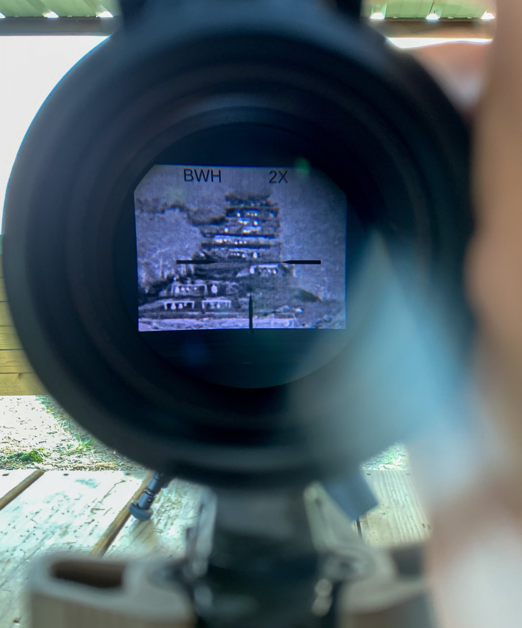

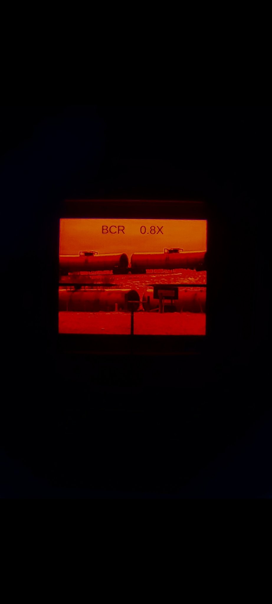

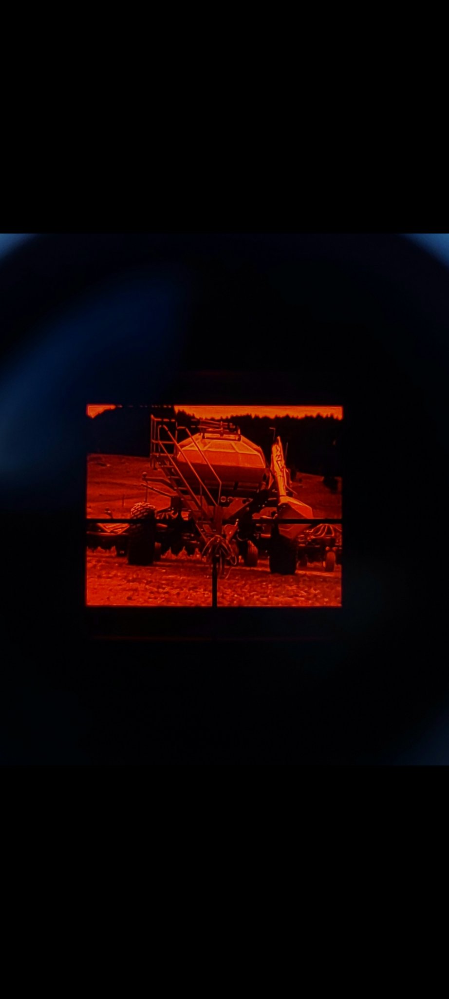

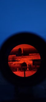

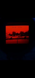

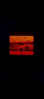

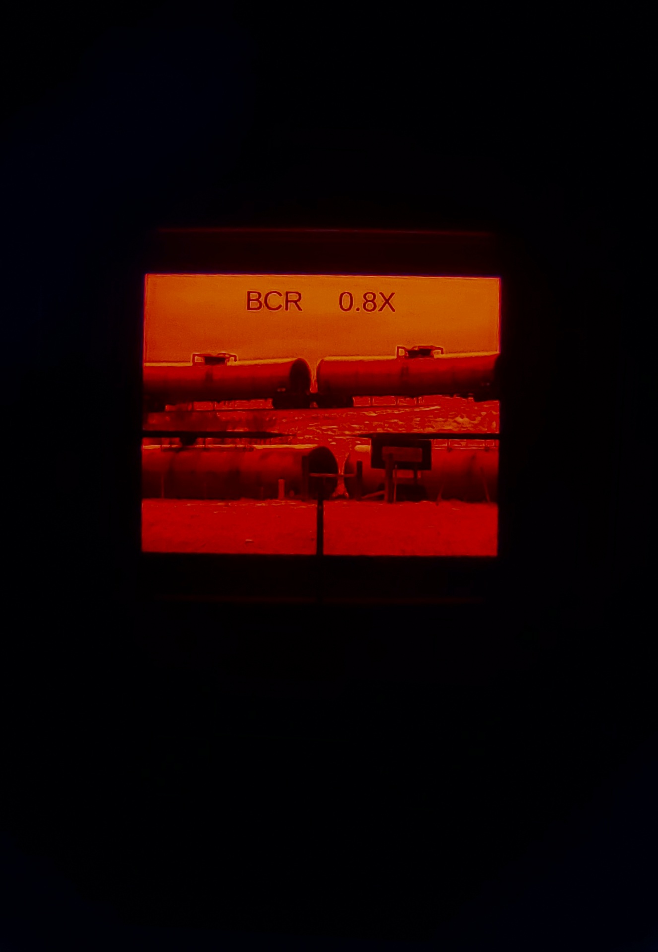

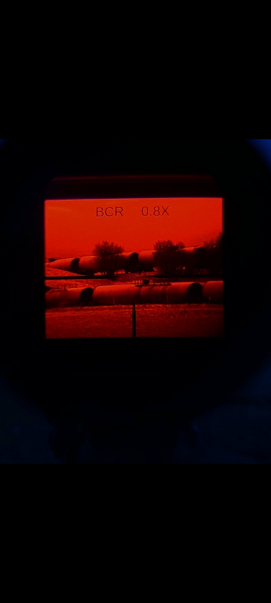

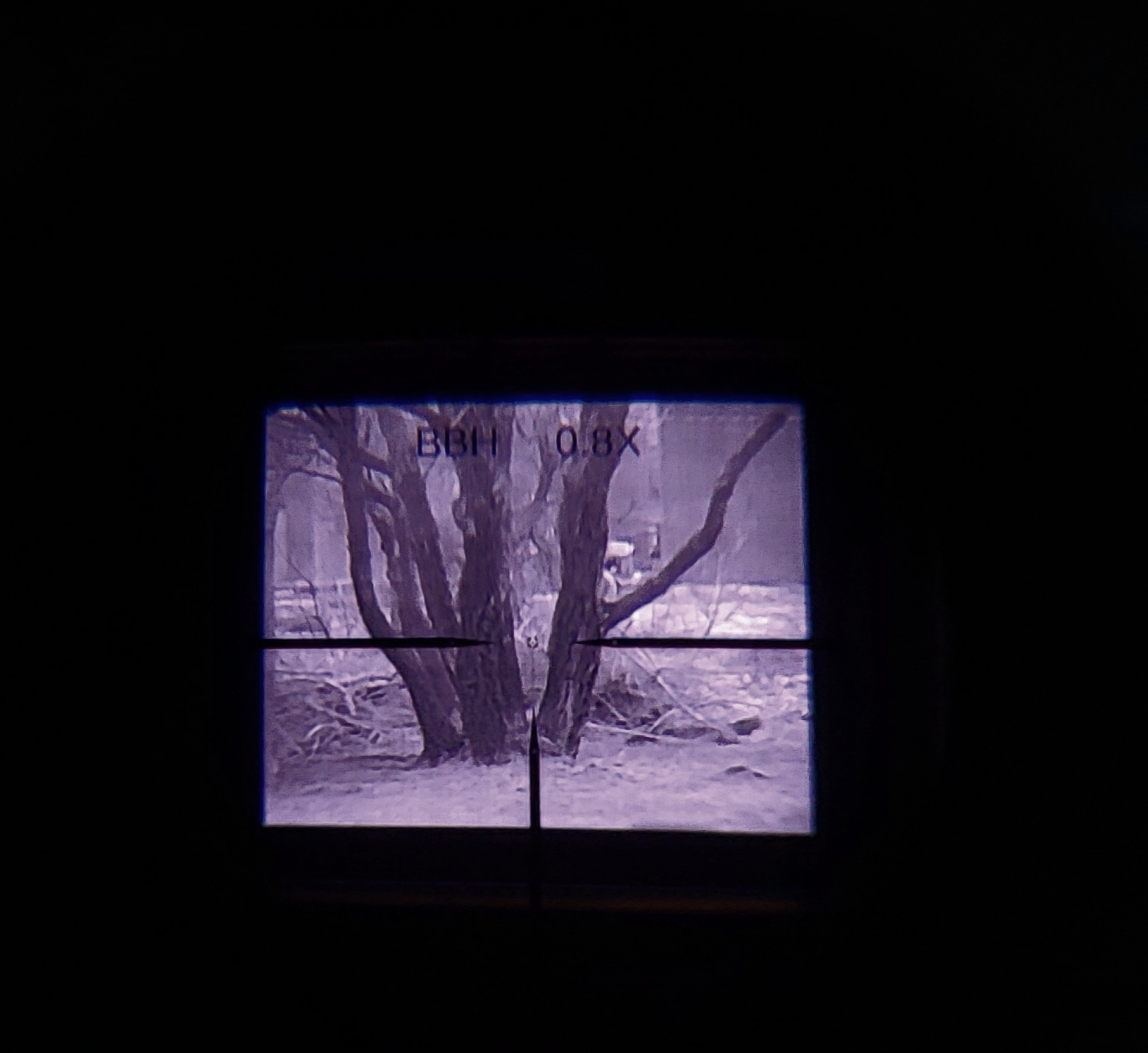

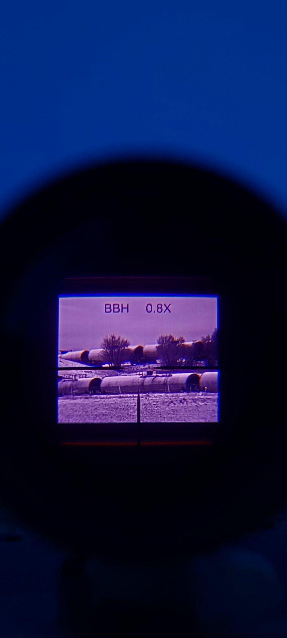

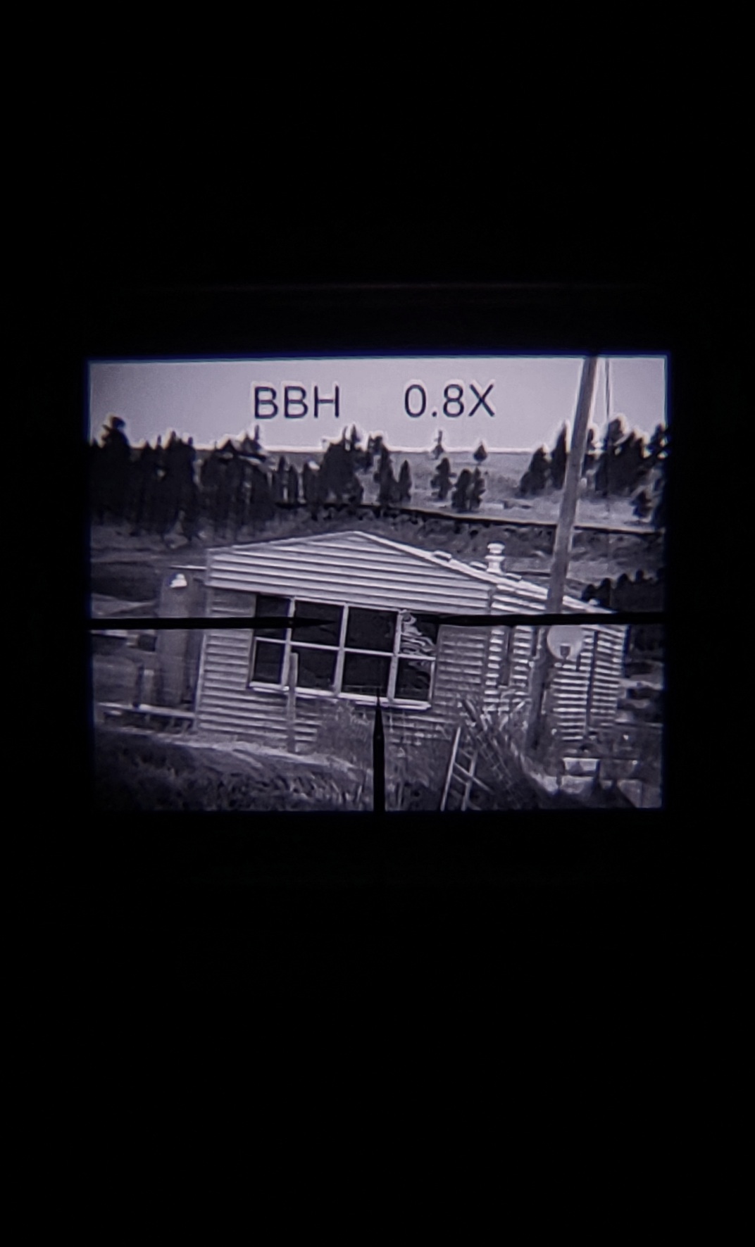

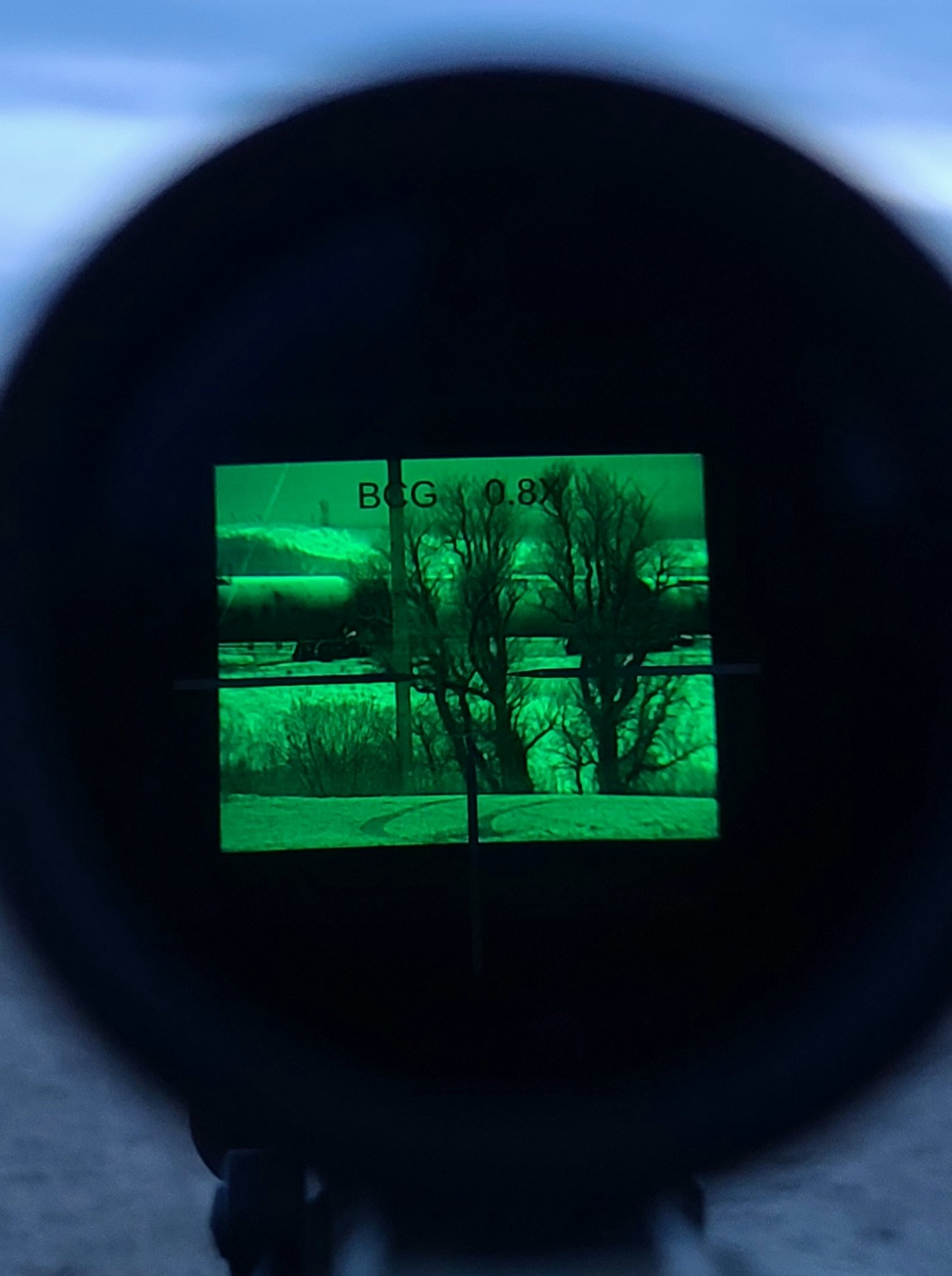

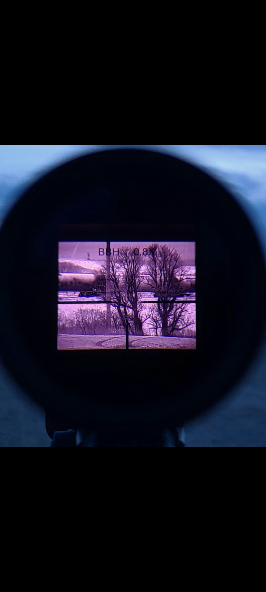

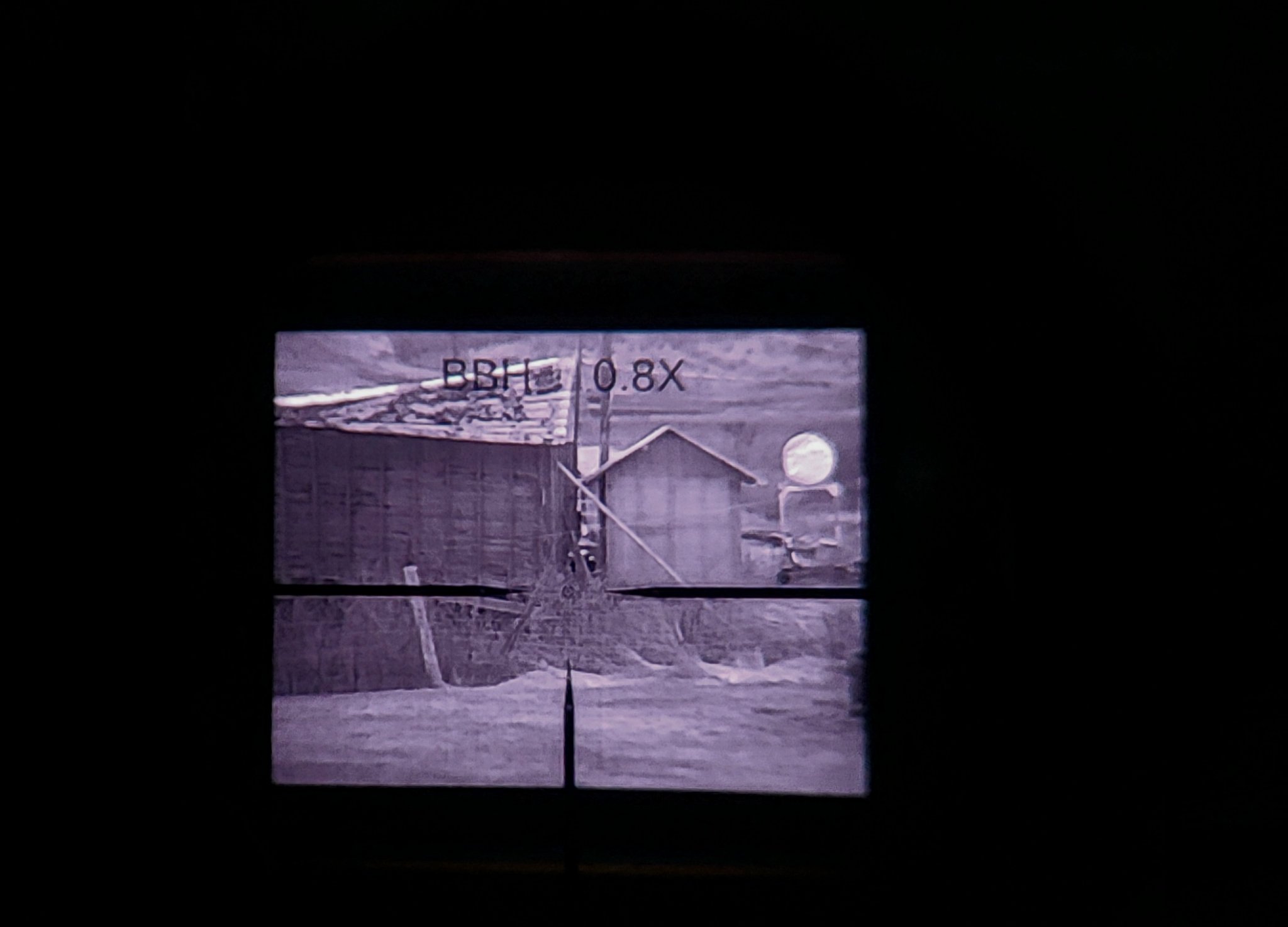

Got to play with mine last night and found out how to optimize the image. The images are a little blurry (because taking photos behind a day optic feehand isn't the easiet), but I'll try some more. The past 3 days have been a mix of snow and rain without sunlight...so pretty much abysmal conditions.... and this little unit still shines bright. I'm quite impressed.

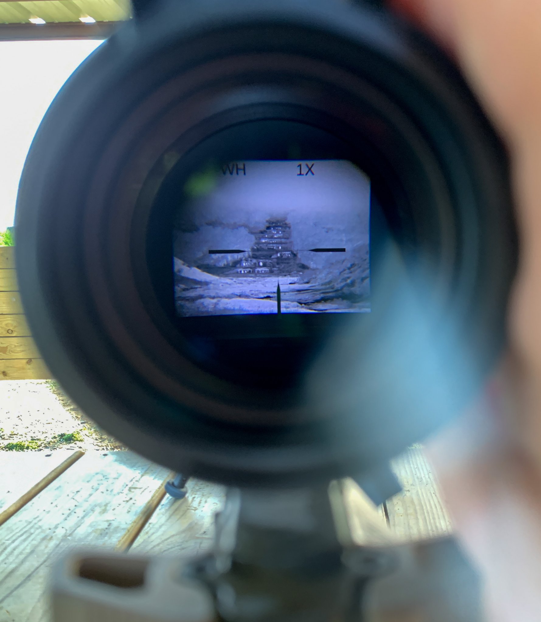

As usual the real image was way better than this pic. My new Kyocera phone is IPX68 (why I got it) but the phone cam is the worst I've ever had. Life is full of trade-offs.

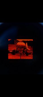

To add, here's some ambient-temperatured items I took last night. Mild sun with moderate cloud cover, 55⁰ F midday then dropping down to mid 30's at the time of this picture. Building was around 60 yards away. 2.5x optical magnification and 0.8x digital. Had some deer at about 150 yards during the capturing of this picture, but they moved off before I could get them in this photo. Going back tonight to take more images...bonus is that the thermal conditions are MUCH better today.

Took some more images through the Tig tonight. The thermal conditions have been very ideal the last couple of days and finally got to capitalize on them to show you all the max potential (image wise).
One thing I have found out per say, and Wig can corroborate, is that this unit looks fantastic within about 300 yards. The images are sharp and very, very smooth. I would say that it out paces the UTCx within this distance in raw processing power/display.
However, the major downfall is that PID past this distance is a slight challenge, due to the fact that it doesn't not possess the option of enhancing the sharpness. Surprisingly, this is the first fixed focus thermal I have played with that lacks the option for a manual digital sharpness adjustment, and it really hurts the unit when you get out to distance for identification due to this softer image.
Wig and I have hypothesized that the developers wanted to eliminate the possibility of seeing pixels, but that comes at a detriment to PID at distance. Now granted, I can still identify deer at 1000 yards, but making the distinction between a coyote and a calf would be very difficult at that distance.
On a positive note, the color pallets at least have a "boost" setting that slightly enhances the image sharpness and contrast, giving more detail at distance. You can also lower the brightness, which dramatically improves the image. Also, I have found that I prefer the "CR" and "BCR" color pallets to be my pallets of choice, by far giving the best image quality over even traditional pallets such as black/white hot. Typically color pallets outside of the gold standards are gimmicky/useless (anyone with an appreciable amount time behind a thermal knows this), but not with this unit (they still have useless ones, but they can be toggled off at your leisure).
It's light, user intuitive, and build like a tank, but that lack of fine image focusing is my biggest disappointment by far. This could easily be remedied by updating the firmware to include an option in the image menu to enhance the sharpness (hopefully we can convince them in doing so!). This unit is close... so very close to perfection that it physically hurts me.
But anyway, here's some pictures that at least come close to representing what is seen through the optic. For reference, the day optic is a NF ATACR 1-8x24, and the zoomed in image is at 8x optical magnification.
You provided pictures of the BCR color palette that you favor. Can you provide some photo's of the CR Palette you also favor.
With the Flir Thermosight PTS line I have found that the Arctic Palette is by far the best for longer range PID and also the best that provides excellent contrast between a live animal vs terrain. Arctic provides a much crisper outline of the animal via a very defined strong orange outline and then fills in the body of the animal in a iron hot glowing white/orangeish color. The algorithm is written such that you have a lot less pixelation in that Palette.
On, my side, I confirmed collimation with the Tig back on 1x on tig on the bolt gun last night, so I can try to push beyond 500yds on steel tonight. I was dead on for windage but a tad low on elevation, I clicked up one click and group was centered on the handwarmer.
For shooting I'm using BWH as that gets me a lot of contrast and I can see the reticle easier. I've actually been using the illum on the reticles. Both with the L&S mk4 2.5-8x TMR on the mk12 and the L&S mk6 3-18x T3. Since the targets have been hot, they're white and with the red reticles everything shows up well.

Mounts: When I originally took receipt of the first units, I was still waiting on the mounts to ship, and rather than being patient and waiting, I put the Tig in a RRS Vyce and threw a NF 2.5-20 on a RRS surveillance kit. The kit allows you to manipulated the optical centers to get them in near perfect alignment to my, as Wig say, Mk 1 Mod 0 eye-ballz. Having since taken it back in hand, I wanted to learn me a bit about the unit, and so I re-read the manual (lol, right?), removed the 36mm mount and replaced with a 38mm mount to began testing.
Scopes Tested: S&B 3-27x, Hensoldt 3.5-26x, S&B 5-20, ATACR 8x, Vortex 1-10. All of these optics are mounted at 1.5", 1.54" or 1.65". The best performing optics were the LPVOs sitting in the 1.54" Badger Condition One mounts. My estimation is that the higher mag optics have considerably more glass lined up inside the housings that it distorts the image and takes away from it's crispiness. None of the optics are slouches, and I'd say it will require further testing, but so far, the LPVOs went 2 for 2 with different weather conditions.

Optic between 3-4x and Tig on 1x. Not using the Boosted WH pallet noted by BWH. This is my local range with steel starting at 361y and pushing out to 1170y on the very end. The cross hair is aimed between the 561y and 666y berm. The steel was heated by the sun alone, and as you can see, it was very much sunny and 88F. I was shocked to see the steel so blatantly without applying any supplement heat via a torch. I have done this same test with a UTCxii, and it wasn't even close to this. Difference in BAE and FLIR? We'll let the scientists sort that out. The IPSC is full size at each range per my knowledge. Did not appear to be 66% or smaller.
Same as above, but now at 2x digital. The Zoom and Pallet button are one in the same. When I bumped it to 2x, I held the button too long and instead of magnifying, it moved from WH to BWH. So I had to hit the button again to push it to 2x.
Height over bore is 1.54" on the Vortex 1-10 and 1.5" on the Tig. Close enough for government work. Not, the Raptar clear the Tig perfectly.
Pic of the same range but through day optic between 3-4x. I had to use my ole hand to block out the sun or else the camera wouldn't pick up any of the pics. You can see a slight glare in each photo because of this.

I've used with a couple of ACOGs, TA01 (4x) and SDO (3.5x) and yes it works great. Stokes has used with Elcans and works great with them as well. As near as I can tell, Tig was design optimized for Elcans.
Reactions: WhereNow&How
A previous model they made was actually designed (I assume for a specific end user contract) to attach /directly/ to the ELCAN DR.
images
And similar power optics are on mil rifles all over. So if not that specifically, then something like it at low power almost certainly as the design intent, like this (Hensoldt ZO) the TIG was demoed with.
I've used several clipons in several ways, with magnifiers down to 3x. Works fine. Varies from one to another, but somewhere between 2.25 and 2.75 is where the ones I tried start falling apart. I assume both clipon and FOV of the day scope matter, but 3x always seems a safe bet to make them work IME.
