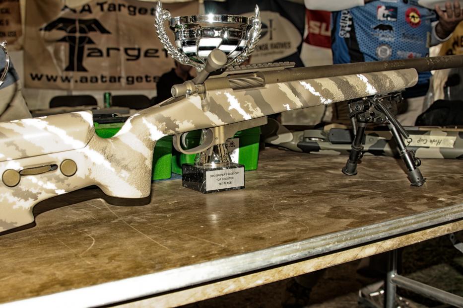

    I met Chad on Thursday and had the opportunity to get a "tour" of this rifle, dry fire it, and quite possibly shed a little tear on the fine camo pattern. I can assure you this stick is more badass than even these pics show. The bolt cycled like butter, and I swear the trigger broke just by thinking about it. Not that it was a feather, but light,crisp, and decidedly clean.
    Here it is on the table, really worthy prize rifle... the engraving made it unique.
