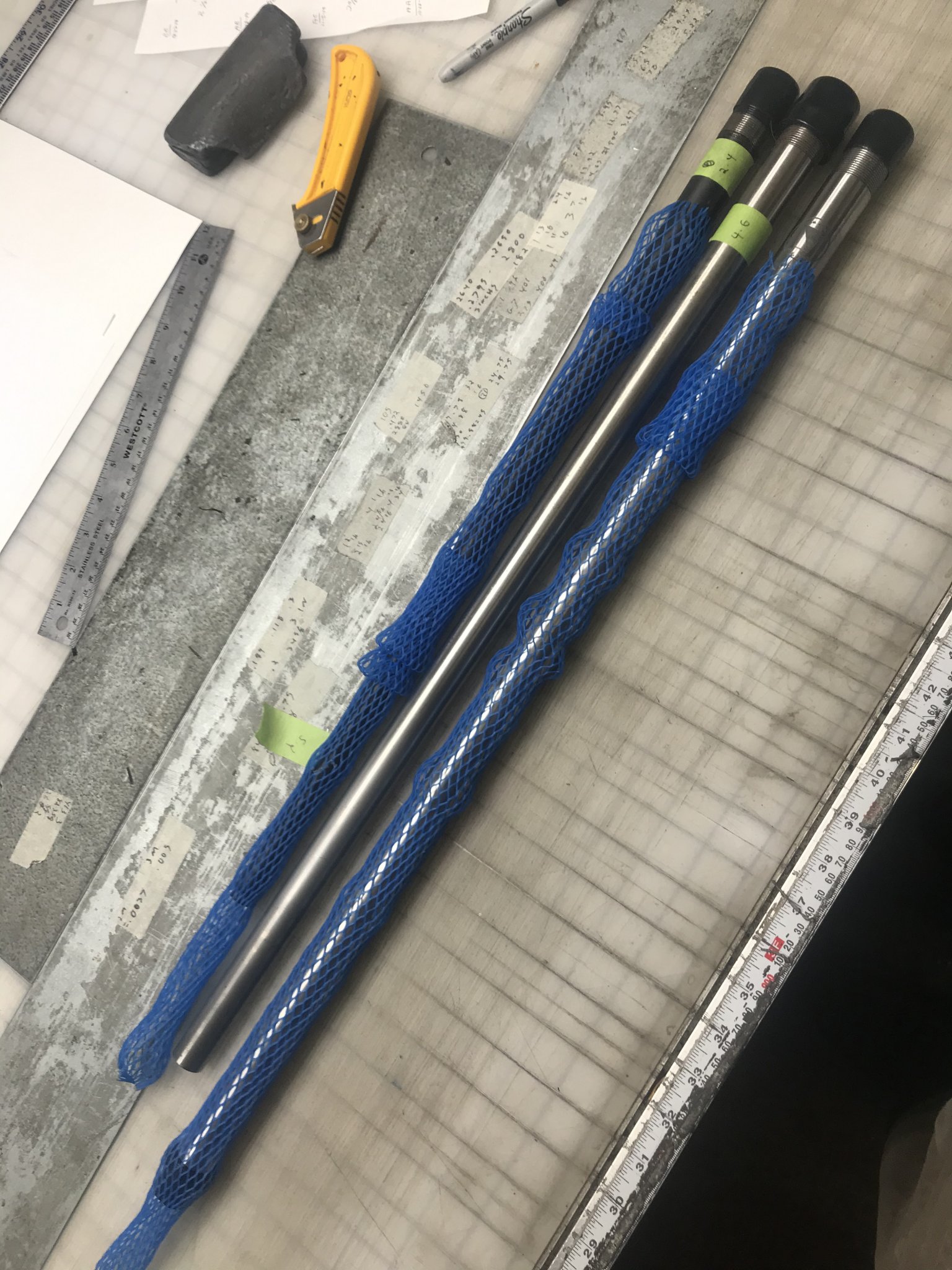

Here’s my original 260, my first Shilen and my second 7 saum Barrels in use in my savage and nucleus actions
They are super easy to install.
