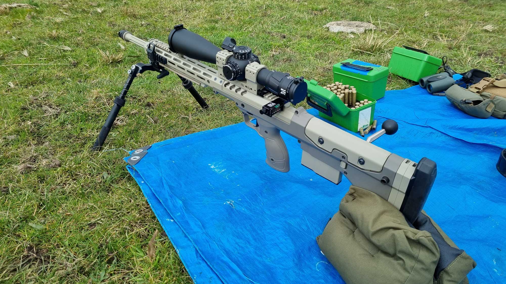

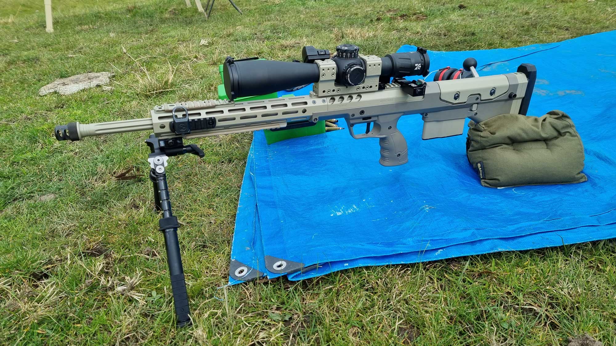

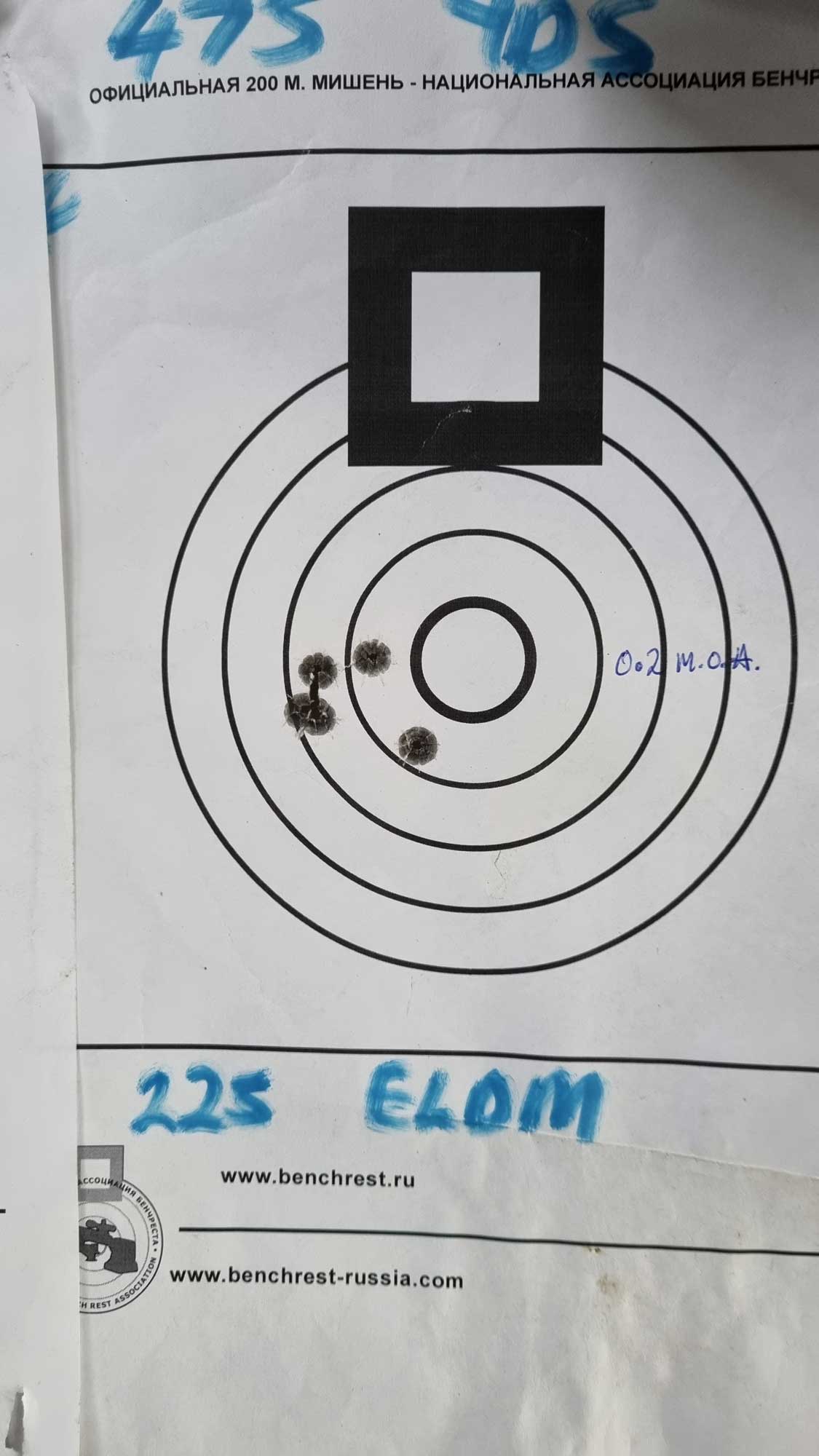

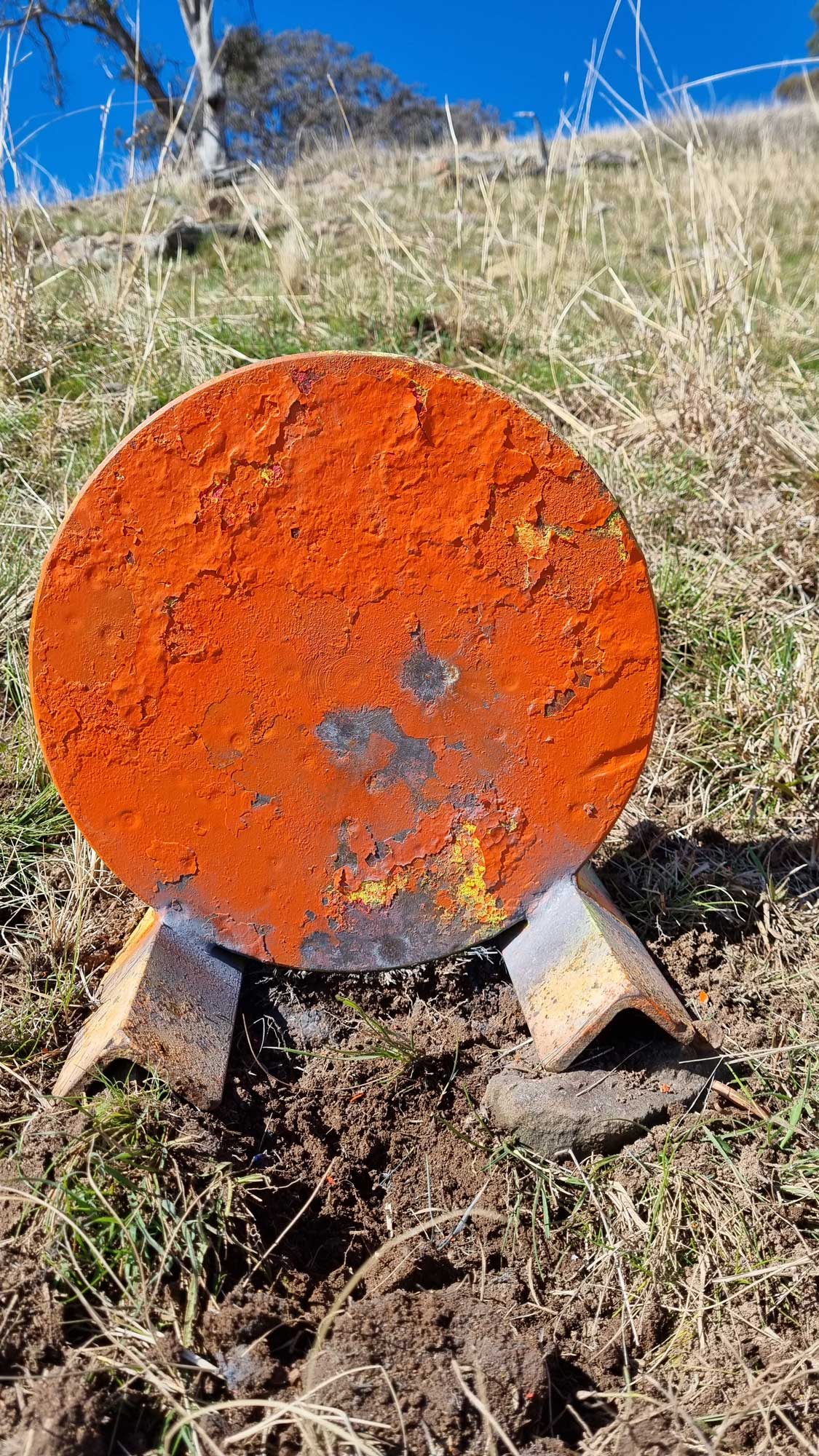

DT SRS in 300wm..LOVES Hornady 225 ELD-M,s... ( 1 in 10 twist)
200 yds and 475yds..
Round Fluro orange plate is 12" Dia...5 shots at 1500yds..
