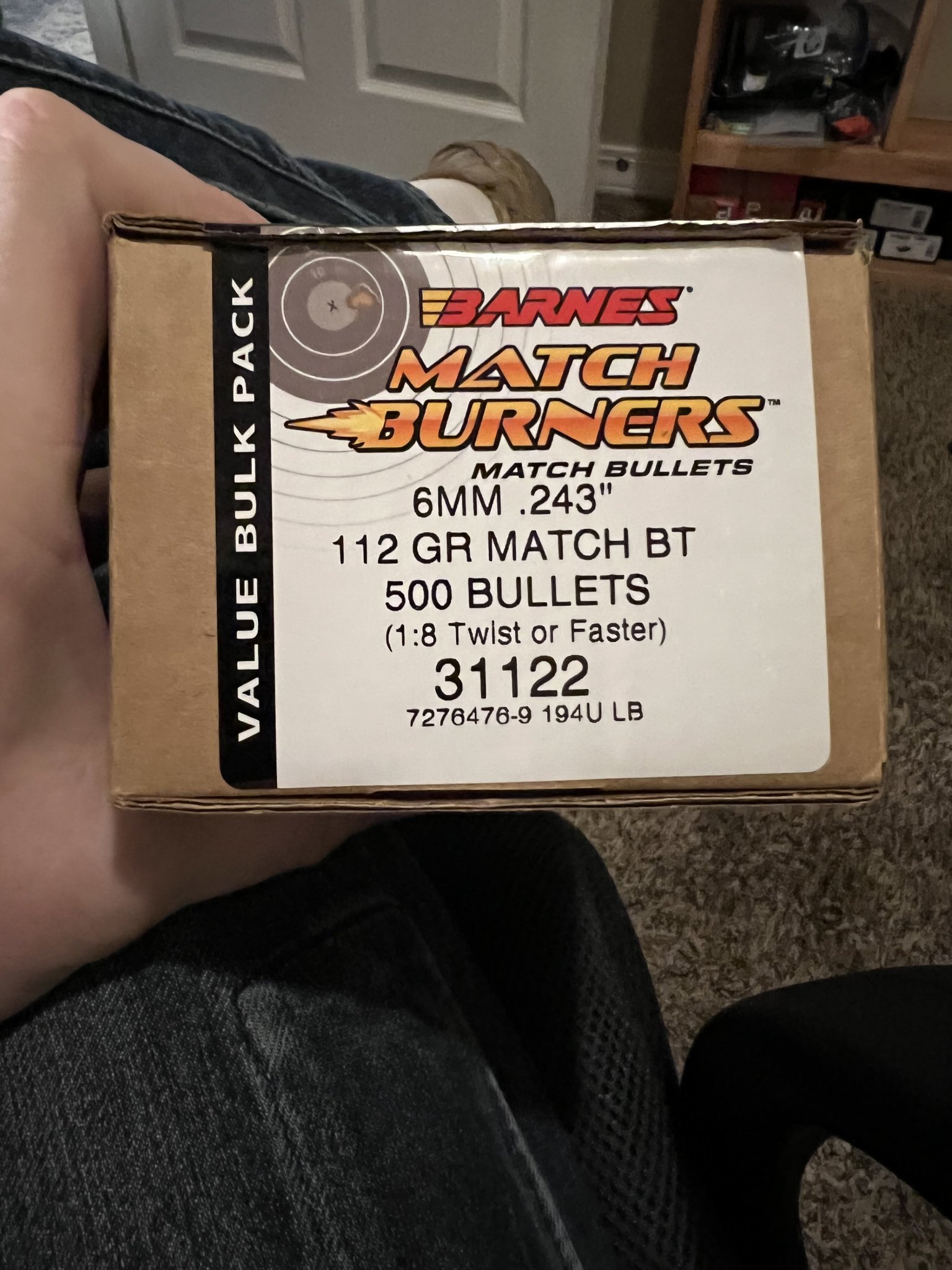

Here's the response I got from Barnes, the pictures I sent showed the boxes/lot numbers and measurements of shank vs pressure ring for the 112gr MBs In question and 108gr ELDs (kind of a control). My issues were with annealed brass, and I asked what neck tension they were using in their 6BR, but no response.
"Gtscotty,
Yes, we received your email/pics. Thank you for that. Several things/facts. These bullets are within our design/manufacturing specs. From initial design through shipping, our bullets go through a multitude of inspection steps. Looking at the lot #’s you forwarded to us, their were no discrepancies found. Actually, our Ballistic Lab Manager said this lot was one of the best shooting lots we’ve ever run. Second, I recall the issues you brought to light during our phone call. My first suggestion is to anneal before each loading and use a tighter neck tension. The amount is up to you. Bullets can and sometimes purposely by design have a slight taper in their shank measurements; they still shoot super tight groups. For the record our Match Burners, by design shoot much more accurately when the taper increases in diameter towards the shank/boattail junction. Next, you mention seating the shank/boattail junction below the neck/shoulder junction. Don’t! You can tune the COAL to still shoot accurately by moving it up above the neck/shoulder junction. We shot well over 100, 10-shot groups with that lot#, some of them by yours truly before leaving the Ballistic Lab and moving up to Consumer Services 3 weeks ago.. I lost count of how many .3”, .4”, and .5”, 10-shot groups we shot. Shot from a 6BR, Peterson brass using Varget and Rem 7-1/2 primers. Enjoy!
Thank You"

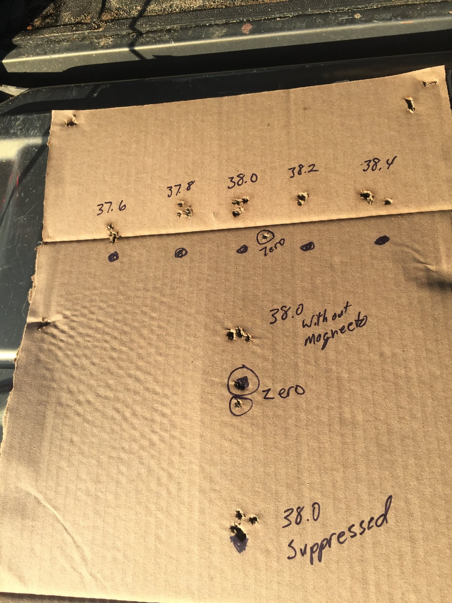

I tested this same lot number today with no issues.
6 CM, Peterson brass annealed, fl sized and .242 mandrel. Loaded 5 different powder charges of h4350. Velocities ran from 2860-2935 and worst sd was 12. Groups all have potential. I’m sure I can just pick a velocity and load. Didn’t measure jump, just kept bearing surface above neck shoulder junction. Then shot last 7 rounds on plate at 400. 45 degrees today, raining and windy. I didn’t see any issues in the 46 rounds I shot. I intentionally shot all groups .4 above point of aim. With some tuning there shouldn’t be any problems

Here are my findings for my barnes 112gr mb's
I have 4 different lot numbers of these bullets.
Lot # 7276476-9 shank .243 pressure ring .244
Lot# 7276476-8 shank .243 pressure ring .244
I can physically feel the pressure ring with those bullets with my fingers.
Lot # 7276476-11 shank .243 with no pressure ring.
Lot # 7276476-12 shank .243 with no pressure ring.
All measurements taken with starrett calibers usa made and certified.

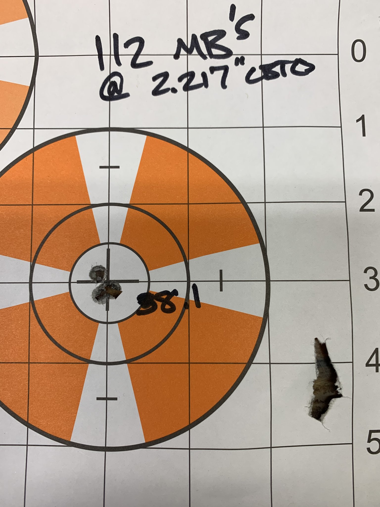

I did a little more load development this past weekend playing with seating depth and charge. I found two velocity nodes where groups were in the .2's. These are all from lot #7276476-7. I ran them out to 600 and had no flyers I'd seen previously.

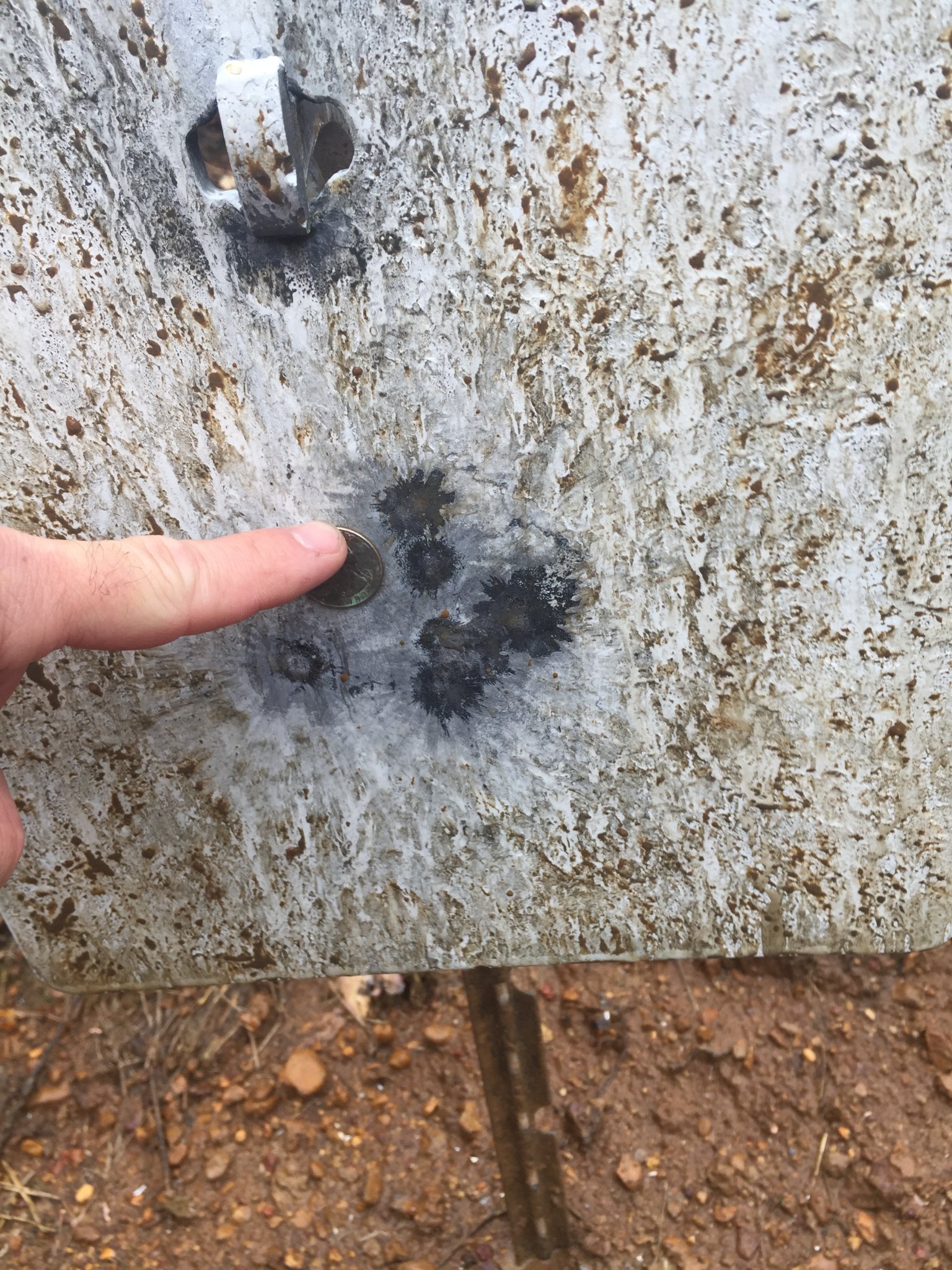

Here’s a target from my last range session…5 shot group, one’s just a bit outside!
Looks like they’ll shoot. I shot a one day match last weekend with one of the lots from above and they did just fine. My belief is any problems guys are having is self inflicted. Just my opinion tho, not worth much maybe
Do you see the one almost 3” to the right and low that went through the target sideways? I haven’t ever had any issues with D-tac’s, Atip’s, Hybrid’s, Eld-m’s or RDF’s in this barrel so I wouldn’t call it self inflicted.
Just out of curiosity would you send me 20 of that same lot? I’d like to shoot them just to see if the issue replicates in my rifle. I can pm my shipping address
