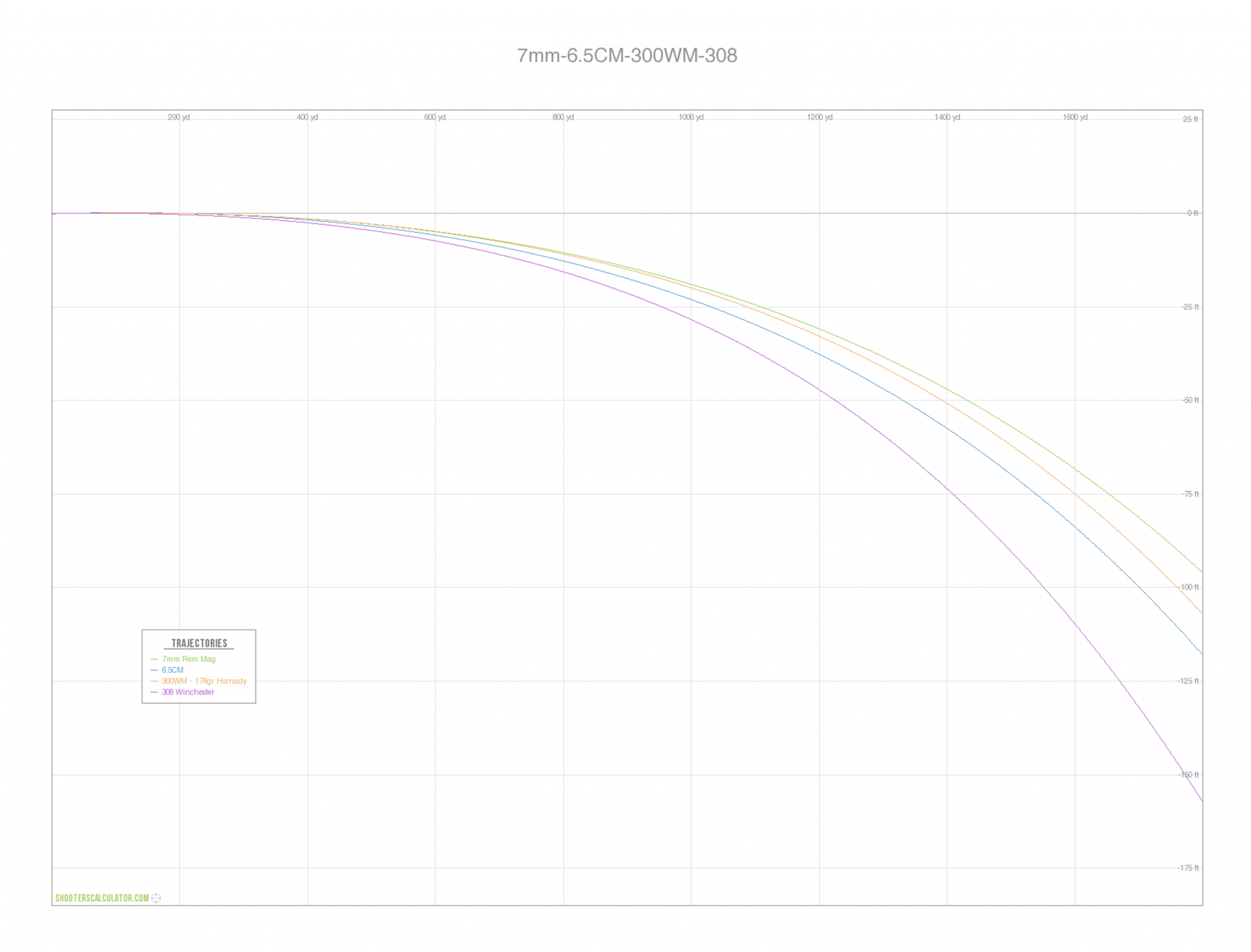

I've been researching various rifle options for myself, looking at long distance hunting and PRS. Given my own personal parameters, I looked up cartridges that were as close as I could find to each other. I've put that info into a ballistics calculator for chart creation. My current choice is to go with a 7mm Rem Mag rifle & round, as it seems to have the best overall ballistics for my parameters. :)

^I can't see what parameters would make that chart seem important. Certainly approaching zero value for a chambering comparison.
4 calibers of rifle round: 7mm Rem Mag, 6.5CM, 300WM and .308 Winchester. Ballistics info from each gathered from Mfr. and range information out to 1800 yards. The OP asked a question...I provided my input. Worthwhile? That is up to the OP.

1. Trajectory is essentially meaningless for shots at known distances, i.e. target shooting. Wind drift is what's important for hits. Both are improved by velocity, but wind drift is improved much more by using a projectile with higher ballistic coefficient.
2. The trajectories you posted are also just 1 of 100's of projectiles/loads that could've been selected for those cartridges...
Find the projectiles with the best BC for each caliber. Pick an acceptable wind drift for your purpose at max distance - in this case 1200 yds. Look at the velocity necessary to achieve that wind drift - now figure how much powder would be necessary to get that velocity - and that capacity should start pointing towards a few cases that would work, for each projectile.
Now that you have potential chamberings - weigh the limitations of rifle configuration as well as cost of consumables, heat soak, recoil, and many other tangible and intangible criteria.
