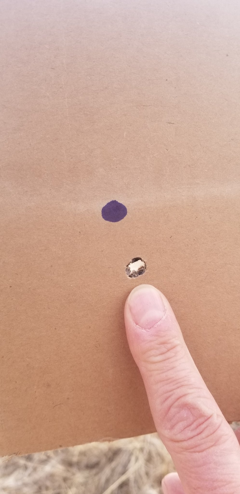

I have the same rifle. I run the 130 hybrid with better results than the eldm. I have launched 1000s of ELDM'S but the 130 hyb is better for me. You will wind up some 10 to 20 thou off the lands. Heres 3 shots.

Let me start by saying I had a horrible cold bore shot with this rifle, I mean bad. 2 to 3 inches low every time. If it sat more than 5 mins. Repeat of cold bore. Last saturday I tore gun completely down and dremmeled the feed ramp and reassembled. Those 3 are the first 3 I fired. Cold bore issue solved, dont ask me what the cause was. It was 18 degrees.
Lapua brass 42.1 h4350 fed 205m at 10 thou off makes 2885 fps sd 4 es 9. I tried the mag primers everyone uses but they weren't working.
MY GUN, MY AMMO YMMV.

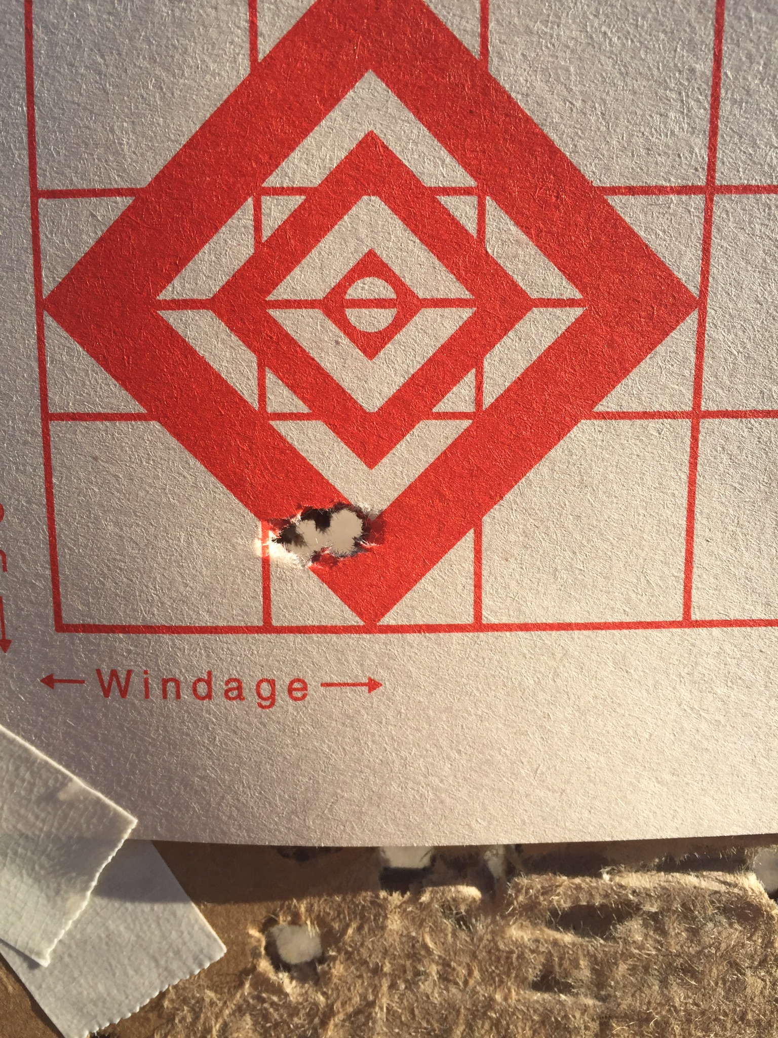

I had better results with the Berger 130 with
H4350- 42.6gr
Hornady brass
Fgmm 210 primer
130 ar hybrid
I was shooting the 140 eld with 1/2” groups and then switched
