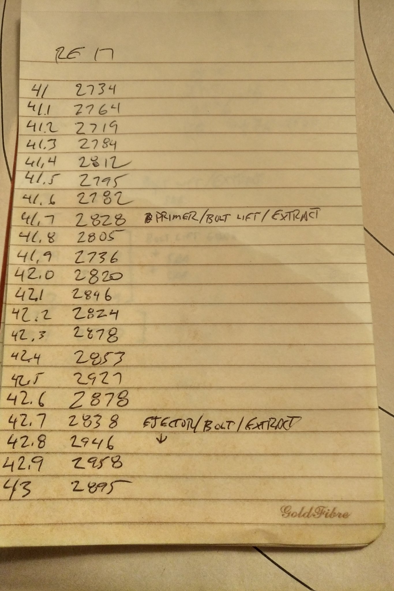

Nice pictures, thanks. 147gr at 2929fps? Dang, that's impressive. The big takeaway for me is that now I want a 28" barrel.
Reloder 17 will push 2900+ as well.... In a 24" ? 'Murica... Prime brass, Federal 210M, .025" off the lands.

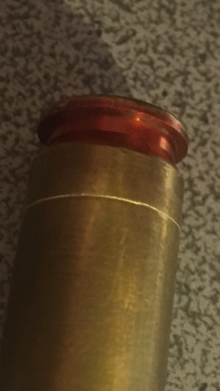

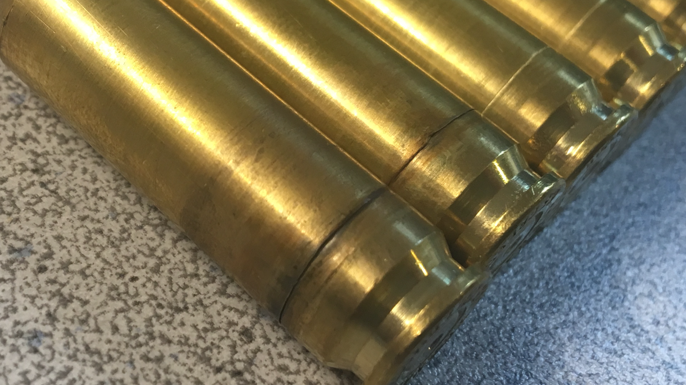

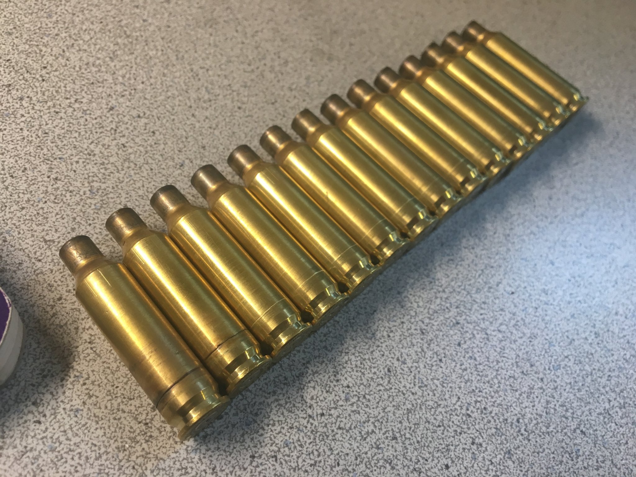

Went out to shoot some of these loads at 47.4gr and they performed very at ranges from 400yards out to 1000 yards. They were nailing the 18” plate at 1000 yards over and over without a single miss in 14 rounds and only required 23MOA for 1000yards. Bucked the wind way better than my buddy that was shooting the 140gr BTHP as expected.
The bad news is the case head separtations on 2 and the the obvious start on another 12. It doesn’t surprise me but I’m not 100% certain it’s the load or the fact it’s Hornady brass that has been shot 11 times or a combination of the two. View attachment 6927147View attachment 6927148
I have another 50 that is on its 9th reloading so I’m going to continue to shoot that until failure of some sort.
I’m reporting back as I said I would on the other batch of Hornady brass that was not loaded with RL26 or 147eld. This brass was with 42.2gr H4350 and 140eld sized and shoulder bumped with the same die and shot from the same rifle as the RL26 and 147eld. This made it to 14 firings before case head separation appeared. I did start bumping the shoulder back 0.002” less at around the 10th firing.
