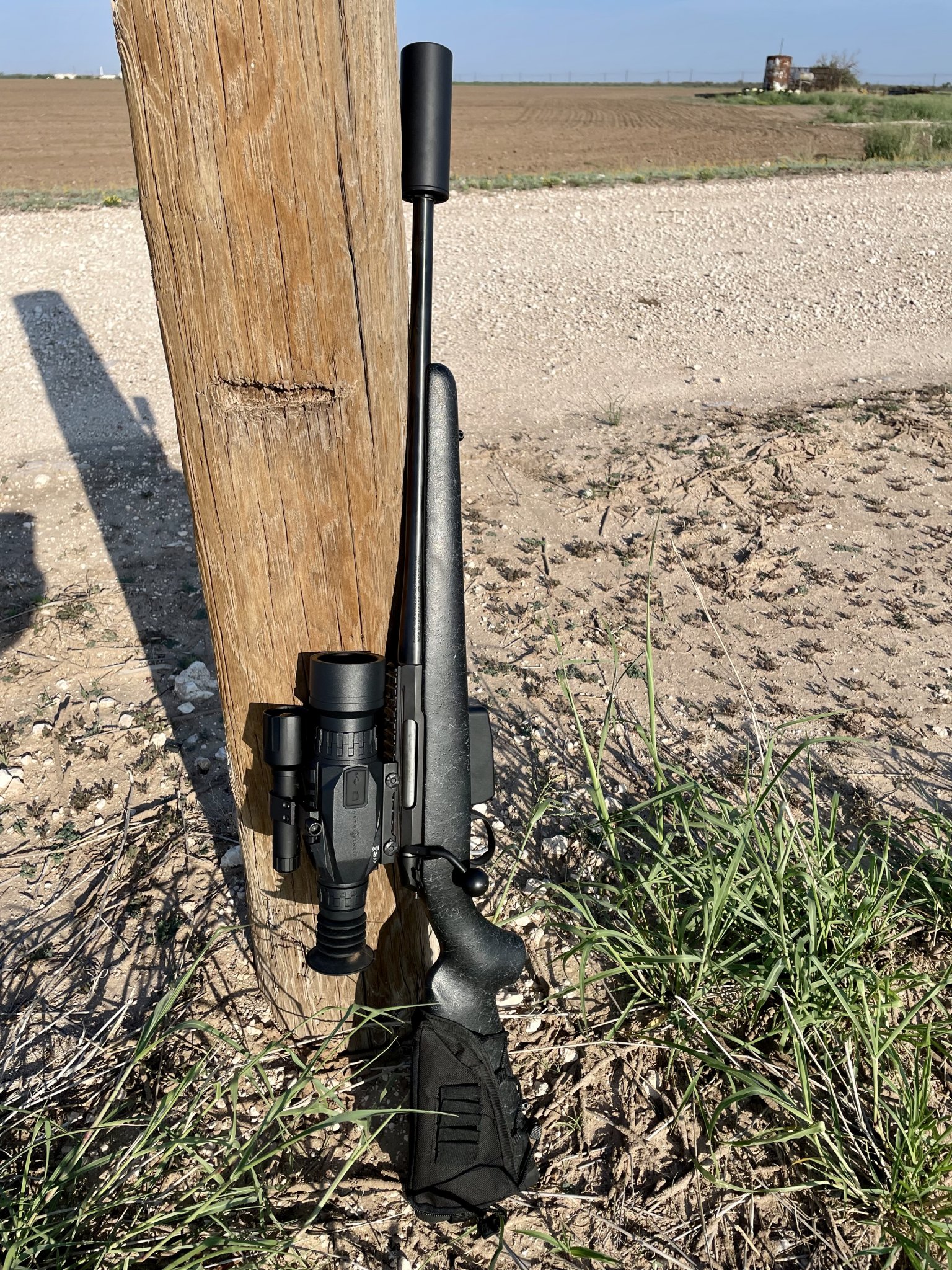

I am having a 18" 6 creed spun up for my Tikka for my night time thermal rifle. I have 500 87gr V-max and some Lapua srp brass waiting here for the barrel. Hoping to hit 3000 fps or better with them. I have H4350, Rl16, 4166, 4451, and Varget on hand. What powder are you using for your 87 gr load?

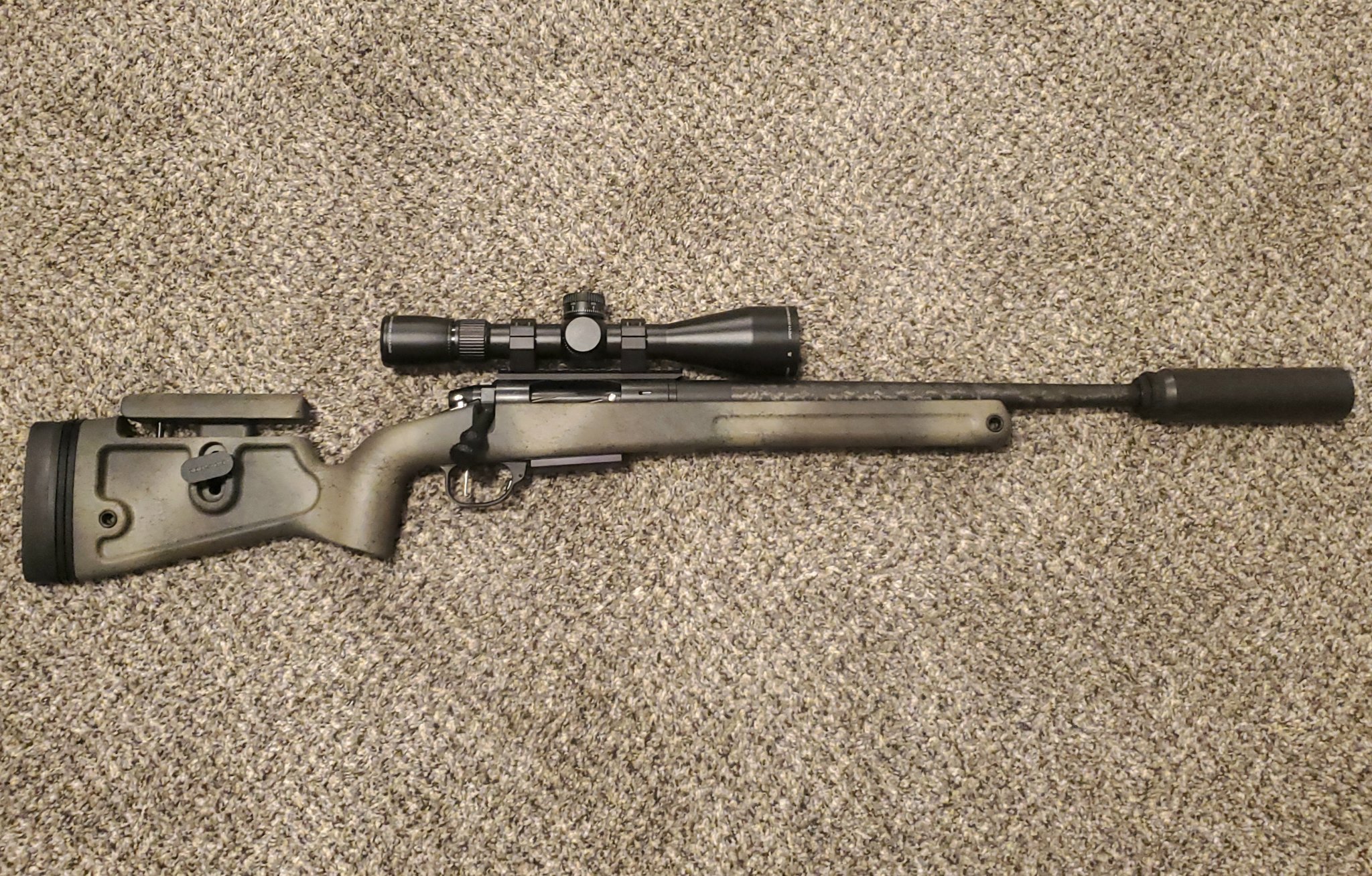

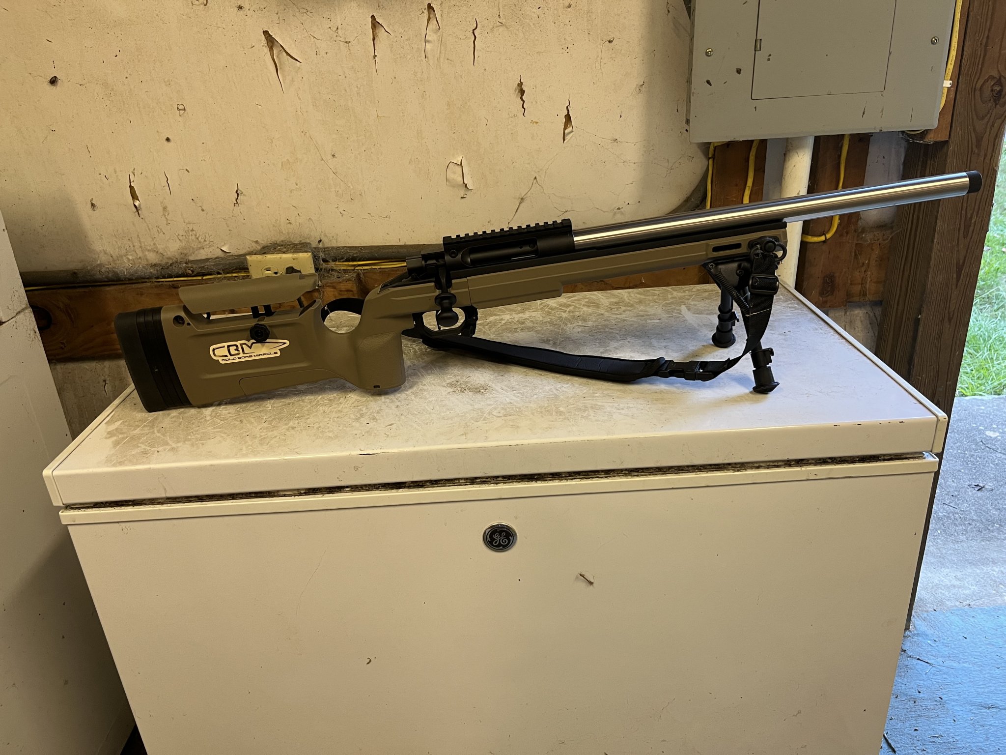

Finished putting my shorty 6 creed together this after. ARC Archimedes action with 18.5 inch threaded benchmark barrel spun up by Travis at TS Customs. Got a Triggertech 2 stage diamond and currently in a Krg Bravo. May change to a Manners eventually when funds are more available. Will have an Optika 6 3-18x56 Mrad mounted here soon. And maybe just maybe my 2nd suppressor will be approved and in hand soon (certified 3/2/22).
Very nice. Let us know how you like that 18”er

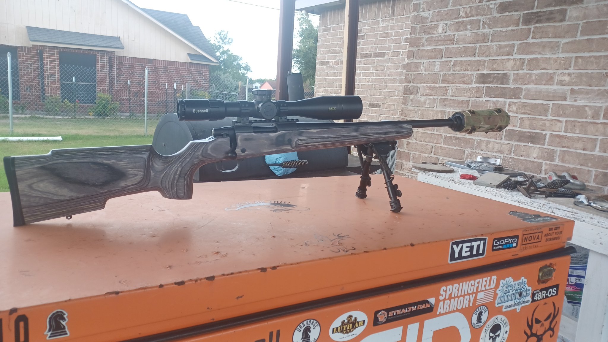

did you cut the original barrel down? or get it rebarreled
details please, i am thinking of building something similar.
I had the original barrel cut from 20" to 18" and threaded 5/8 on it again.
Stock is a boyds pro varmint.
The day I brought it back from having the Smith bed it, I had to pack and leave for work the next day. I haven't been able to shoot it.
Although if I could change one thing on it, it would be to use 2 piece scope base/rings. The picatinny rail that I used in combination with those rings are good. However, loading from the top is a bitch with such little space that there is.
Bottom metal is from Oregunsmithing. There's no way in hell I would have kept the factory bottom plastic and mag. Most people don't have problems with theirs, but I built this rifle to give my dad for hunting. I didn't want him to have any issues!

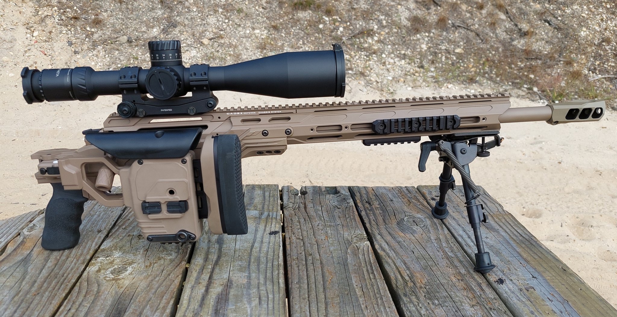

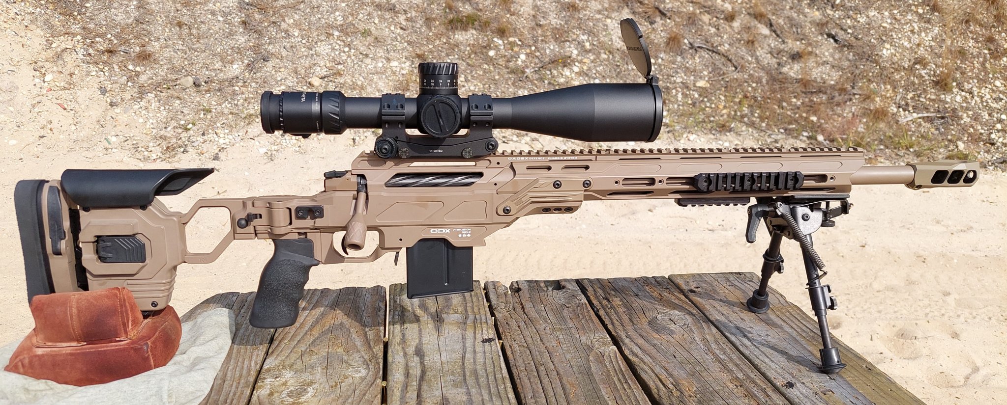

Huge fan of prefits, goes from 22# 26" PRS rifle to a 8.5#16" hunting rig.
16" Carbon6 6.5cm, Origin SA, Grayboe Phoenix & DBM, Nomad w/ A419 mount, TT special, Hawkins hunter mag.
