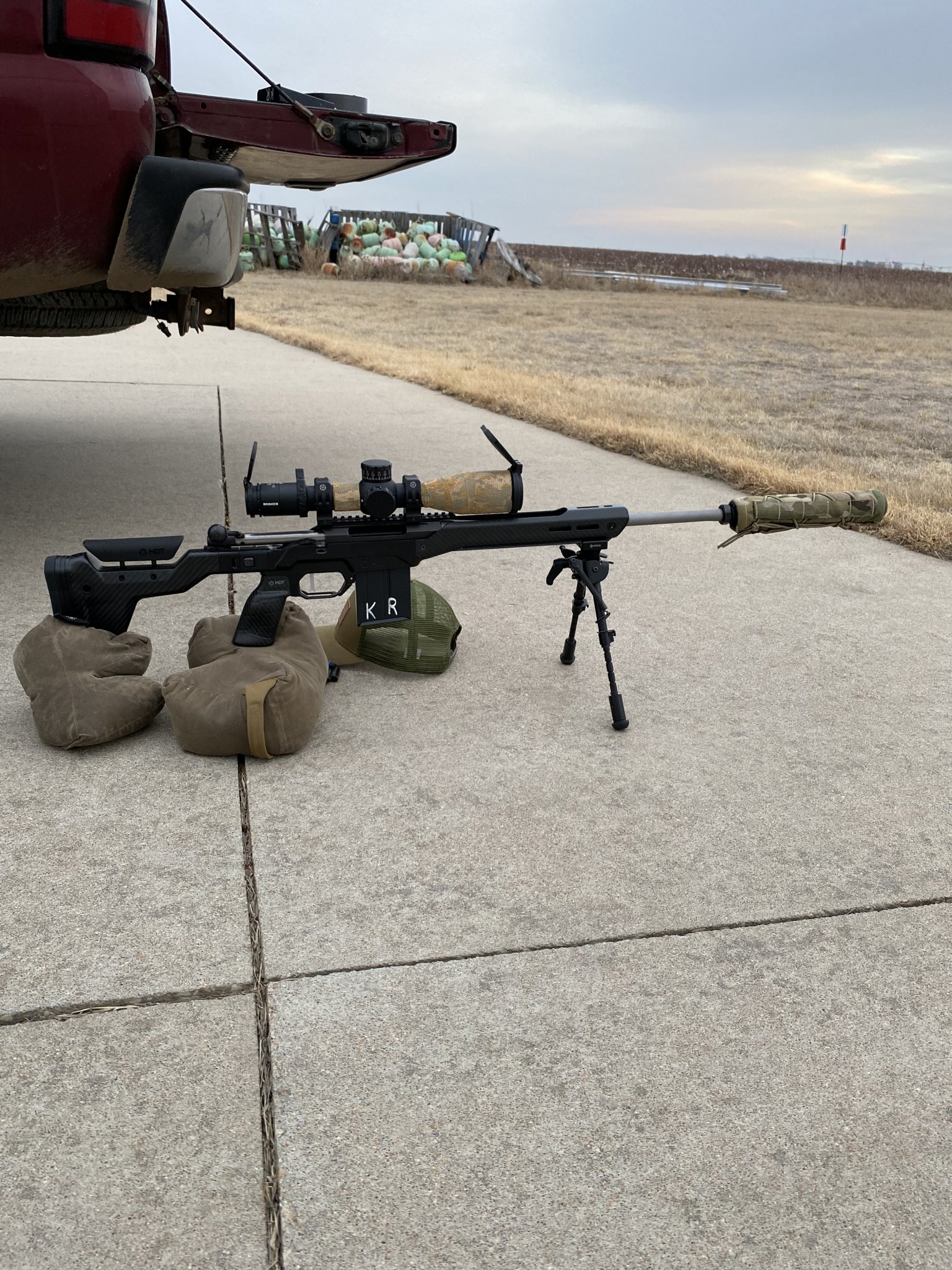

Haven’t put the magneto to it yet. Shooting a 124 hammer hunter with 57grn h1000 guessing it’s only around 2700-2750.
Pre Bob defiance anti-x
Bart 2b
Manners UC
SAS barricade
Snag N560 from Powder Valley and you will see a significant jump, I was getting over 3100 from the 123 AH in an 18” 6.5 PRC.

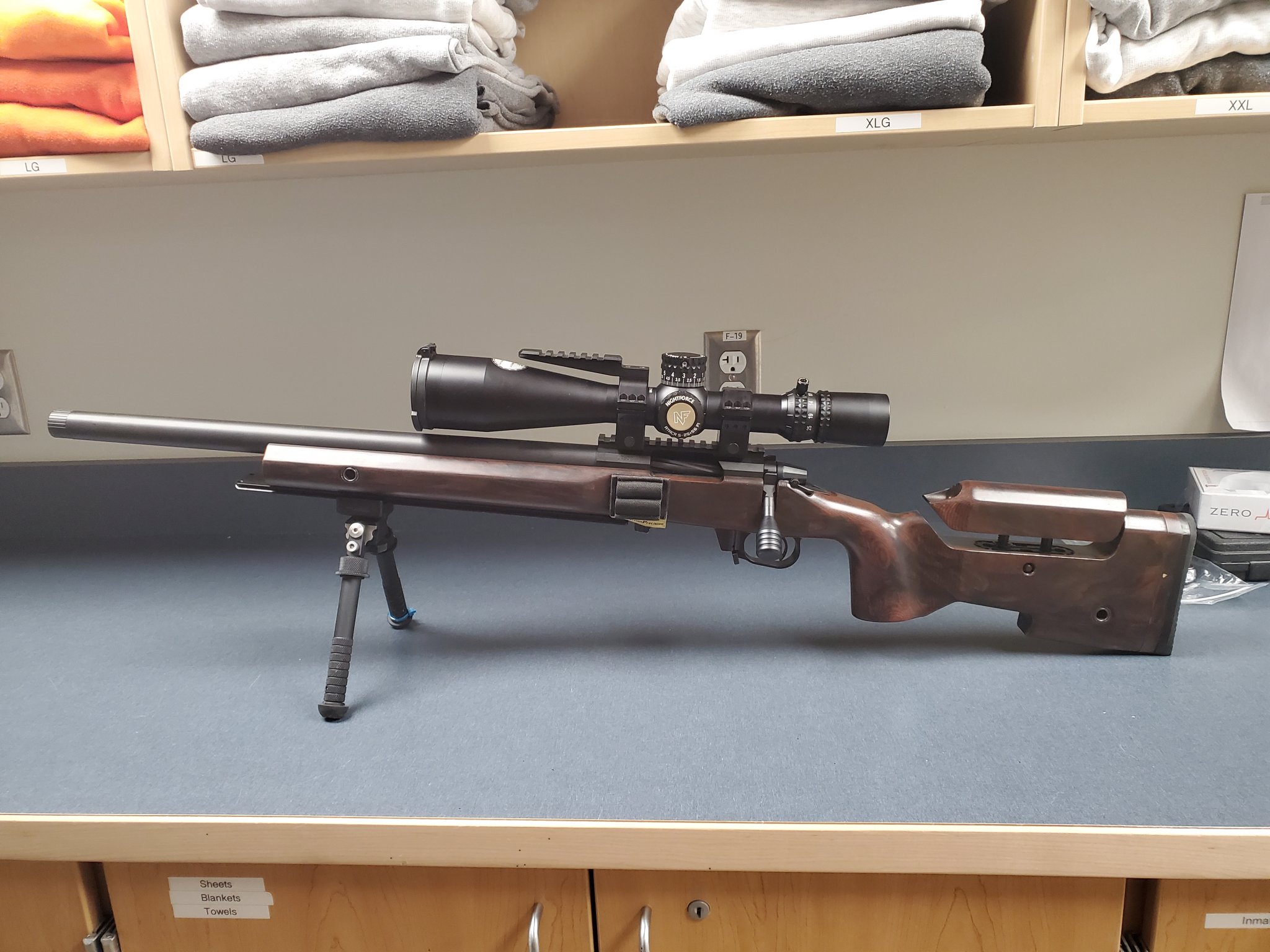

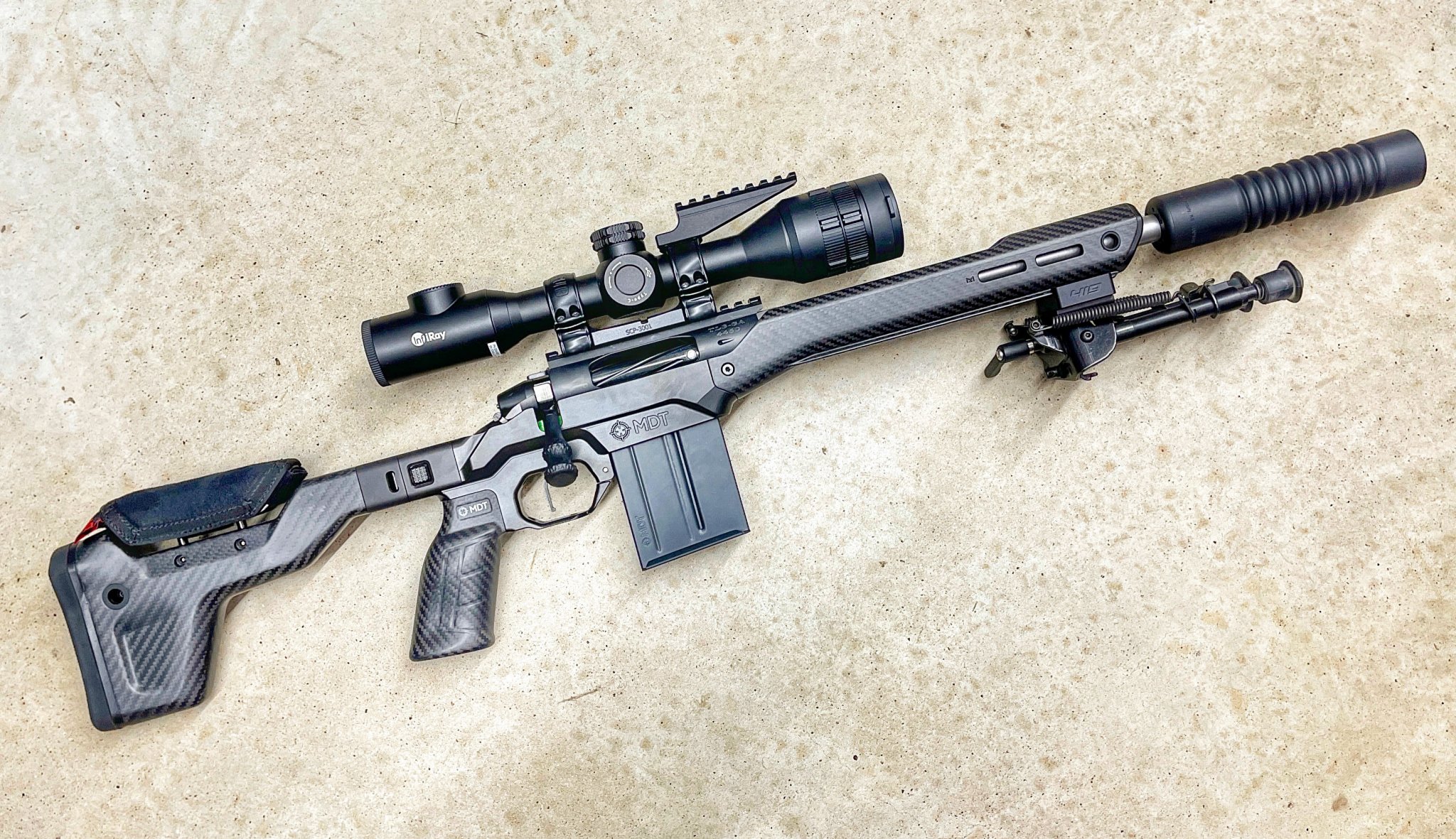

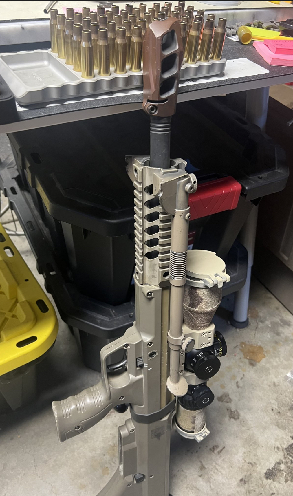

I am back at it again... short barrel 308, work gun. I have a Manners for it that getting a mini chassis for it, but man it looks good in this Foundation.

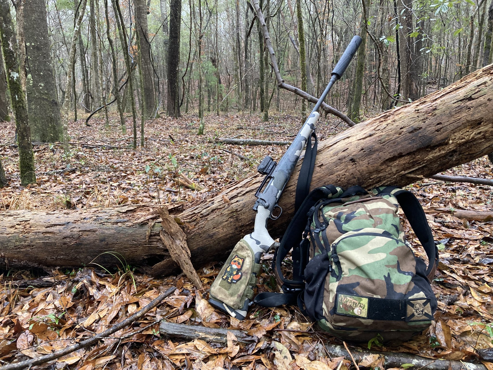

I’m fully converted to short suppressed rifle for hunting now. Have a 14.5 Pin and Weld 7mm08 Winchester Model 70 CRF in a McMillan hunter stock. Like it so much that I’m going to do the same thing to a Rem700 in 6.5 Creed in a McMillan Game Warden stock. For 500 and in on white tail, it’s the way to go imo
Thats a nice hunting combo. I love the 7mm-08 but went with a 7SAW on my latest 22in build defiance anTI, got 2 white tail bucks this fall with the 162s

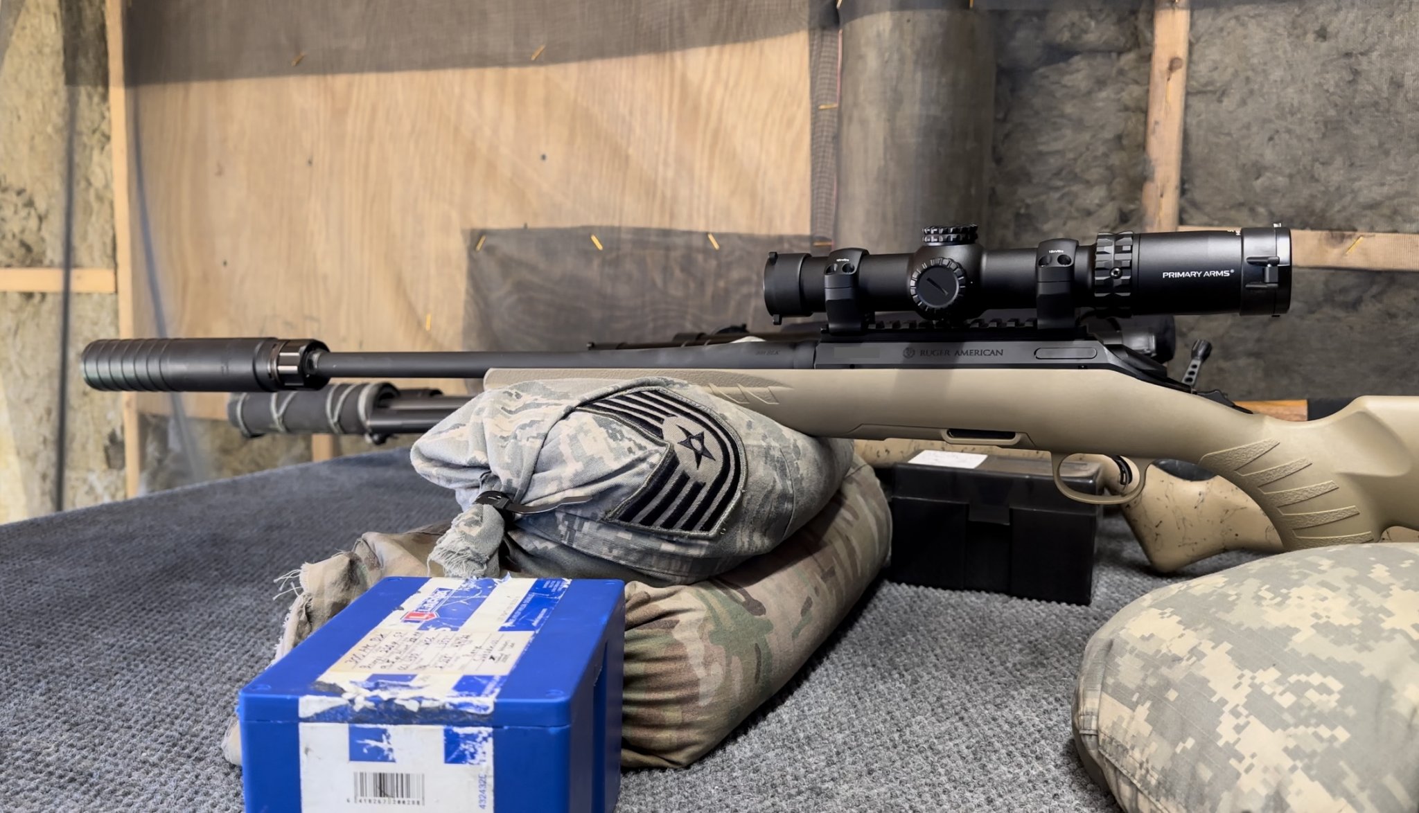

Here’s my entry…
16” RAR in .300 BLK.
Wish it was 10.5”, but I’m not stamping this one. I’ll wait to see how the legislation pans-out with the whole SBR’s possibly getting removed from the registry thing, since numerous states have already passed local laws stating SBR/SBS/AOWs are legal there without ATF regulation. The more states follow suit, the less powerful the NFA and ATF become…Eventually nullifying the NFA. Same with the “Made in Texas” suppressor lawsuit against the ATF. Things are looking pretty good, but only time will tell…

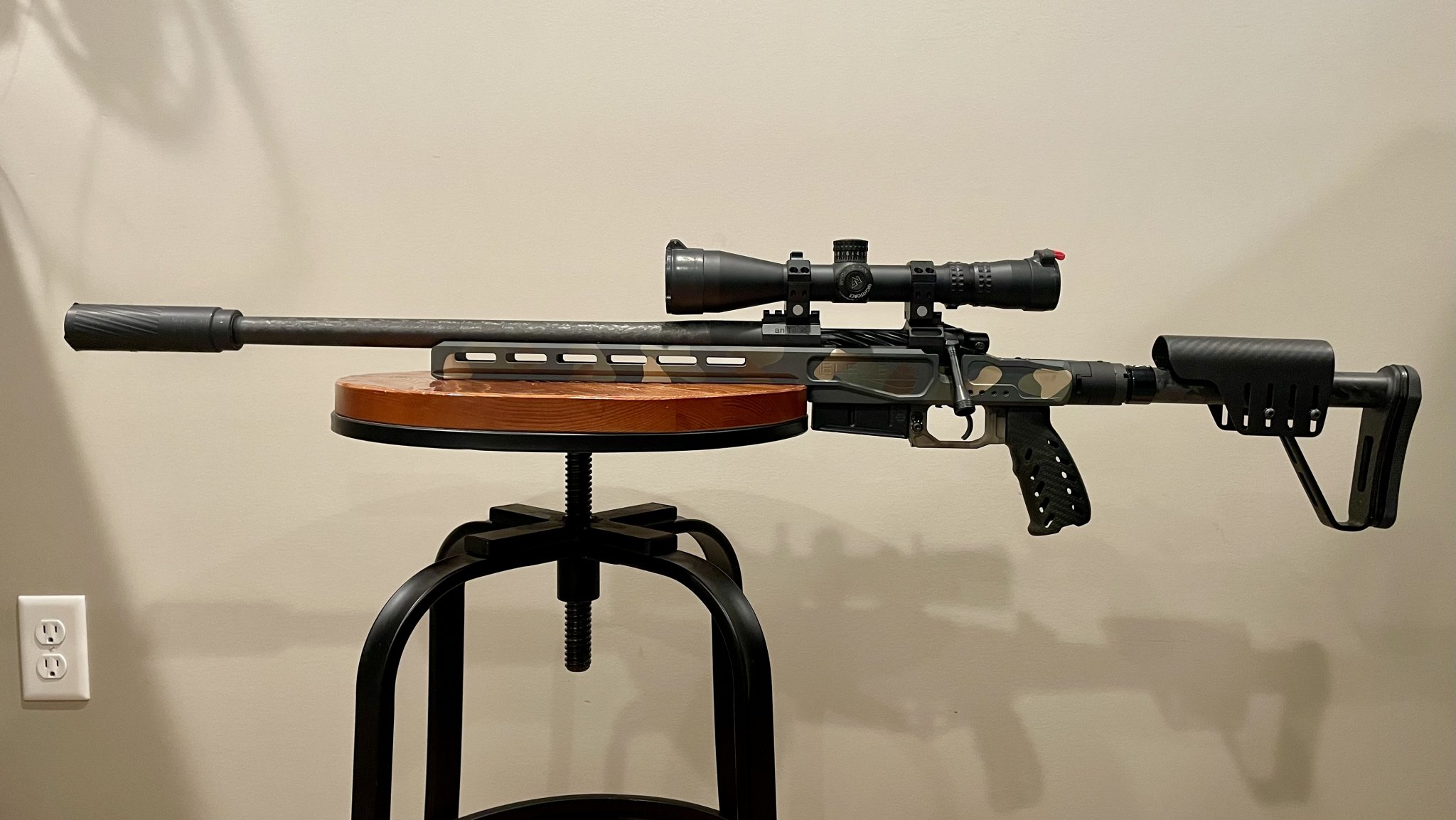

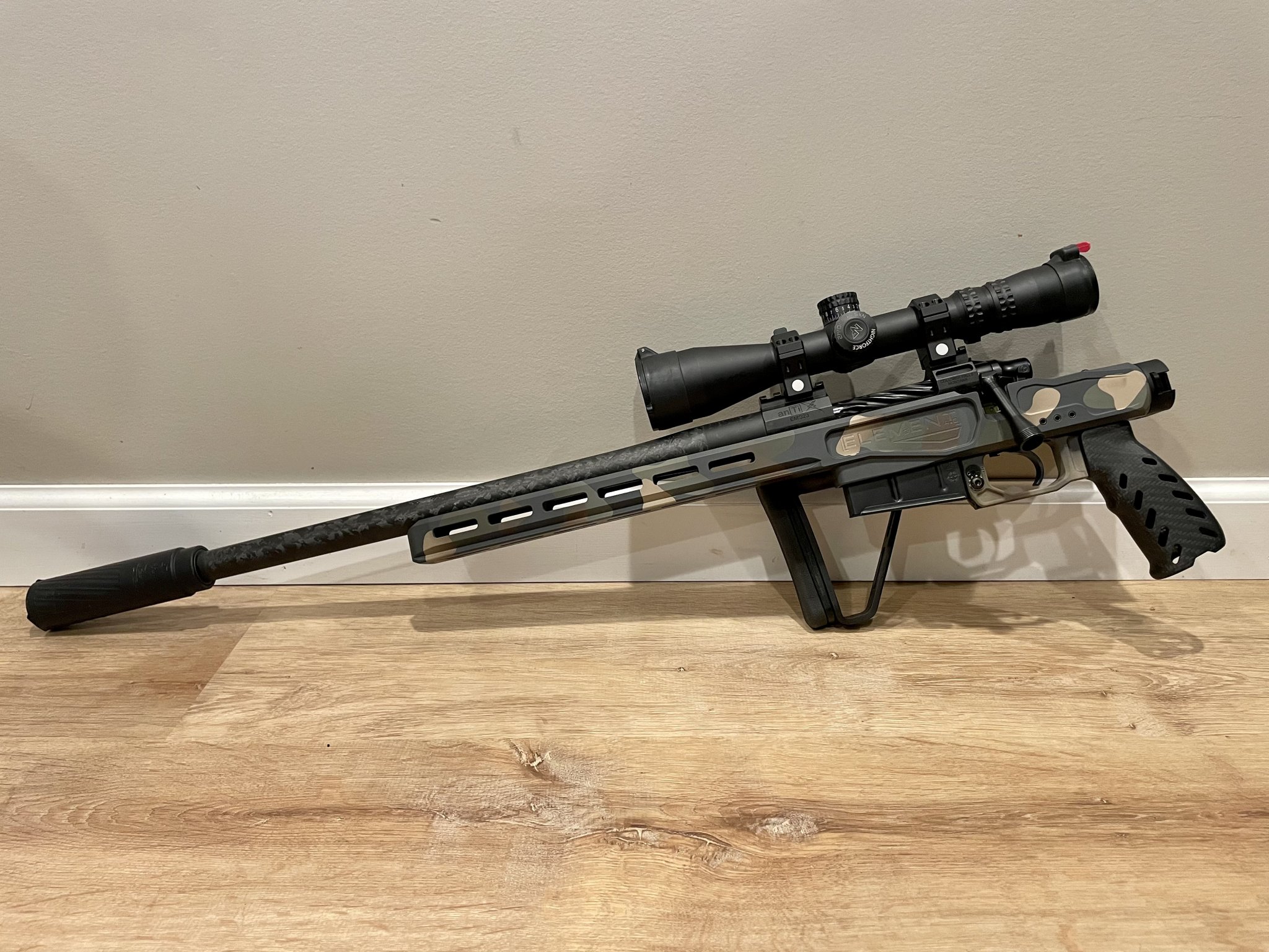

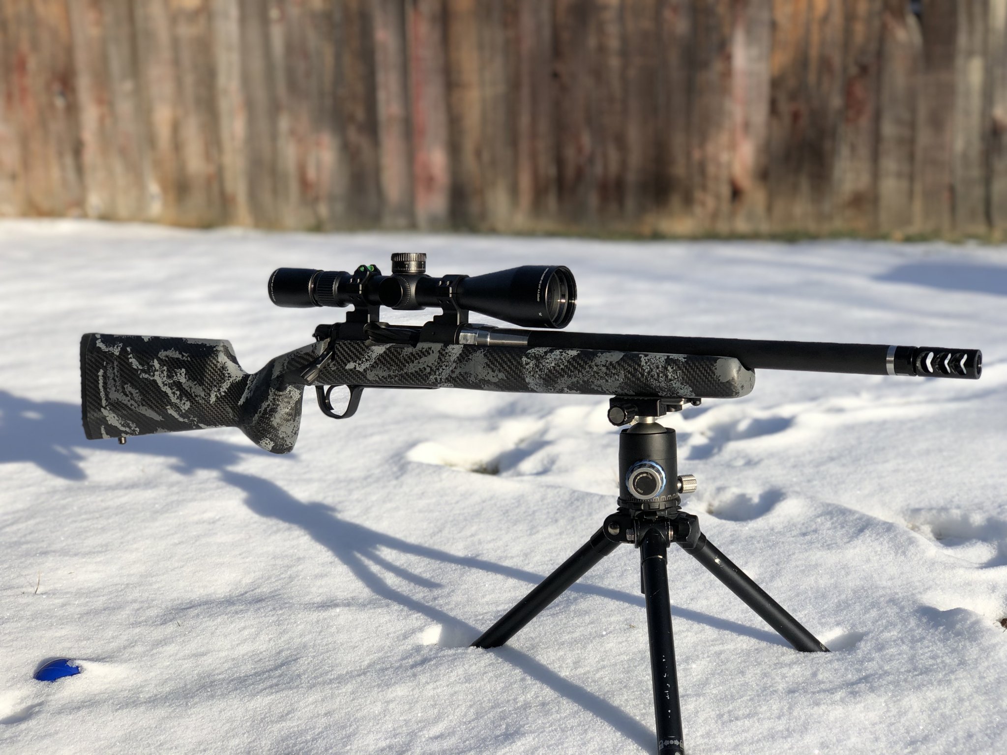

Details on the bits!?
Christensen Arms Model 14 action from a Mesa
Western Precision Rifles CF Rem 700 Stock
Trigger Tech Special
X-Caliber 18” Lightweight contour CF barrel
Tubb Duo Rem 700 firing pin spring
Hawkins Long Range Hybrid Rings
Razor LHT 4.5-22
Action fully bedded with MarineTex
Cheap little Arca plate for the tripod to grab
Just got it spun up/bedded this weekend. Hope it shoots lol!
Razor LHT 4.5-22
Oh and a PVA Jetblast UL brake

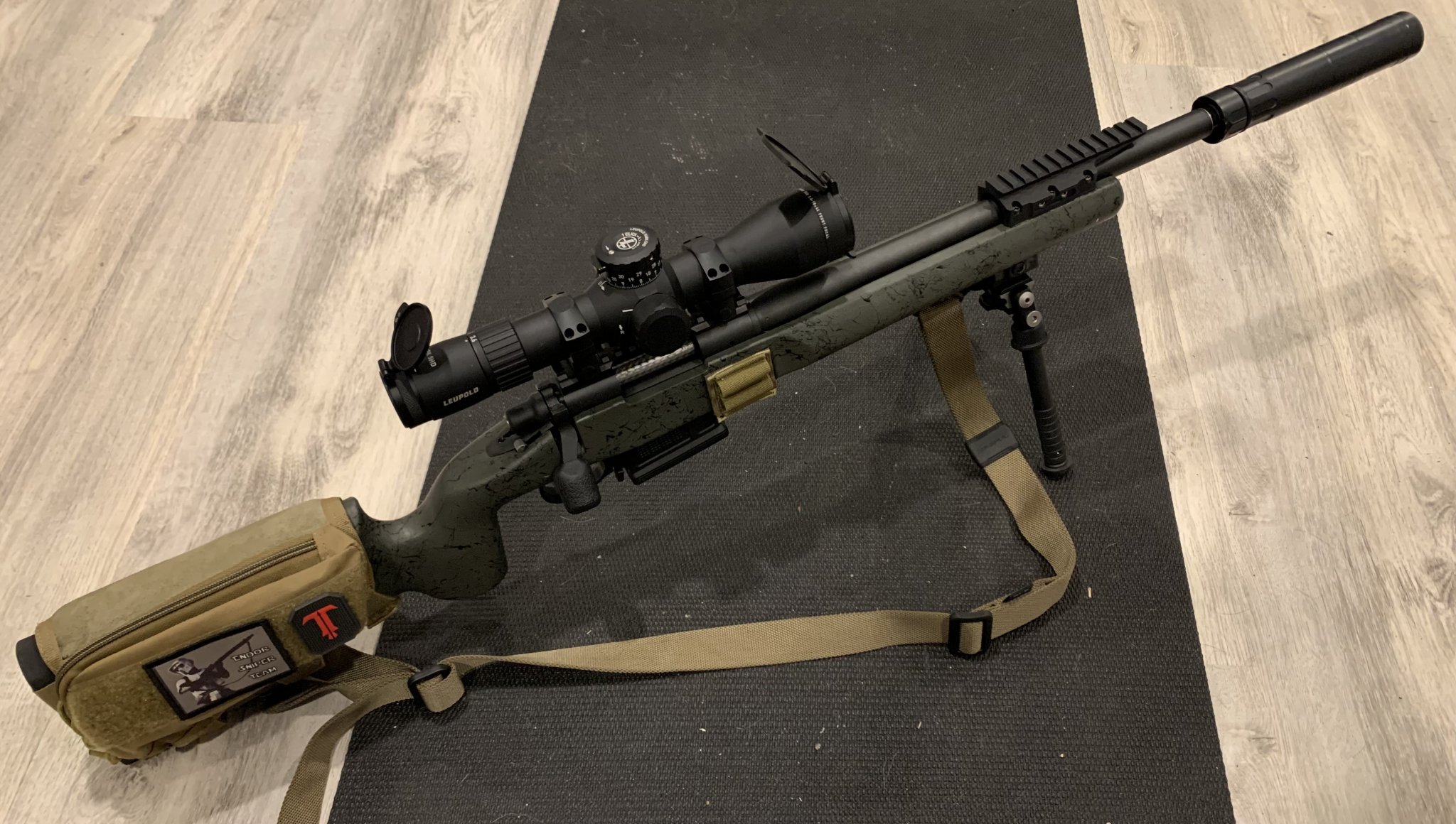

Remington 700; 16.5" AAC-SD Tactical. Heavy 1:10 barrel with rugged surge 7.62, triggertech 700 primary, in a Grayboe Renegade. Leupold Mark 5HD 3.8-18x44 w H59 reticle.
Some prelim data:
185gr Berger Fed GMM MV: 2428 avg
175gr SMK Fed GMM MV: 2378 avg
Holds with 100yd zero for 175gr
100 - 0
460 - 3.5 mil
675 - 7 mil

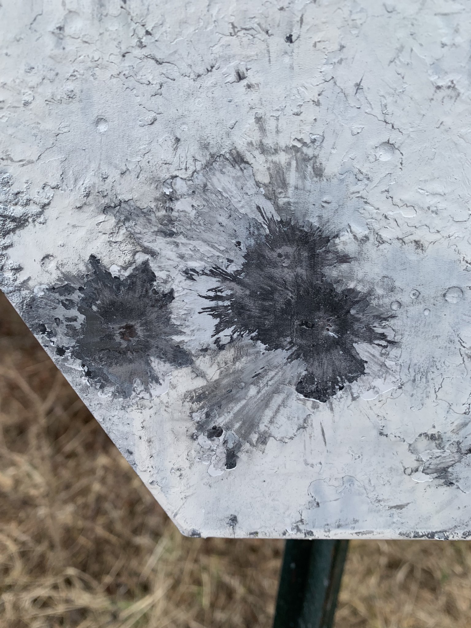

3 shot group on 10" hex plate at 460

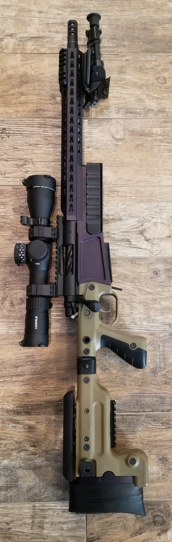

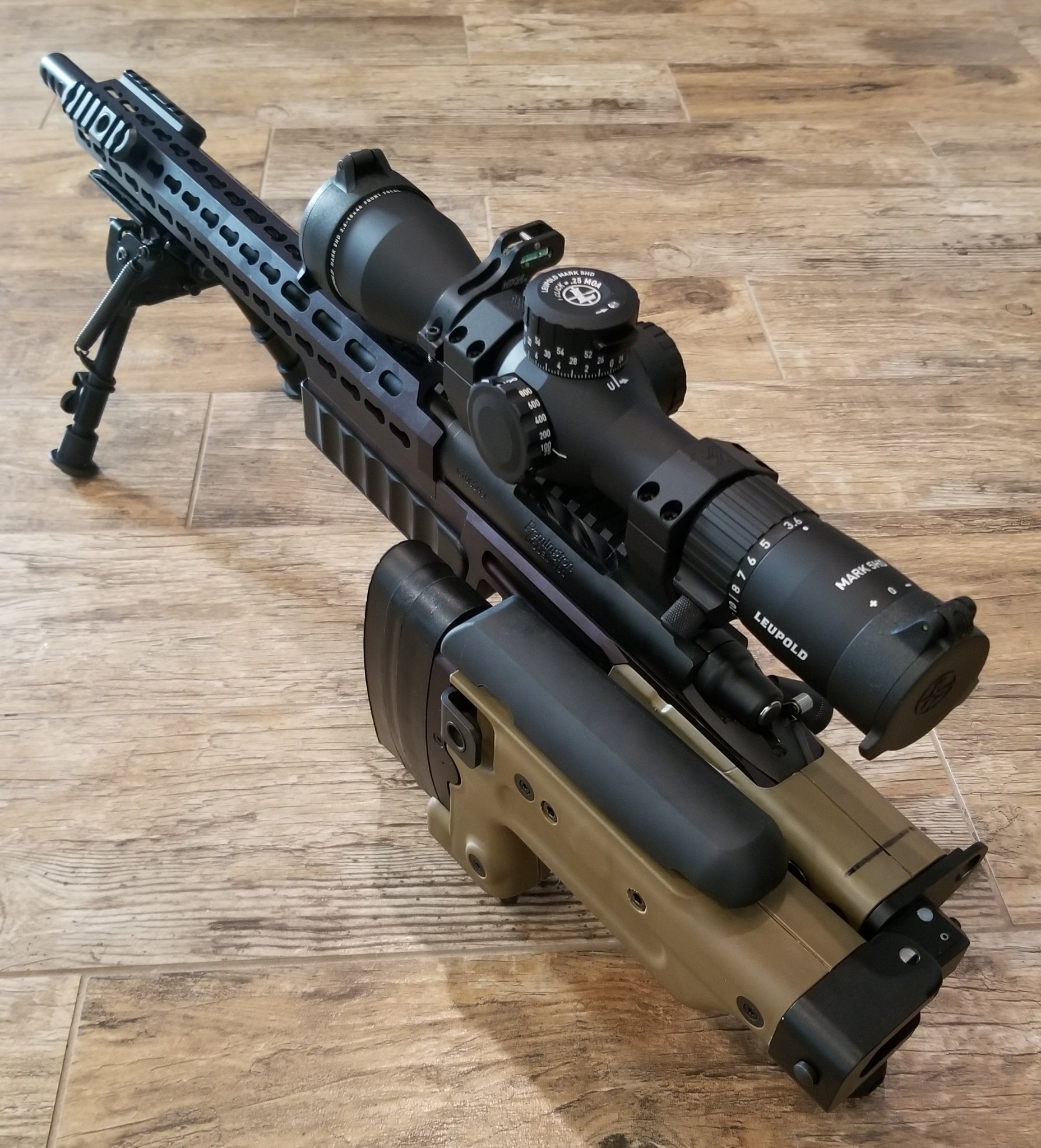

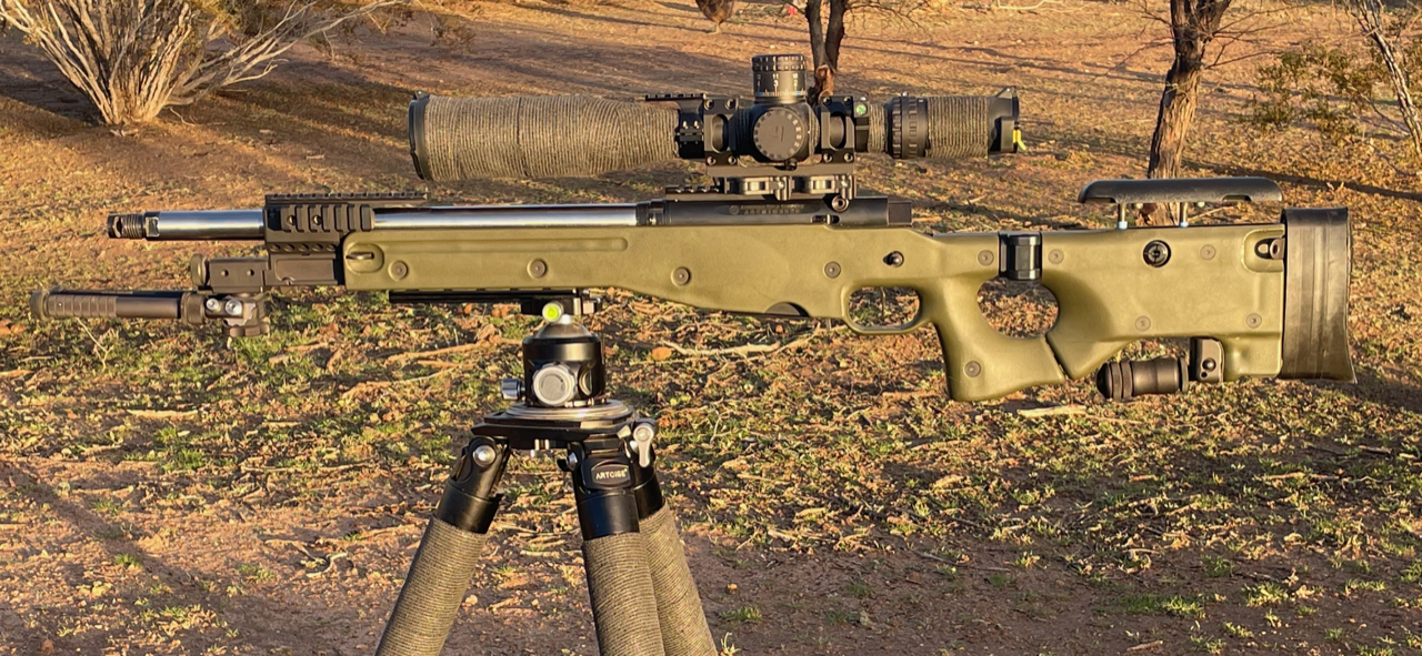

AIAX Chassis
Worked Rem 700 SA
Benchmark 16" Barrel in 260 Rem
Jewel Trigger
Leupold MK5 3.6 - 18
RRS AX Rail
Little guy is 11+ yrs old and on its third barrel but I can't part with it. Just shoots to damn good, its light, short, and easy to throw in the truck.

What scope base is that, and what height are your rings?
