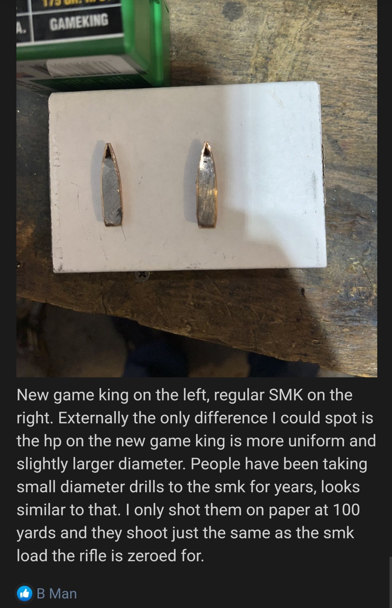

These r what im gonna try out this year.
Whats curious to me is there seems to be no difference.
Saw a cross section and all it showed was s slightly more open tip.
Reactions: Stevo86
Curious - were you drilling the tips?
No and I don’t believe it would make a difference. Berger match bullets and Lapua Scenars are no more open on the tip and they perform great on game.
The HPBT game kings perform better phenomenally.

This is what made me think that 🤷‍♂️
