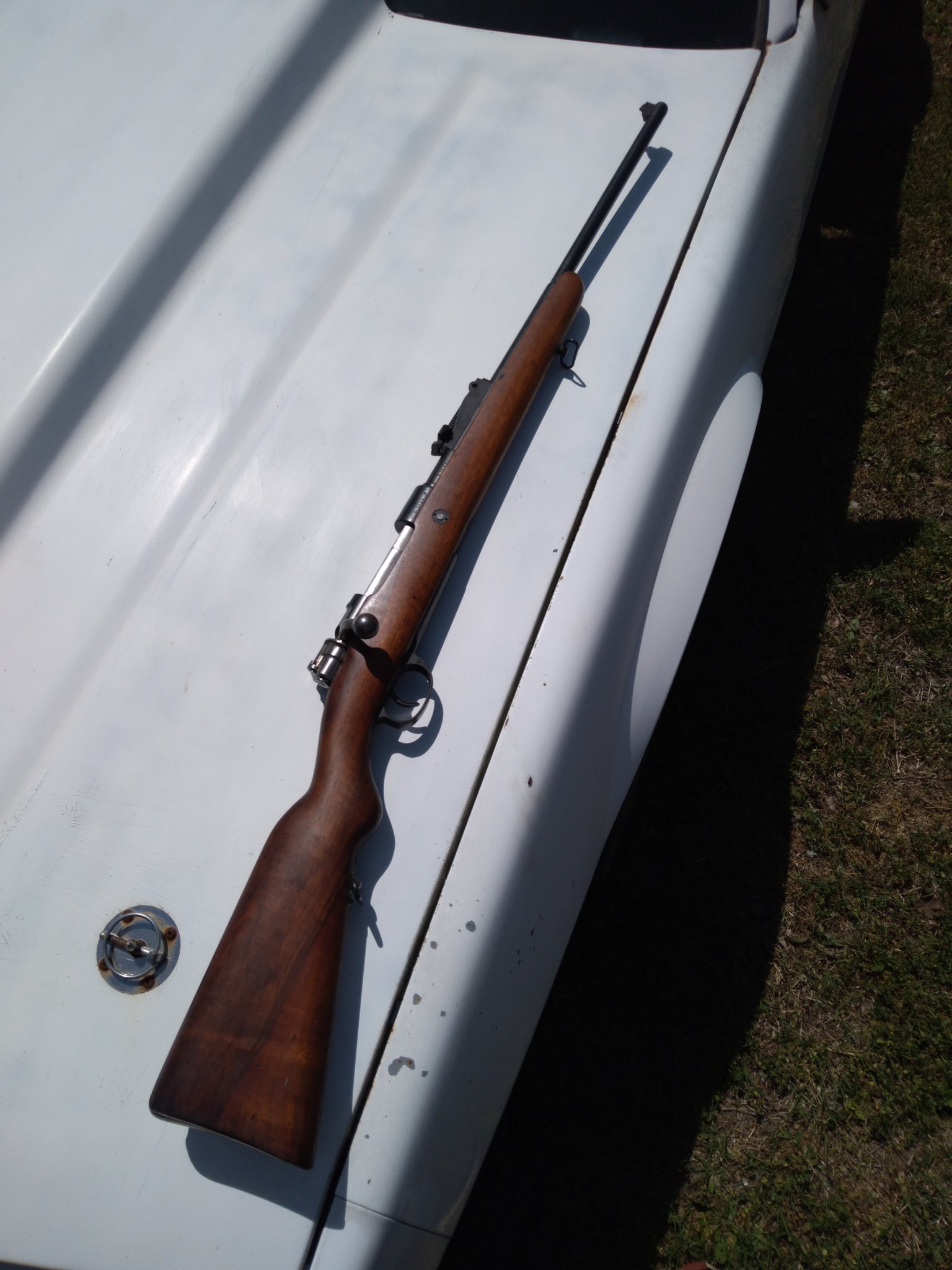

    I recently picked up a sporterized mauser in 30-06 cal. Did some looking and what i found said sears imported and sportered a bunch of these in the 20's. From what ive read they are bullet hoses. The barrel is .311 vs the .308 bullet. What would you guys do with this rifle? Im looking for some ideas, i just bought it for the action basically, but i also worry about destroying historically valuable guns.

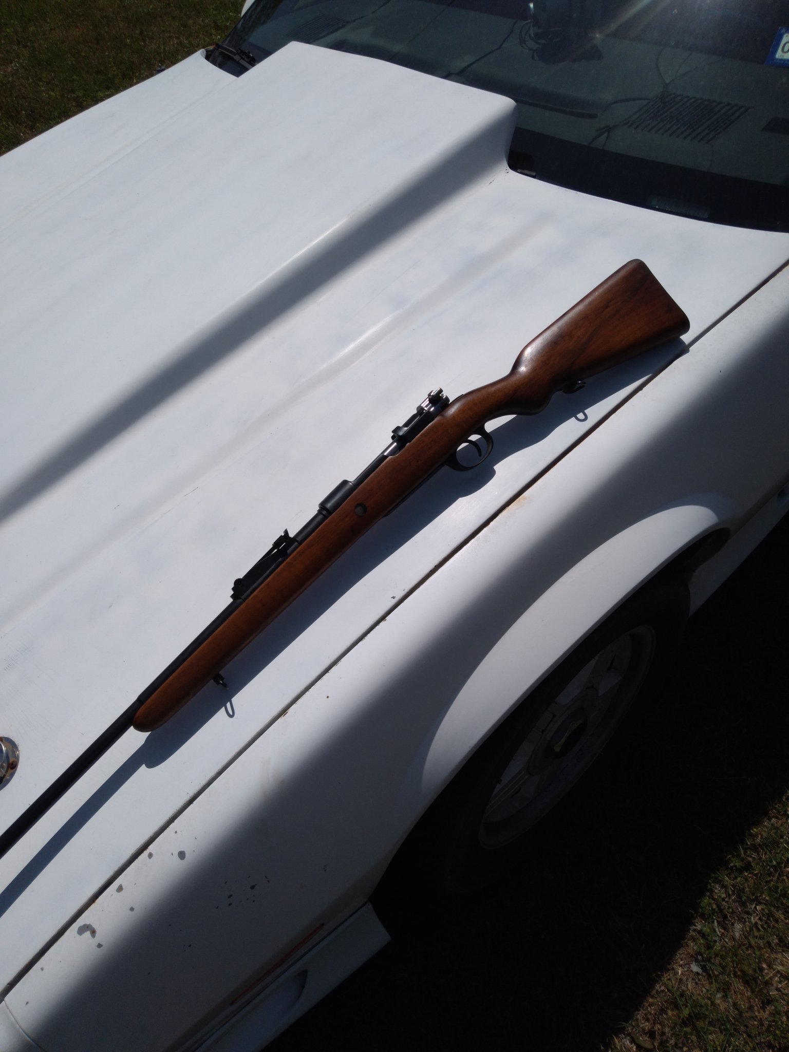

    Got to pick up the mauser today. All numbers matching, und berlin model with unmolested crest. Gonna put a box of 30-06 thru it while i mull over caliber options. Wheather to scope or not, what the stock looks like under cracked varnish ect ect ect. Im excited.

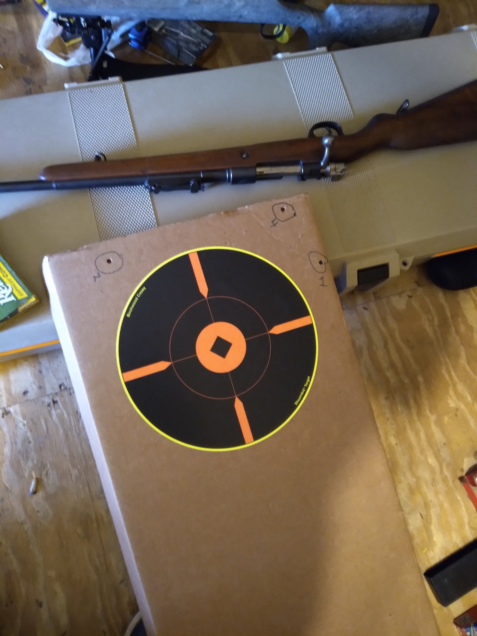

    It grouped about how i expected at 100 yds. Its pretty steady windy today left to right 3/4 value so i was holding on the left center edge of the target. Shoots a little high which i expected, but its a bullet hose. I also dont like how the shoulder looks on the spent rounds, they all have a ring like the one shown. It fed like butter though, i love the action allready, and my shoulder felt something again for the first time in a long time so that was nice.
    That is a bit tough on brass, bub, but maybe shoot the goodie out of the barrel you have now and see how that goes. I would bet it will take a lot of rounds to wear it out.
    30/06 or 25/06 are both good rounds and factory loaded as to your comment that you only buy factory ammo for the brass.

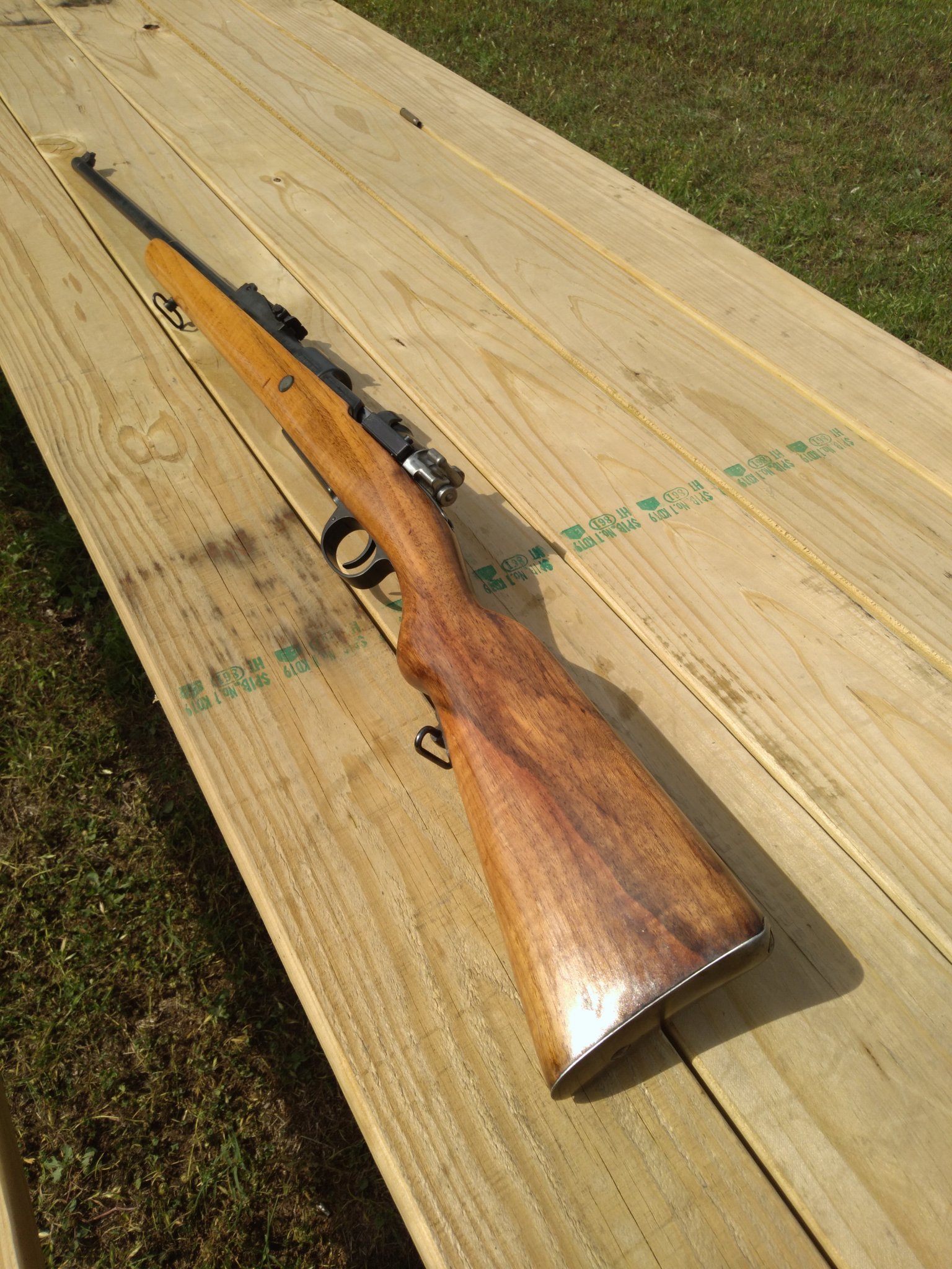

    Underneath the shelac looks like this. Gorgeous. I was looking into the 25-06, i think its gonna be good for what i will use it for, the action is slick... if i like what i put together i may shoot it all the time, most of my rifles get 300 or so rds a year at least thru them.

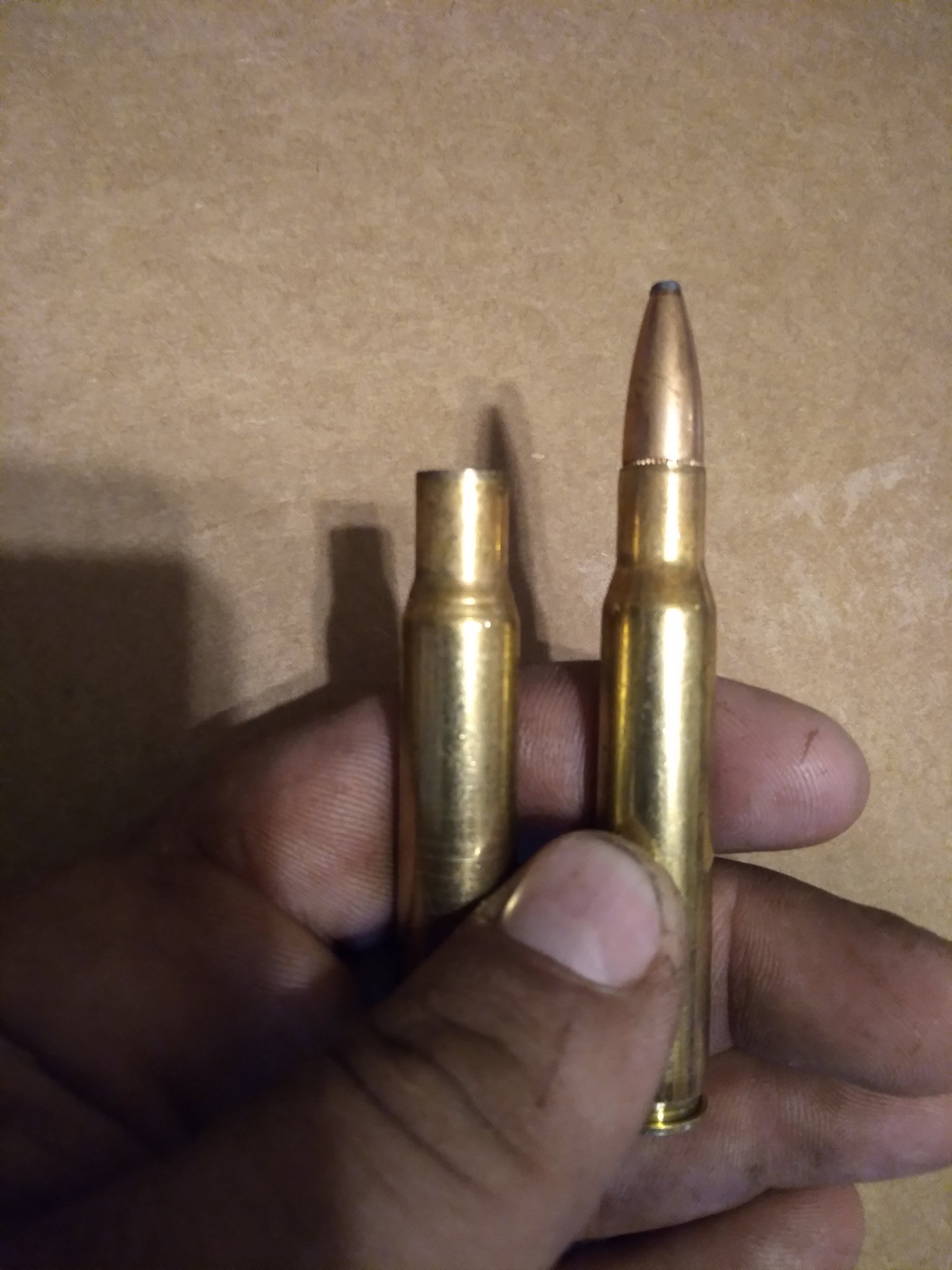

    Do you just resize 30-06 brass down to 6.5? Who makes dies and such for that, cause i am not afraid to wild cat rounds and i have plenty of 140 grain 6.5 projectiles and 30-06 brass, also is that like the 257 roberts?
    I use Redding standard dies, I prefer to neck up 25/06 brass but 30/06 brass is GTG also.
    I use 140gr. Horn. BTHP Match bullets with 47.5 gr. of RL23 and according to my Labradar it has MV of 2975-80.
    48gr, of RL23 runs about 3010.

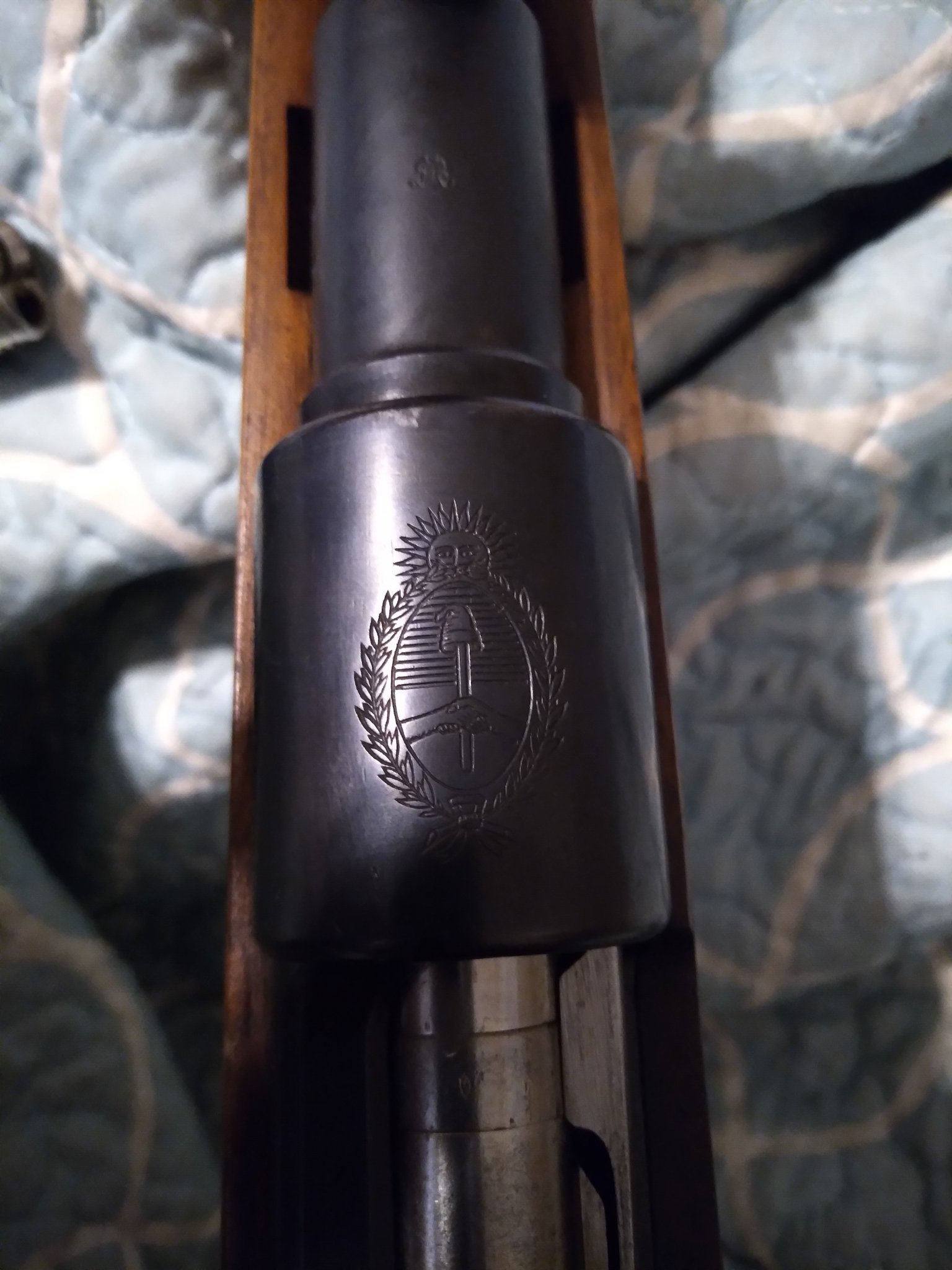

    Recommend you google "Argentine FN Mauser bolt setback. Those actions are beautiful; I've owned a few but the heat treating process wasn't the best back then. Bolts have been known to eventually lock up in the action as the lugs set back into the action over repeated firings

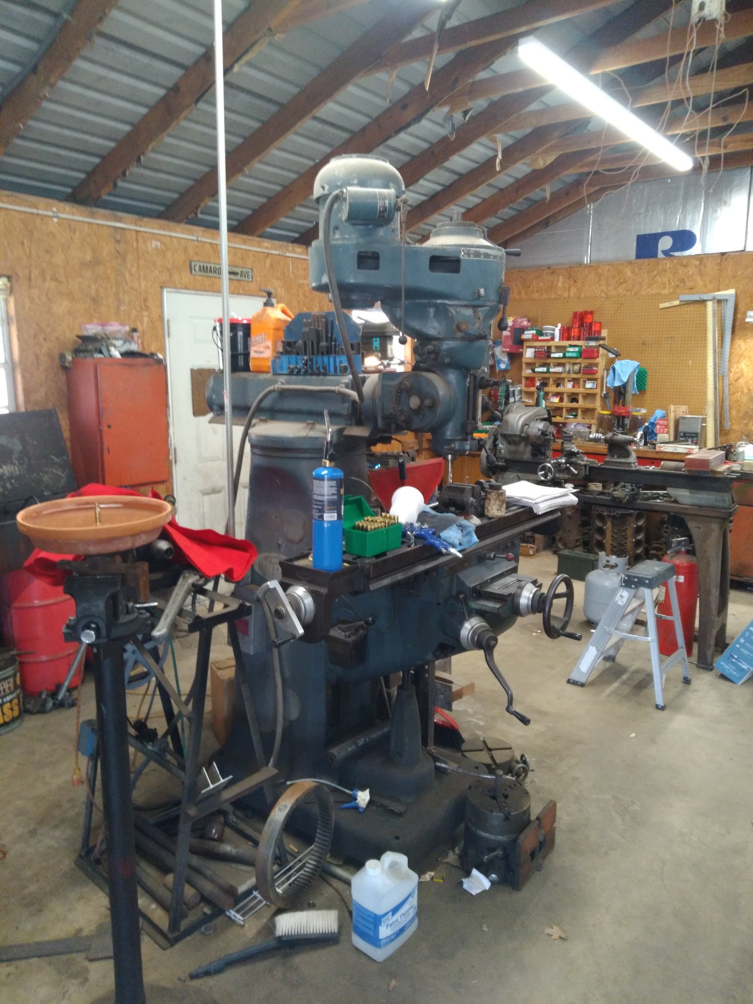

    Maybe my reloading spot will give me a little credit. I can use a mill and lathe, i have a decent understanding about alot this, what i dont know i can easily teach myself... but on this project im going to defer to a real pro.
