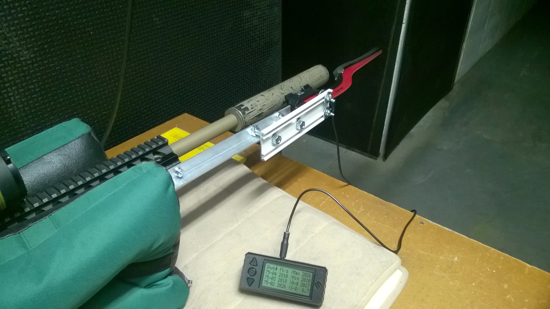

When I'm doing load development, I have my magnetospeed on a home-made adapter on my pic rail, so the bag ends up pretty close to my mag well. I use the Caldwell "tack driver", which is a pretty long bag that offers a lot of support. I know the OP uses the same one, so while I don't think that's part of it, it would be interesting to test using a loaded bipod instead.

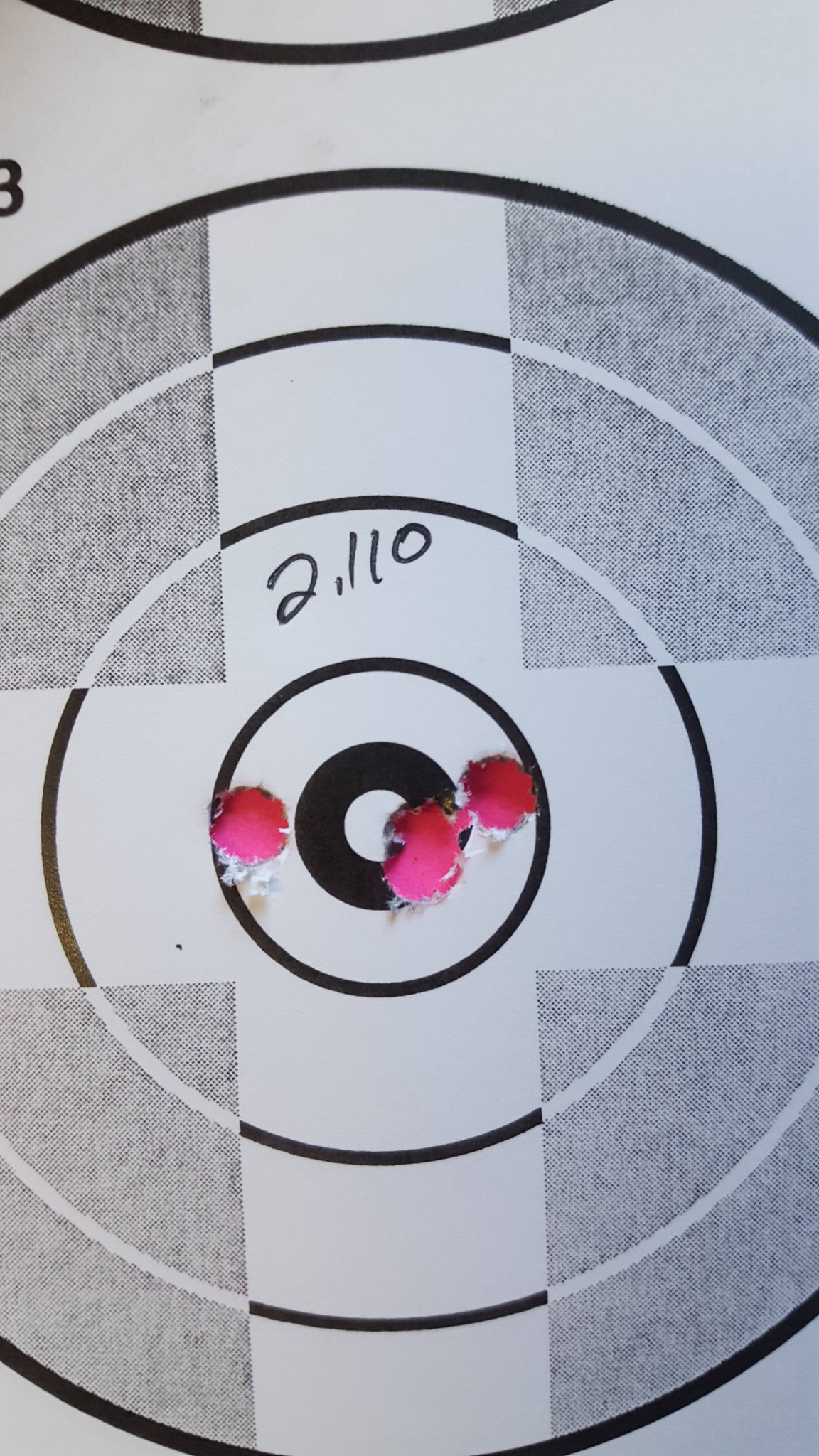

This is an example of my crimped groups. Shots 1 and 2 are the ones in the same hole. While not a stellar group, it has been confirmed multiple times now. I was having other problems with this rifle today that are worthy of a whole new thread so I was shooting very pissed off and it was cold as shit out. Also, shot the old 260Rem with the JP barrel. It shot well for a burnt out barrel. I’m glad to know this first round flyer shit isn’t caused by something going on between my ears.

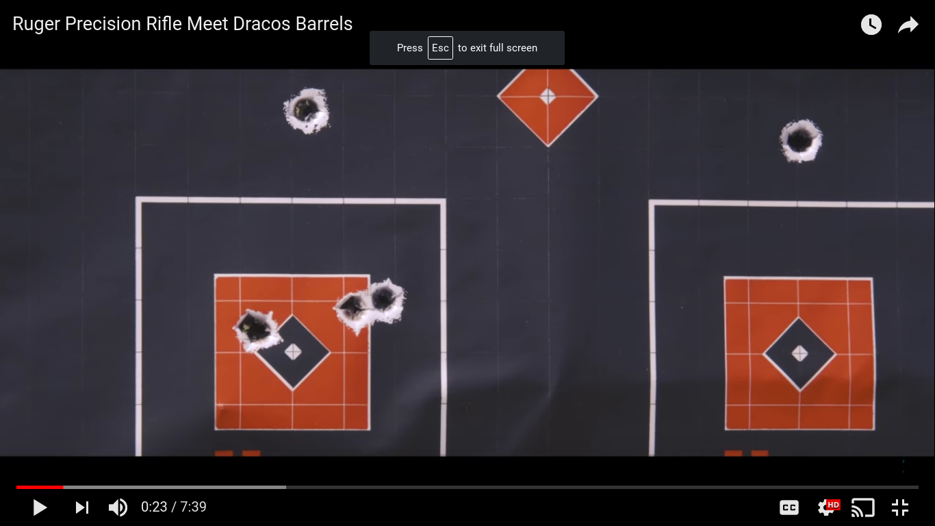

That video has been out for a while. Yet they still don’t offer a barrel for any bolt gun. Maybe their R&D isn’t going so well. When I originally bought the Dracos barrel, their website said bolt barrels would be available 1st quarter of 2018.
