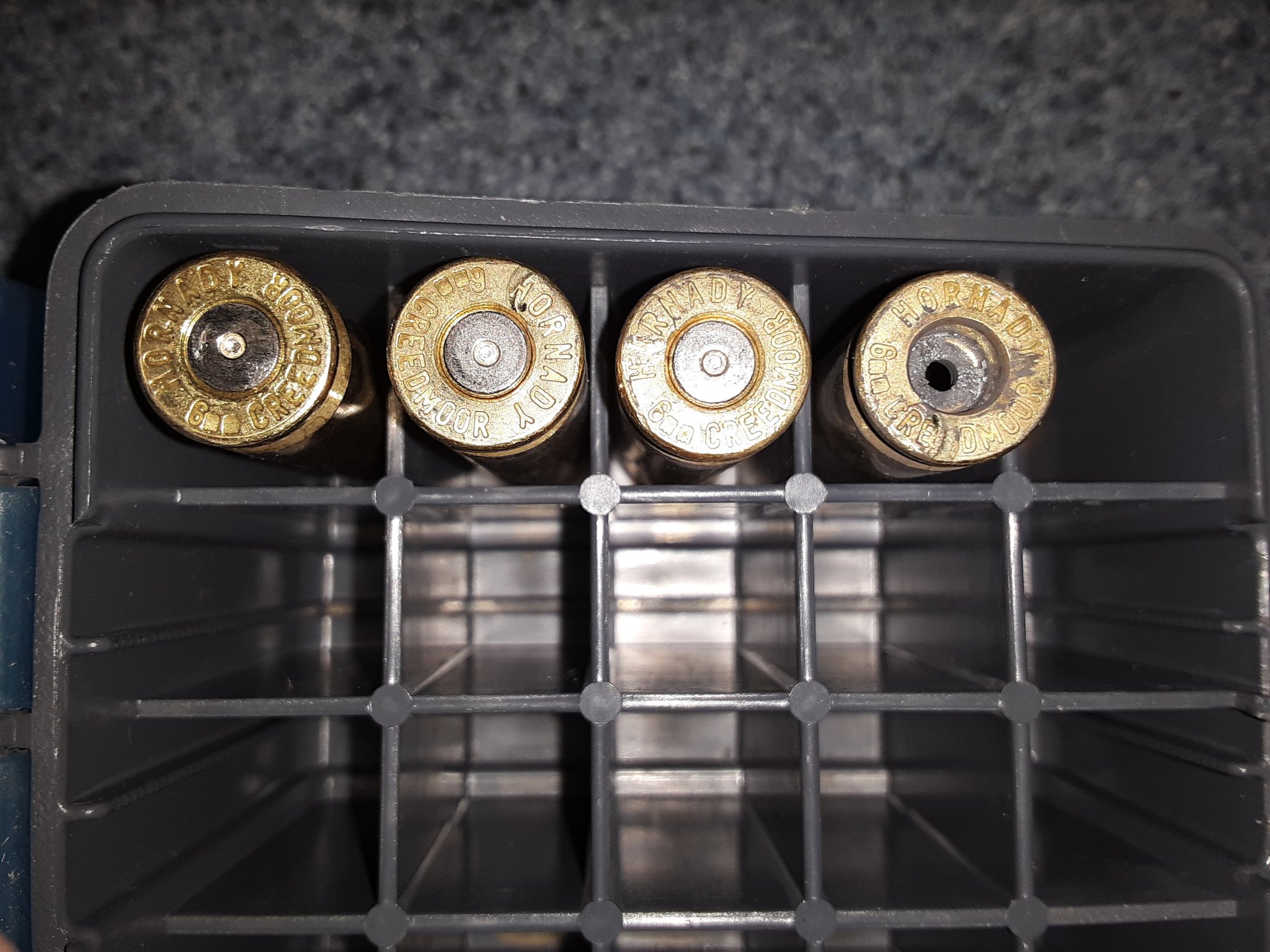

And to touch back on the brass issue I was having with the Hornaday factory 103s... I got a new box, and it wasn't quite as bad this time, but there's still an issue.
Check this out, the cases are ordered in the sequence I fired them, left to right.
7040335
The first round has hardly a mark on it, while the rest have pretty bad swipes, and #4 blew the primer. Velocity of all 4 rounds showed negligible variation.
I think those factory 103s are loaded a bit hot. I was getting ~3020 with a 22" barrel. But... why is the first round fine?
This brass problem was much worse shooting suppressed, even though I had my gas adjusted for proper ejection.
