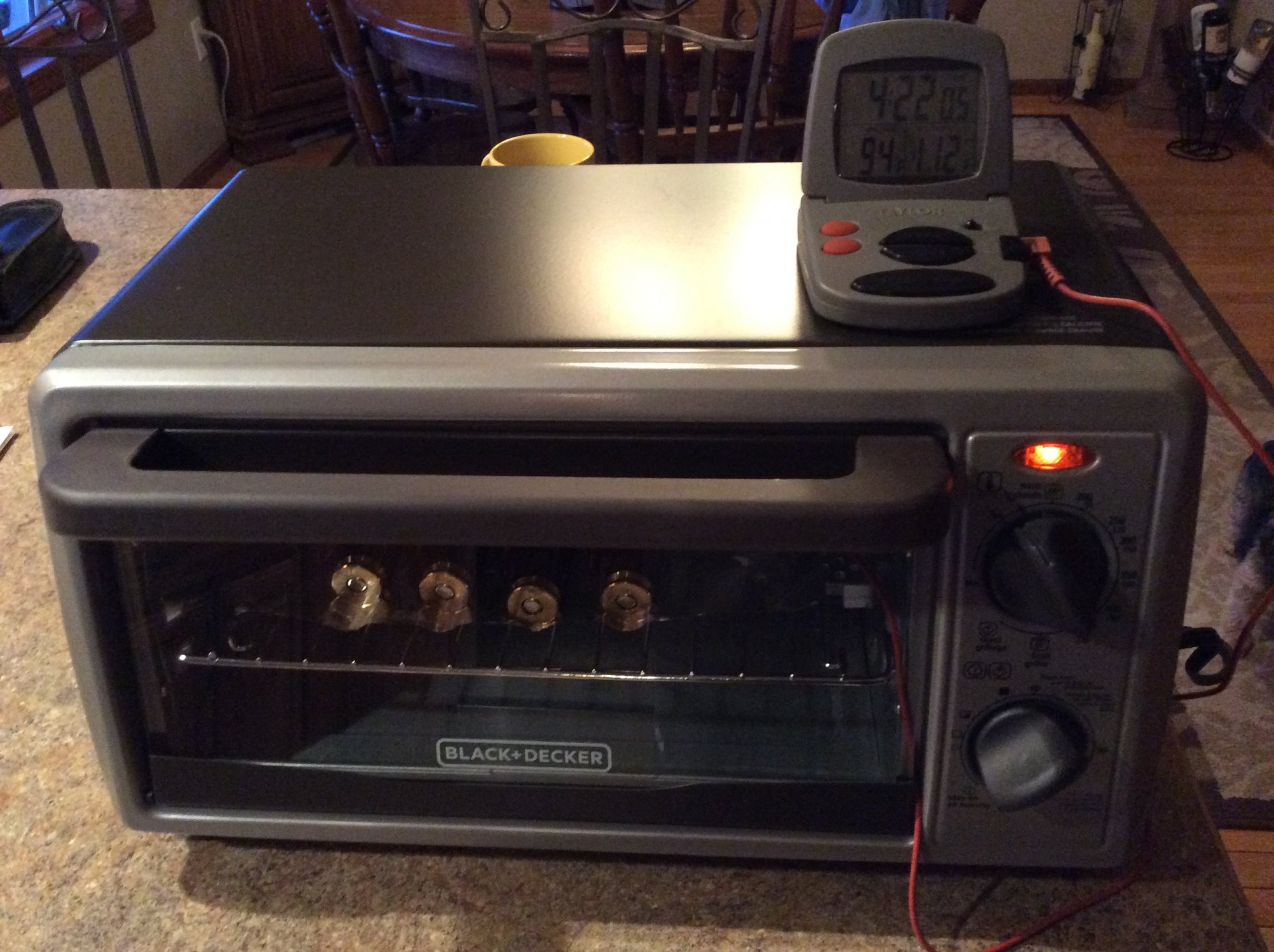

198 grains of H50BMG per round and I wanted it to be 100% of a hot day on the range for finalizing load development so we can run cool and have no pressure issues or stress to brass to fight with. So far the 400s are running up to 3480 fps with no signs of a sticky bolt or primers going south. I have a sweet spot tack driver at 3450 fps and might stay with it . It would still be intresting to see how far we could go to see signs of pressure. Theres a lot of powder in a fat case and I just wanted true feed back with less money and time wasted.

I recall from Hatcher’s notebook, which is excellent reference material, that in proving ground tests for temp variations, many factors were unaccounted for. Other factors were discovered only after tests showed counterintuitive results. Alaskan cold weather m2 ball ammo tests were skewed by soldiers going indoors to warm up next to a hot cast iron wood stove. Of course the ammo absorbed lots of heat. Other experiments more germane to your experiment were tests done to demonstrate how quickly brass absorbs and sheds heat energy. Consider any centerfire cartridge case. Fired from a bolt rifle, a fired casing from even the fastest bolt operation is warm to the touch, though easily handled. A case fired from an automatic system results in a case that is easily hot enough to burn.
To be an accurate test, I’d consider keeping time from opening the oven to firing next to nonexistent.
Of course I don’t presume you are ignorant of this. I just mention it so that I may enhance the validity of your test.
Maybe a heat gun on the chamber... there are a few ways to mitigate the drop in heat but some is better than none. A big case like that I would think would take a bigger swing in temp to make a noteable difference than something like a 6br.
