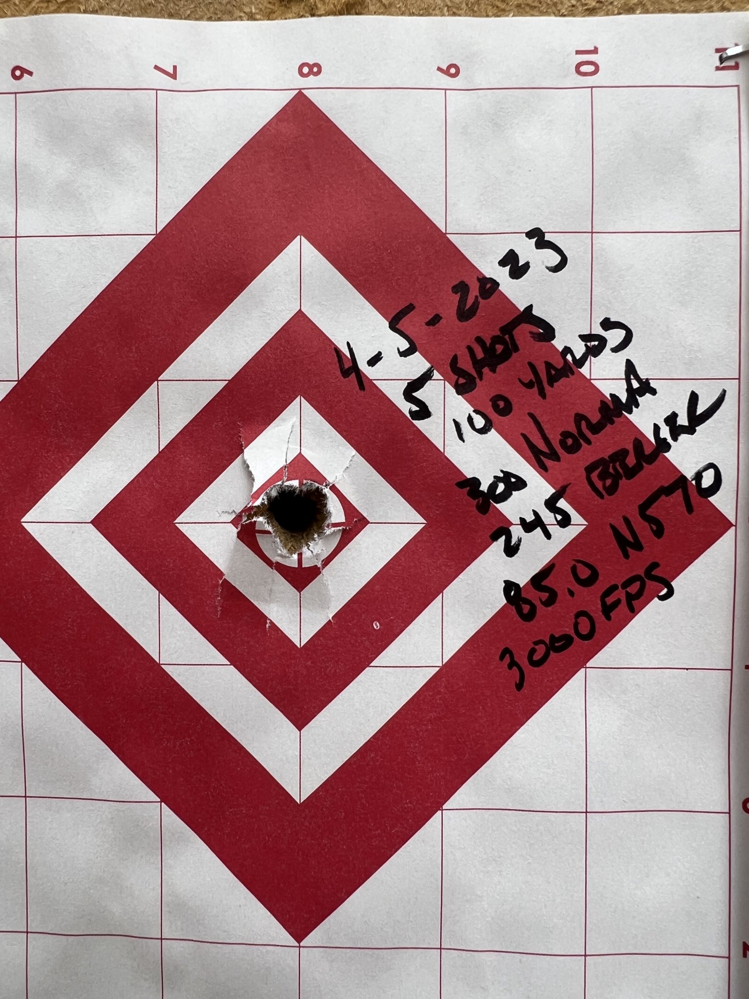

This is what I posted to the 300 Norma thread:
245 LRHT
Lapua Brass
CCI 250
87.5 gr N570
0.020 off lands
3060 avg fps
No pressure issues, was faster than I expected. Best ES was 12 and SD 6.3 with a 5 shot group. .38 moa.

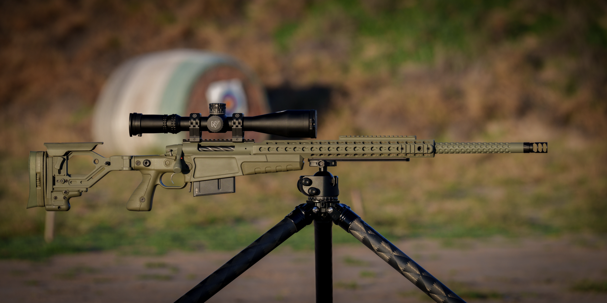

Looks like we'll be making ammo for four 300nm for NF ELR this year. Three rifles for our own guys shooting and one for a customer. Customer rig in pic. Turned out pretty nice looking.
Looking like VV N570 and Berger 245 LRHT

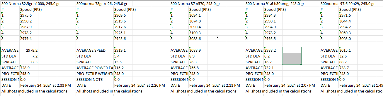

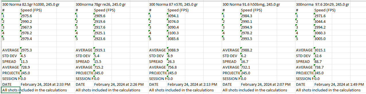

Went out and did some testing today with 245's for the match everything loaded to 3.68in with federal gold medal match magnum primers in lapua brass. Here are the results, and garmin makes it crazy easy to track your data and log stuff.
