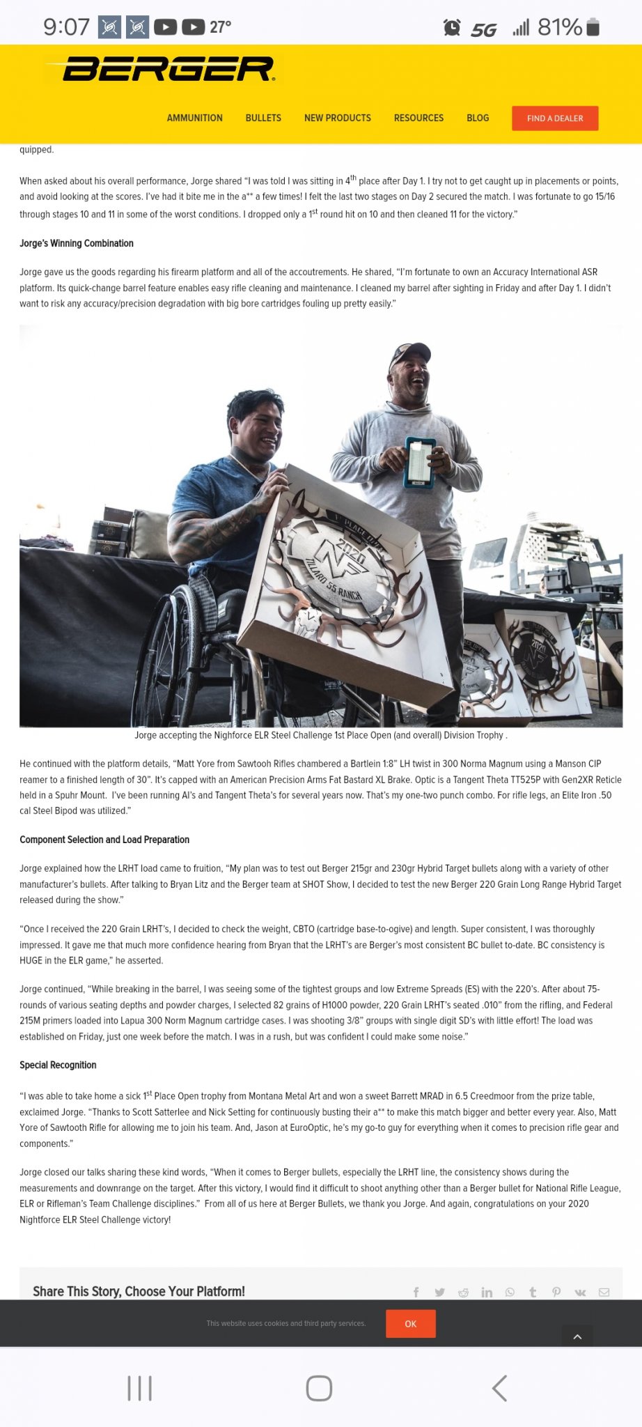

I remember seeing the articles when Ortiz won a few years ago he ran 300 norma berger 220 30 inch barrel at 2980.
When litz won 300 norma berger 245 2875 I can't remember 28 or 30 inch barrel.
So maybe those are the correct speeds
Aren’t they shooting 26 inch MRAD’s?
Here one there more

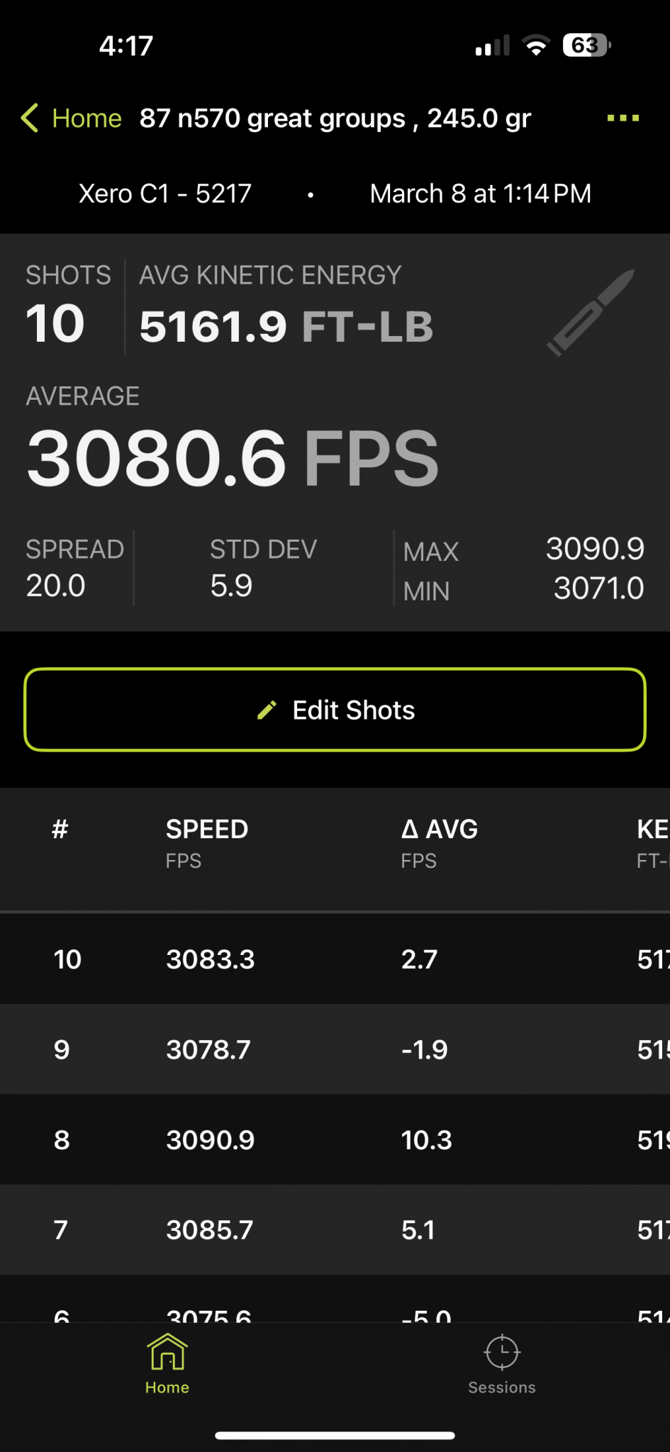

Pushing a 245 at ~3080 fps with 78 grains of powder would be something.
I'm pushing the 220's at a bit over 3000 fps with 85 grains of N570.
I'm waiting for my rifle to come back had some issues but my plan is to run the 220s at 3077 in 30 inch barrel n565 but mine is the improved 35

I know 5 300 Norma's and they all shoot 85gr of N570 behind 245. 3 of the rifles were tuned by one guy so I see he settled on one charge but the other 2 guys ended up on that load independently. The rifles are all nearly identical.
Reactions: kthomas
The 85.0 grains of N570 behind a 220 seems to be a really solid load, from my limited time with it. Don't have any experience with the 245's (yet).
Reactions: Taylorbok
Loaded 100rnds for a customer over the weekend. 85.0 N570 with 245 elite hunter. 10 shots 2877 avg and 4.8sd. .75moa with customer shooting it with not the best fundamentals. Loaded them mag length and bolt falls free with gravity. Not sure how far off lands.

Just tested some berger 245 lrht. Those things shoot lights out just like the 220s. The recoil is noticeable with supressor might be switching to brake for those. 5 shots sd 4 es 7 avg 2863 slow but a great combo with the n565. Started low working my way up. I loaded them roughly 30 off. This is a different barrel than what I've been shooting the 220s. I might sell all my 220s and go to the 245s strictly.

Going to test tomorrow morning at distance to make sure load holds up and true my kestrel up. The load has settle on berger 245 2877 avg sd 5.9. Shooting suppressed if I don't like the recoil or miss my spotting myself I'm going to switch to my brake but want to give supressor a chance.
