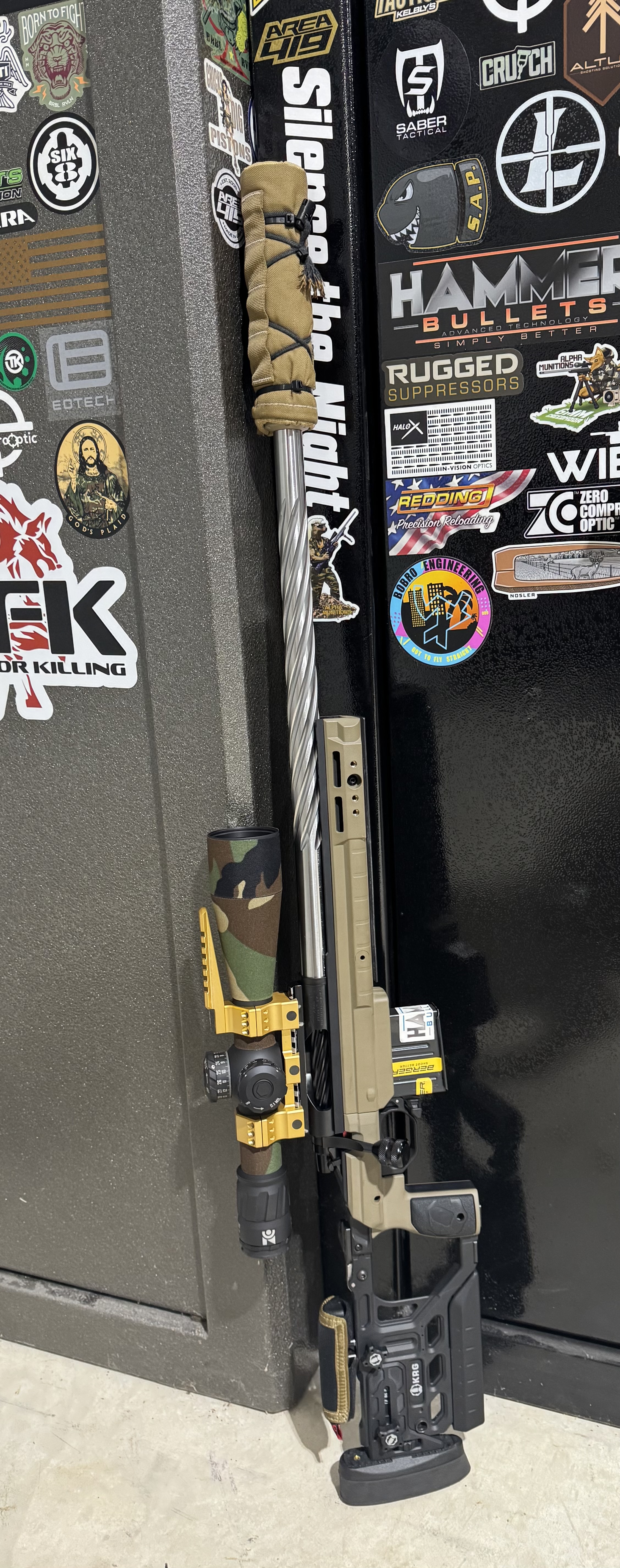

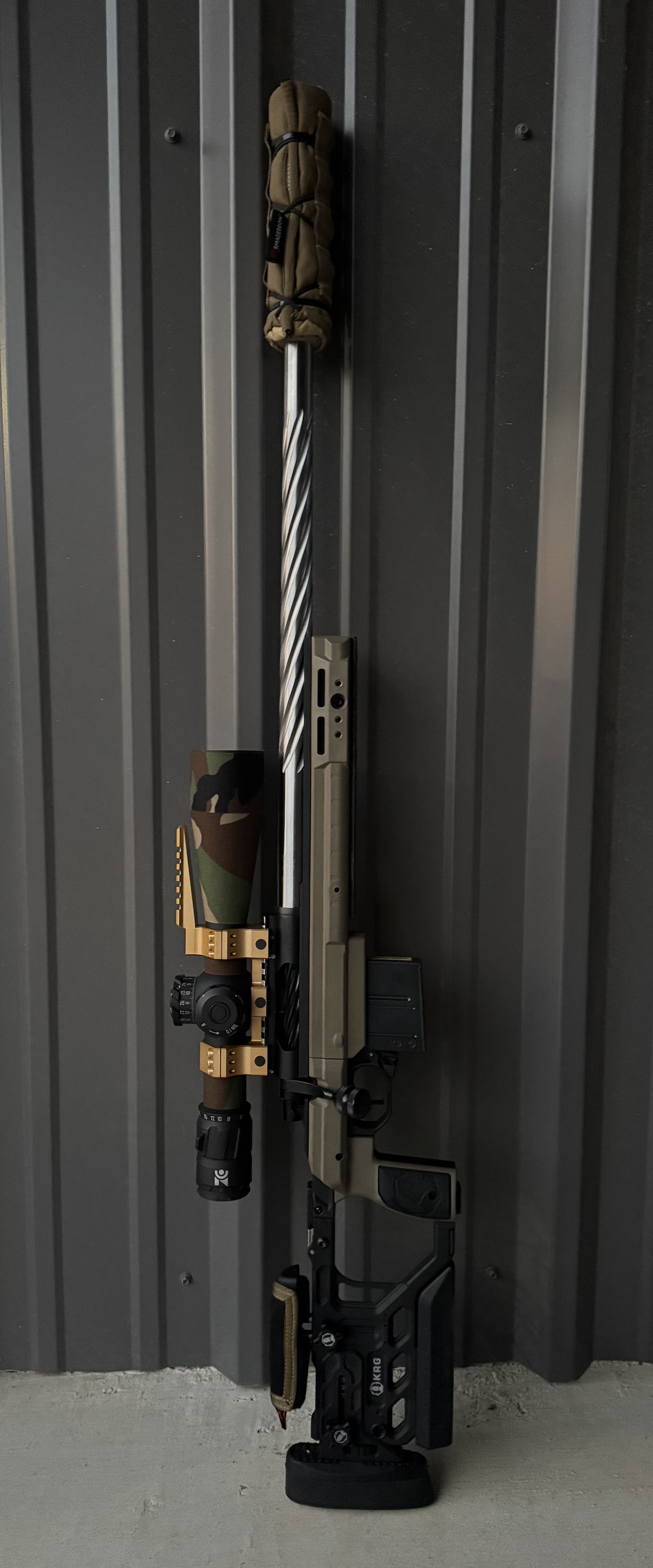

Well I have started on another wildcat adventure for this next fall/winter varmit season. Always wanted a fast as fuck 20cal so here we are! Like the GT family so figured it would work well. Sending a round off to JGS for the reamer and buying bits and pieces for now. Build components listed below. Overall I’m hoping for 3800-3900fps out of the 20” with great accuracy of course. The Berger 55gr is an impressive little bullet on paper. I’ll keep yall updated once load development starts.
-Kelby Atlas Action
-Muller 1-8t M24 Barrel
-Trigger tech Diamond
-KRG Whiskey 3 Chassis
